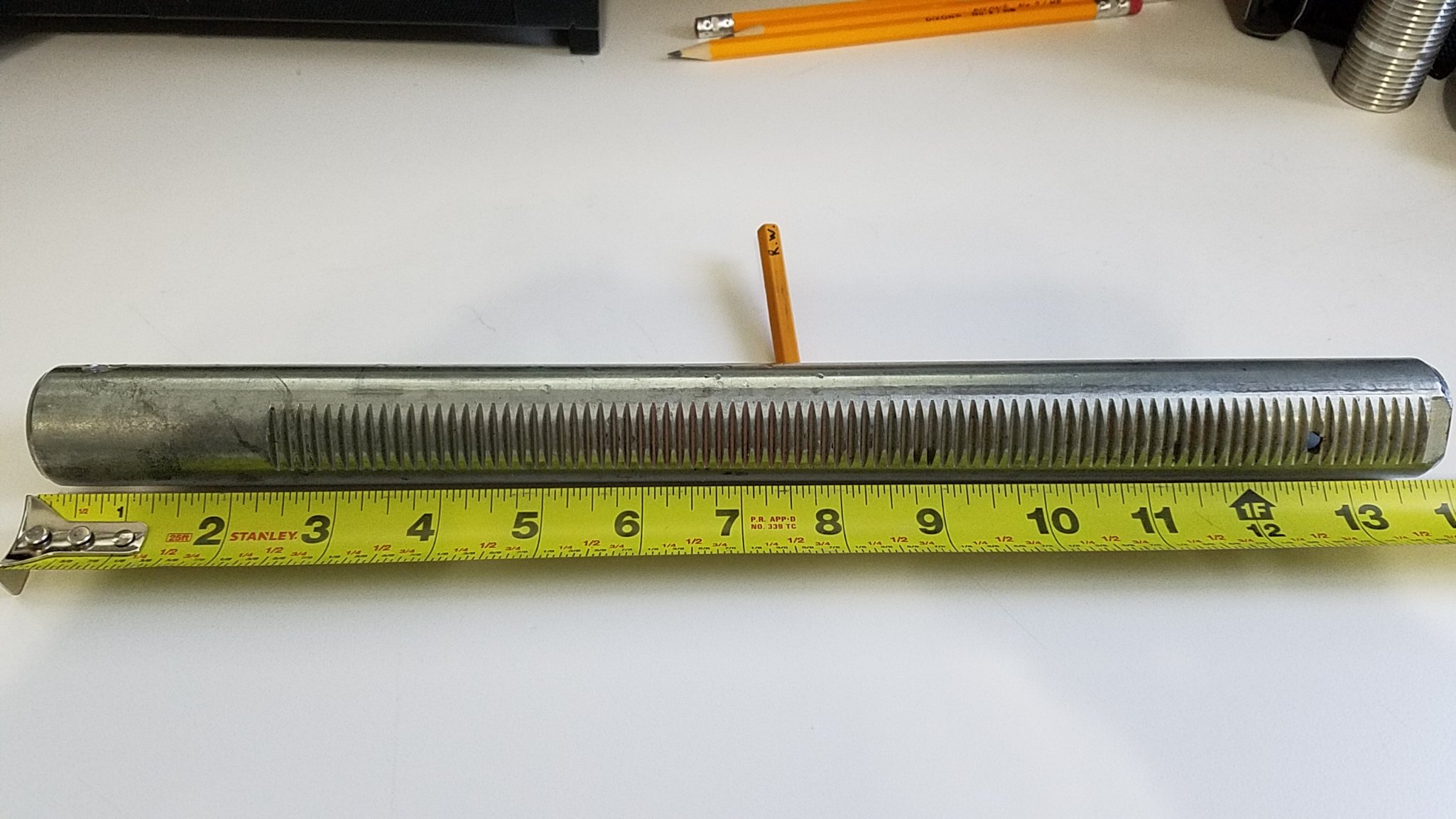

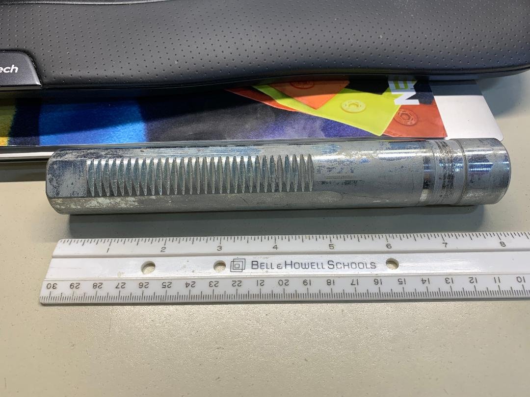

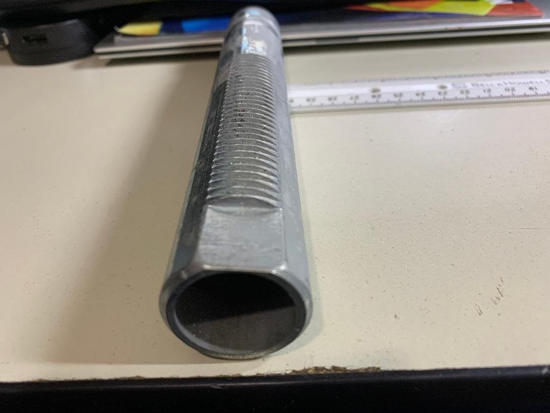

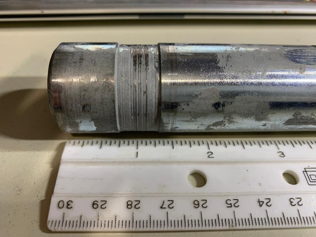

Here are a few pictures:
Re: Issue with tool rest
I would not want to guess how many versions of this part there have been in the 60+ years the system has been in production. Two minimum, but probably more. IMO, the rack type is better than the spiral type because 1) it locks to the carriage better, and 2) if it is not locked solidly to the carriage it won't turn very far. I measured one at 8". That is a bit longer than the spiral type I have, and which I can't measure because that design is integrated with the tool rest arm and not easily separated. If I had the equipment and was making my own, I would make it the length of a main table leg because I'd find other uses for it. (And as you point out, too long is not an issue.)
I didn't understand the countersink reference but I agree you should not use an extension table leg for this. They do not have the wall thickness for the rack.
Ed beat me with the pics but confirms the 8" measurement. I'd still go 14 or 15". I have a few extra main table legs around and find uses for them regularly.
