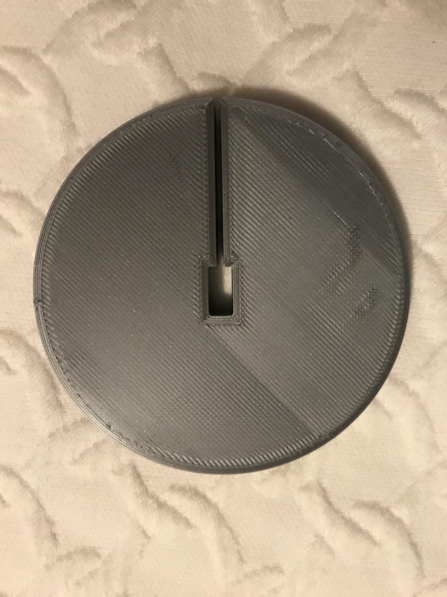

OMG... I am soooo sorry guys... I kind of fell off the face of the earth for a while and haven't been in the forum for months. I didn't realize this post was getting any traction. bgeagle, jjrausc... I have waited all winter for it to warm up enough to check that the gaskets I cut fit well and they don't... I still have some work that needs to be done to get a better fit. Sorry... For now I would say go with what JPG and chapmanruss says. But make a sample gasket first and check for fit. I used the above image as well to create mine and the holes don't line up. bgeagle. I have the stl files for those inserts if you wanted to try to print them at your library. Just say the word and I'll email them to you.
