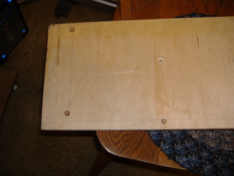

Hi,
I have mine mounted on plywood as can be seen below. I also have dowels to locate it on the table where I want it. The dowels are just a tight fit so if I want to change from the normal position I can just tap them flush on the bottom side and be free to position anywhere.
[ATTACH]3007[/ATTACH]
[ATTACH]3008[/ATTACH]
I should also point out that I no longer use this jig since I got the one that works with the strip sander (which in my mind is a much better system except for the cost).

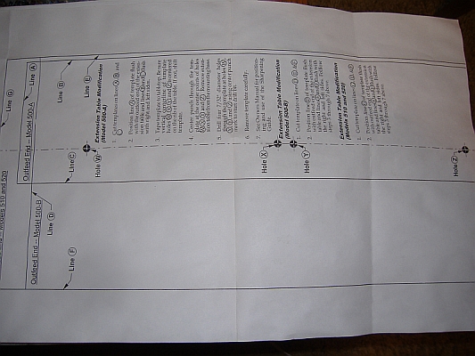

Yes a drilling template is provided. You tape it to the table top, center-punch at the locations specified and drill the mounting holes.
The holes do not need to be tapped. The kit contains the hardware to use the knobs with simple smooth-bore holes.

Hi,
I think we are talking about the sheet of paper that comes with the guide, and the hardware that comes with the guide.
The paper should look something like this (this is only for identification):
[ATTACH]3009[/ATTACH]
