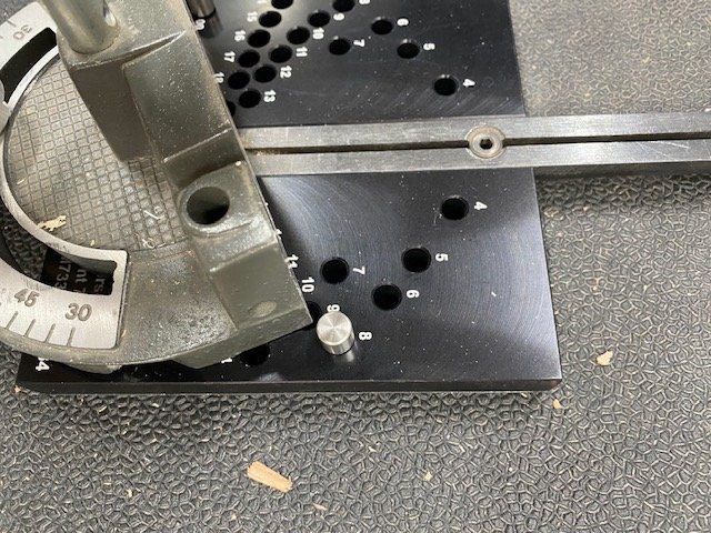

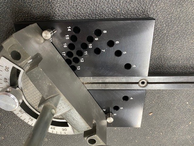

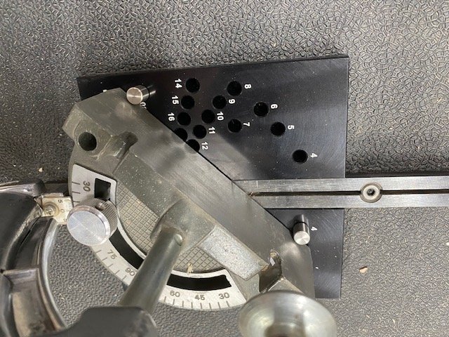

I don't see the problem either. I have both MiterSets and they are well designed & built. The segmented one I haven't used myself yet. I have a wood auxiliary fence on my Shopsmith miter gauge but took it off for this test. I have no problems with the 4 position, but 6 does start to get awkward but should work. At the 8 position the Shopsmith miter gauge won't reach without a fence extension on the miter gauge. However if the Shopsmith miter bar doesn't fit snugly in the miter set then you have the wrong version. I believe I ordered my Shopsmith version of the MiterSet directly from the MiterSet company, but it is possible I got it from Shopsmith...can't remember. By the way, in my pics it looks like there could be a gap between the miter bar and the side of the MiterSet but this is an optical illusion. It is just the small chamfer on the edge of the miter slot for the MiterSet. The Shopsmith miter bar fits pretty snug with only a small amount of play in it.
