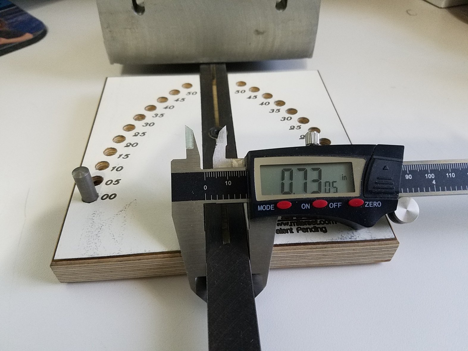

I'm not going to attempt to explain. I just know my MiterSet does what I expect of it. What ever the incorrect numbers are, here are some of my measurements.
The MiterSet works well and there is no wiggle room for the Shopsmith miter bar.
- 20210225_103227.jpg (273.5 KiB) Viewed 1487 times

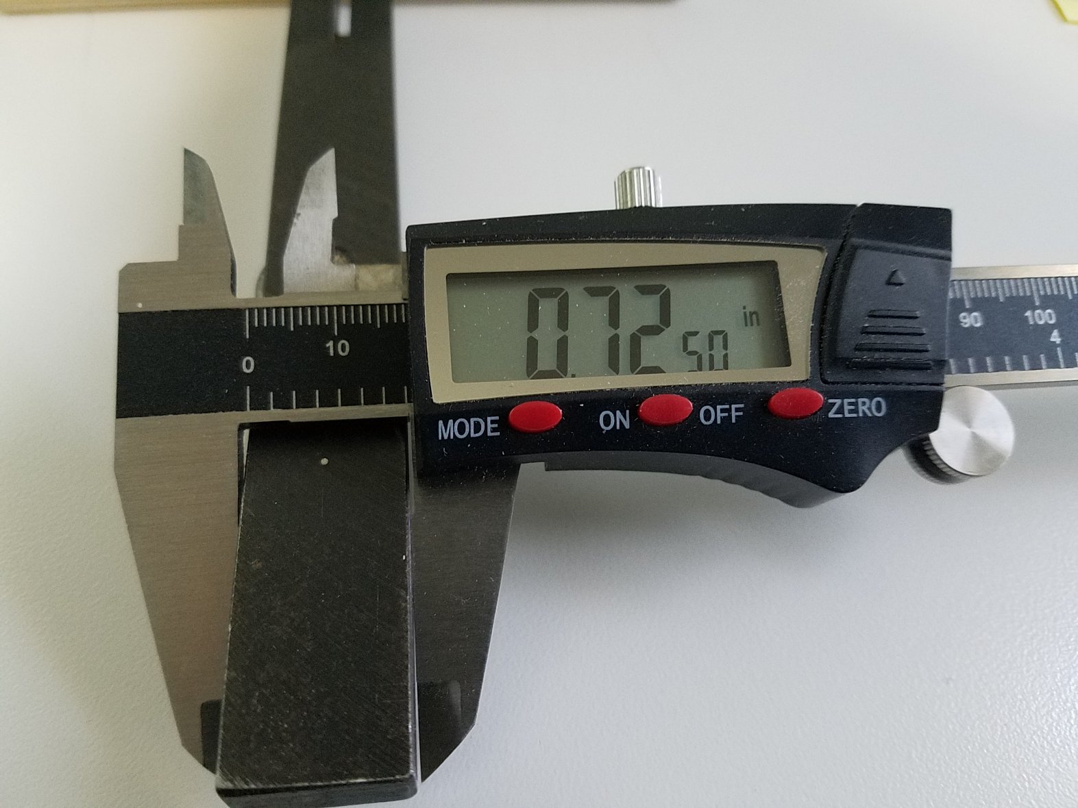

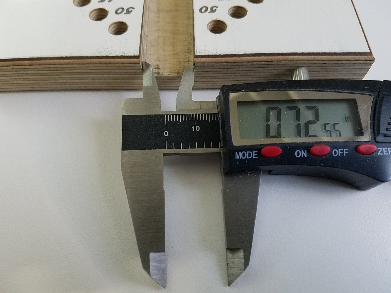

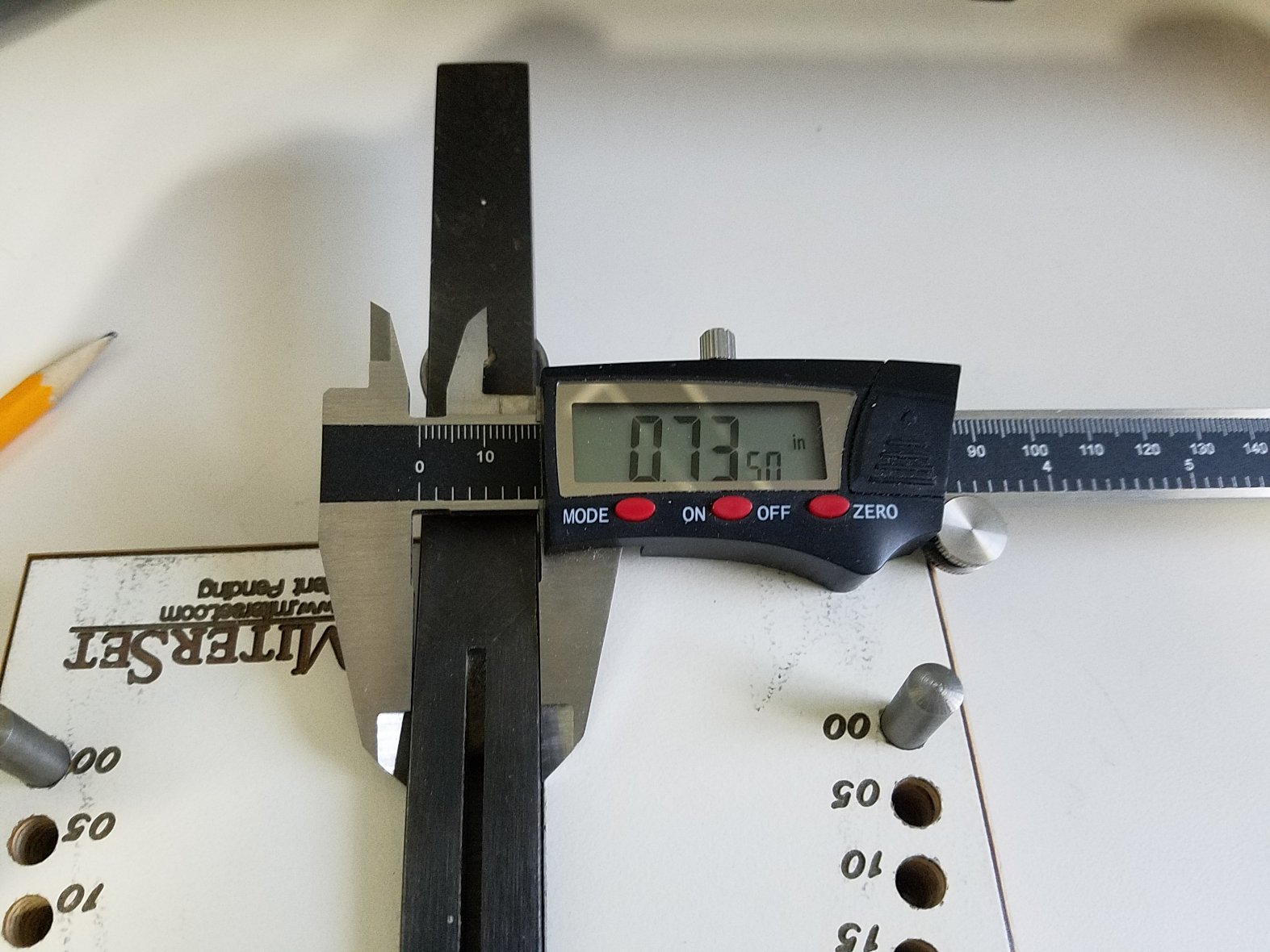

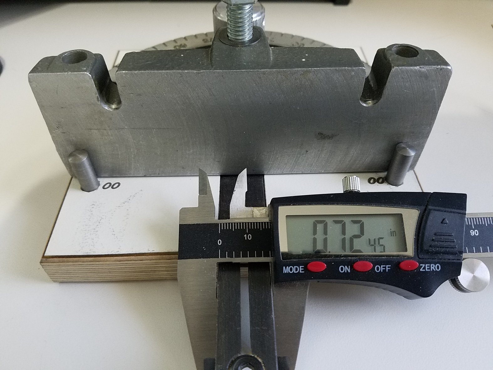

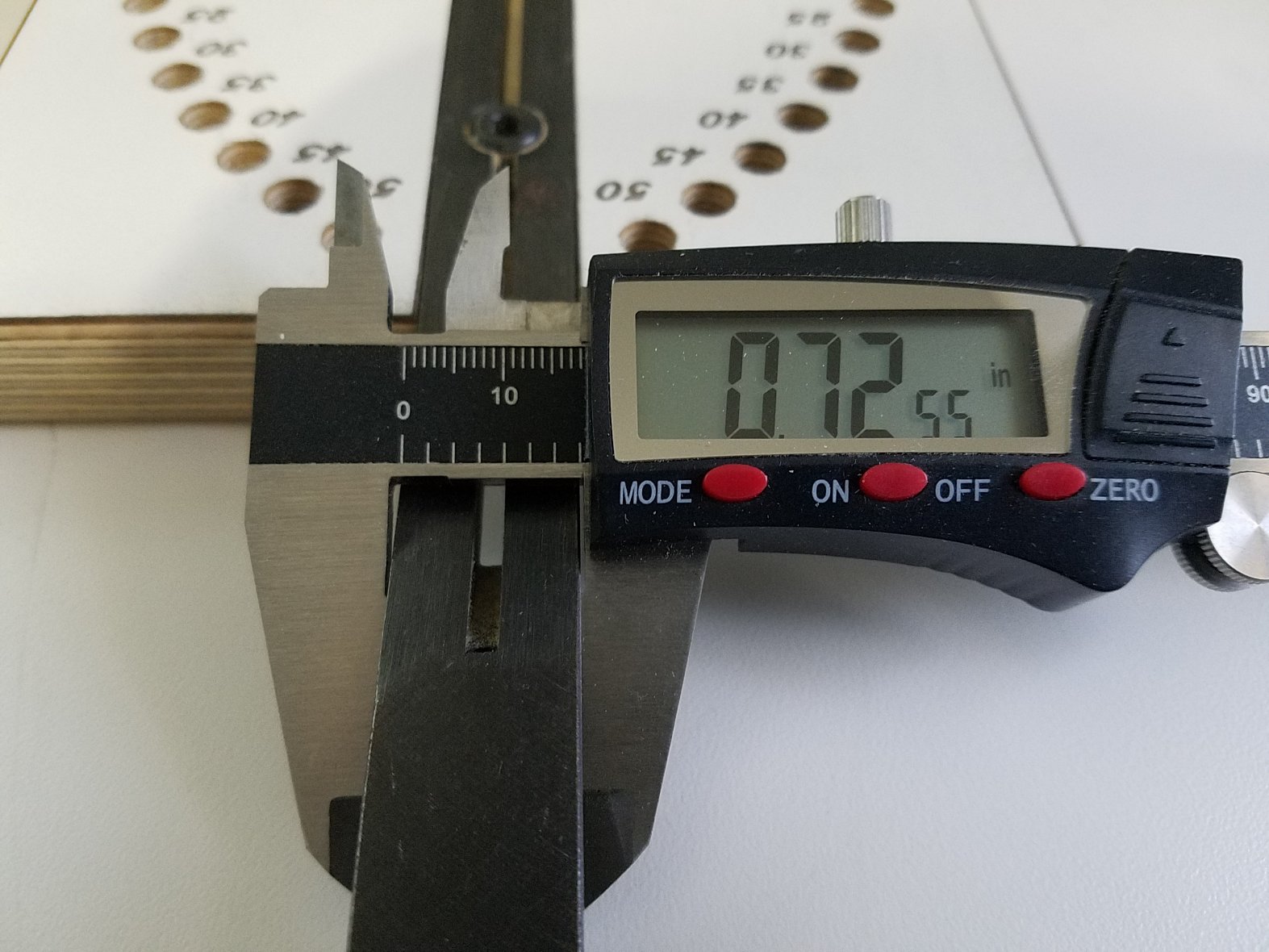

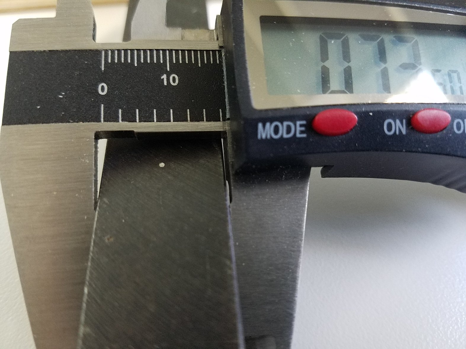

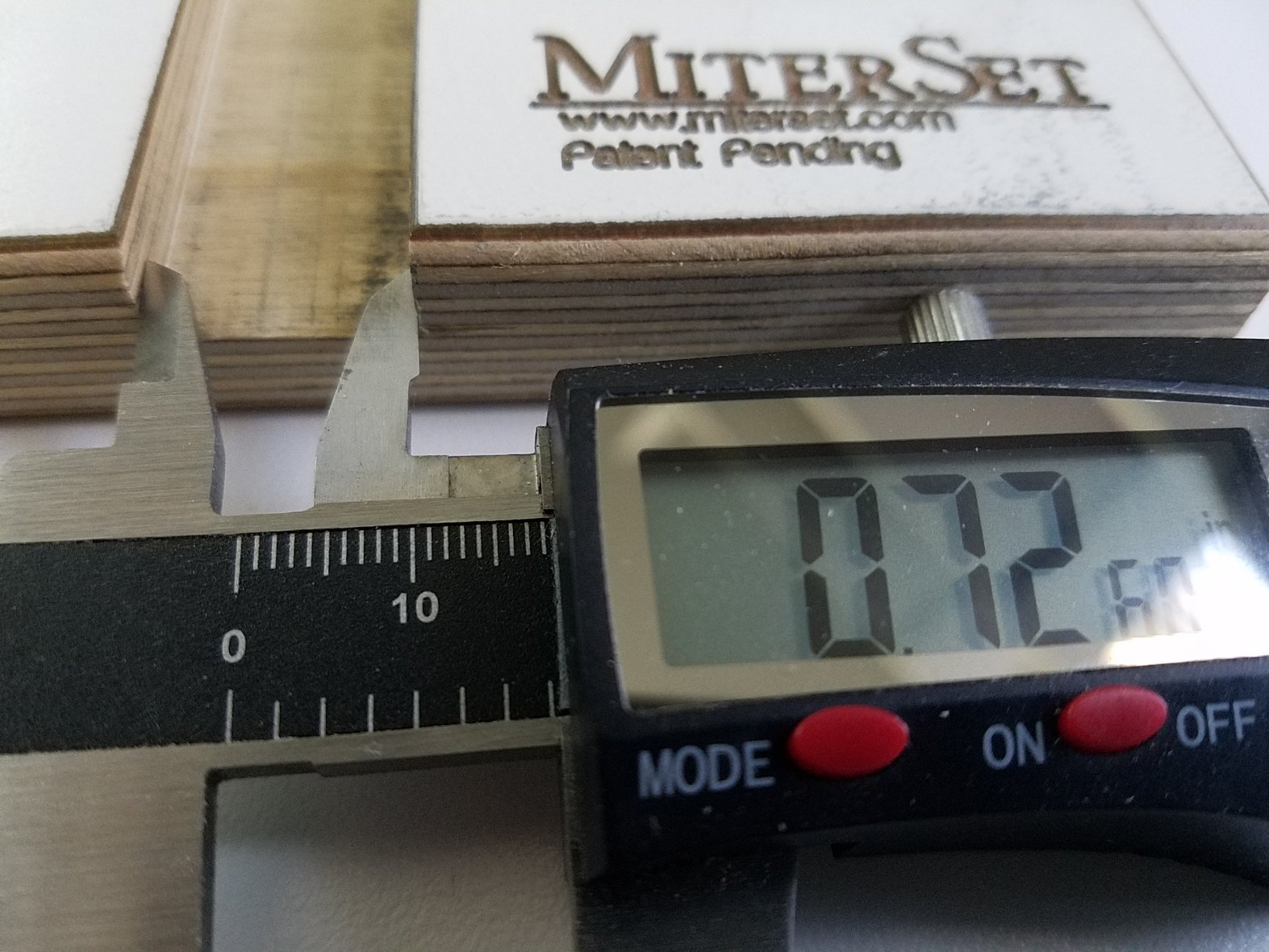

Dusty,
Only thing I can think of is there "might" be an issue with inside versus outside measurements with your calipers. On the surface, that is the only thing different between all of your measurements, i.e. one side of caliper is measuring inside the miter slot and other side of caliper is measuring outside of miter bar. Is it possible there is some fixed offset in your calipers for inside measurements that is causing it to be lower than actual?
It looks pretty straight in your pictures, but also if you were at an angle measuring inside dimension then the measurement would be smaller than actual. Conversely, the outside measurement, if taken at an angle, would be larger than actual. I don't really see this in the your pictures that I can tell, i.e. the calipers look straight and aligned with what is being measured.

Absolutely ! Taking accurate measurements with a pair of calipers requires some technique. It is also possible that these calipers may make a contribution. They are not like the ones I used to seen to PMEL every 6 months. Calibration...what calibration.RFGuy wrote: Thu Feb 25, 2021 3:26 pm Dusty,
Bottom line...MiterSet is not IMO the root cause.
I have a set of setup blocks from WoodRiver, a Digital Caliper from Wixey (WR100) and a Digital Caliper from Huskey. Using these to validate performance of the tools and of myself I find that deviations in third decimal position are not only possible but very likely. Repeated measures made that obvious. Even when measuring nice smooth set up blocks with the same caliper I saw deviations.

I think you missed my point. According to your measurements the miter bar should NOT fit in the MiterSet slot you have (smaller width slot than miter bar width). Even if your caliper measurement is off/inaccurate it should be a fixed offset, in theory, that should apply to all of your measurements. In other words, I would expect all your measurements to be off by the same fixed offset, but this doesn't appear to be the case. The fact that you have a smaller measurement on the slot than the bar makes no sense. The caliper has two sets of jaws (upper and lower)...one clamps down on an object (O.D.) and the other expands to fill an opening (I.D.). What I was wondering is if perhaps your calipers have a problem with inside measurements (upper caliper jaws). This could be from excessive wear on the jaws, possibly a different zero cal is required for each jaw set, faulty electronics, etc., etc. I was trying to think of a way that perhaps this could be checked/tested, but I haven't been able to come up with anything to check the jaws against each other. I guess one test perhaps would be to measure the miter bar at its thickest point and while doing it tighten the locking knob on the caliper at that width. Then try taking the caliper and see if the upper jaws will still fit in the MiterSet slot. If so, then it proves you have a measurement problem, i.e. there is a disconnect between the upper versus low jaws on your calipers. They should match for inside versus outside measurements.
I am not a machinist either but based on your pics, I think you did a good job of holding the calipers as square to the MiterSet and miter bar that you can so I don't think it is the source of error.

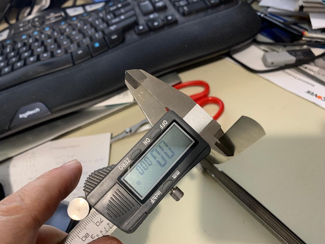

On my cheap caliper the outside measuring jaws when closed yields a thin amount of light coming through the top, inside measuring jaws. This means that the inside will not read correctly when the lower, outside reading jaws are zeroed. When I try to quantify the amount I see about .003". This is only an approximation based on me visually looking for the light to vanish between the points. So when I do inside measurements I either re-zero at this location or normally just add the .003" to the measurement. I have two of these Pittsburgh ie Harbor Freight units and the one mentioned is the worst of the two, it is also the older one. I still use them for woodworking but if I were wanting some thing more accurate I'd pull out the better ones I have. Just don't like to think about dropping a $170 one on the concrete when I don't have to chance it.
I've been to lazy to get out my expensive calipers to verify this number because well I've been to lazy...... Maybe this spring??
Re: Disappointed in MiterSet
So now I felt motivated to check this out a little farther. It seemed like a simple way was to simply use a feeler gauge to see what the space was. Started at .002" fit easy, then went to .004" and it was a no go. So there you go my guess at .003" was right on, looks like I still have it.....
