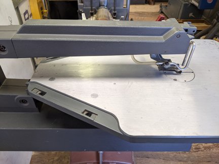

I've just acquired a grey 20" scroll saw, and I have a few questions.
It came with no mounting posts. I'm thinking I need the 6.5" eccentric posts, is that right?
My table has pairs of holes along the back edge that look like they could receive an accessory. I'm wondering what those are for.
Scroll saw table.jpg (25.19 KiB) Viewed 1228 times

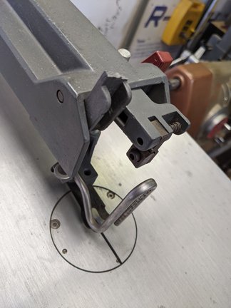

The upper guard is broken off, is this part available for replacement?
Scroll saw head guard stump.jpg (25.83 KiB) Viewed 1228 times

I picked up one of these recently too, here is a link to the thread and pdf of the older manual: viewtopic.php?p=276256#p276256 I'm guessing that if you order the current guard (aka hood, Item 2) you'll get a teal one, but I would think it would fit. You'll also need the bracket, Item 3, that is the part that is broken in your pic. And two screws to hold the hood to the bracket, Item 4 (IIWM I'd buy those aftermarket.) IIRC there was a recent thread on some difficulties removing the hinge pin for that bracket.

The eccentric Mounting Posts are 6-1/2" long like the Bandsaw and Belt Sander. The online service parts shows the posts as ref. # 114 but are not listed on the parts list itself for some unknown reason. They are P/N 5137779 (originally P/N 513777) and are $18.59 new from SS.
The two holes in the edge of the table are the Blade Mounting Fixture for aligning/mounting the blades. In the Owners Manual David linked above to Ron's post and follow the directions on page 8 even though that manual has a different Blade Mounting Fixture not part of the table.

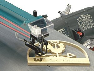

As for the missing cover it is plastic and should be a direct replacement for the original. See picture below. As I said in the other linked thread I upgraded mine which at the time included the cover.
