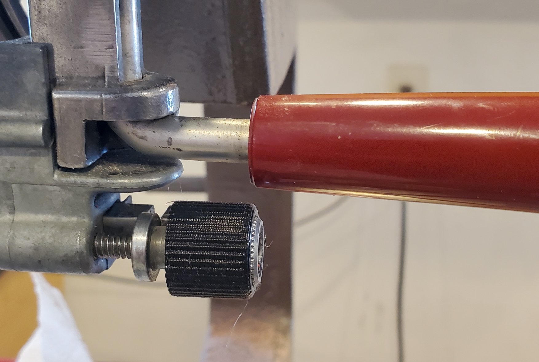

My hands are not as strong nor nimble as they once were and I find adjusting the forward/back of the blade guides a bit tough on the fingers. I've cleaned, de-burred, and lubricated it and it is still stubborn. Reading the forums it appears I'm not the only one.
I had the idea to adapt them to accept the 5/32 allen wrench, and over-engineered a solution. As it turned out, my adapter's mounting sleeve was all that was needed. Just this small increase in diameter of the adjuster makes a world of improvement!
Mine is printed, but I'm sure there are 100 other ways of achieving the same results.

Another option I considered was removing the tensioning spring then drilling/tapping for a nylon set screw.

Is the positioning knob not already screw driver adjustable?
Re: Easier bandsaw blade depth adjustment
dusty wrote: Sat Feb 27, 2021 2:50 pm
edma194 wrote: Fri Feb 26, 2021 3:14 pm I'll be installing Carter guides shortly and promised my self to look for a solution to this. Maybe a piece of plastic hose is all I need but I'm sure a good cleaning will loosen that up a little too.
My error.
Yes, it is screw mounted but not intended to be adjusted that way. The adjustment knob is mounted with and travels on that screw. When I attempted adjustment using a screw driver I believe I loosened the screw which might have been locktited. Now, to do the adjustment I have to immobilize the screw and use the knurled knob. (No locktite in the shop. I must have purged when we moved.)
