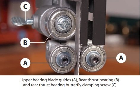

OK. I misunderstood a bit on how this blade is supposed to work. The video below explains the intent of this blade. I erroneously thought that those back teeth were meant to help clear out sawdust from the kerf during the cuts. Instead the intent is that those back teeth are meant to cut slightly. It is supposed to allow you to make tighter cuts, e.g. circles in deep material which is why it is suited for bowl blanks. This is why the text description mentioned that it widened the kerf, i.e. as you cut a tighter radius with it those back teeth cut on the outside kerf line to widen it as you go (enabling a tighter radius of cut). No real advantage to a blade like this for re-sawing since it is all straight line cuts. Given this new information (for me), it looks like this blade may have an advantage, but I don't know how much it would help. In the video they show Axminster brand bandsaws being used for it. Below is a pic of what the rear thrust bearing looks like on the Axminster AT2552B bandsaw. I would think eventually that back tooth arrangement would destroy the collar of that bearing, but they may just consider this normal wear and tear, i.e. they may consider it a consumable that can be replaced if you use this blade.
