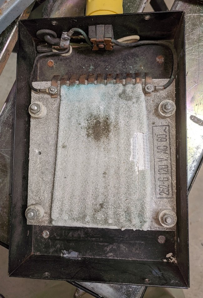

Good idea. So I dug through the shelf of misfit tools to pull out an old polishing machine that came with an old foot pedal. I opened it up and after vacuuming out the remains of mouse habitation this is what I found inside.
That's an ancient rheostat. Possibly from the early 14th century. When I stood it up to take a picture some insulation fell off the top. I'm going to try to cover that with some refractory cement. I think it's just a row of wire wound resistors in one big pack.

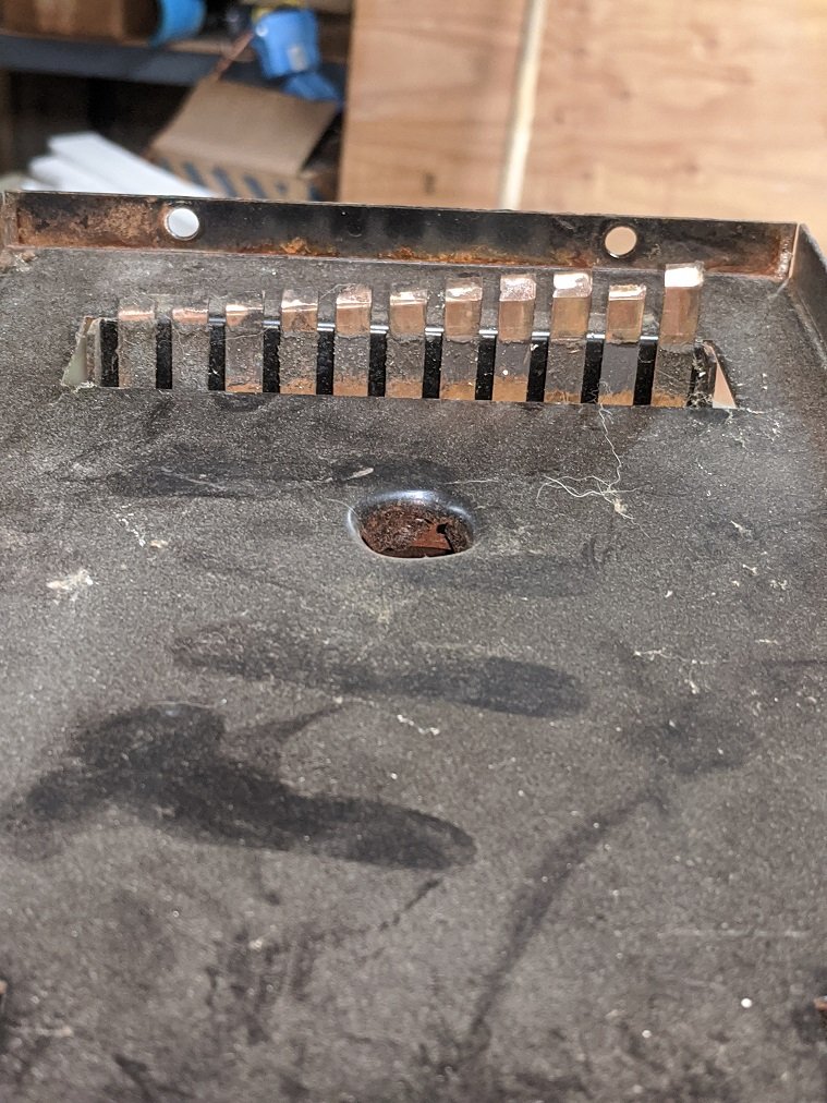

Look at the bottom of the pedal here to see how it works, there's a row of different length copper contacts that mate up with the ones on the rheostat at different points as the pedal is depressed. It has a 3 prong socket on it, but for some reason was wired with a 2 prong plug, that has to be changed. But it does work, at least for the short time I tried it out. The scroll saw already has variable speed so I don't really need that rheostat for that. I'm not really sure what that would be useful on, but just the on/off capability will be nice to have.
