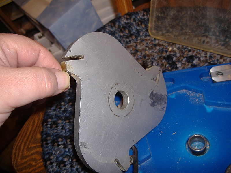

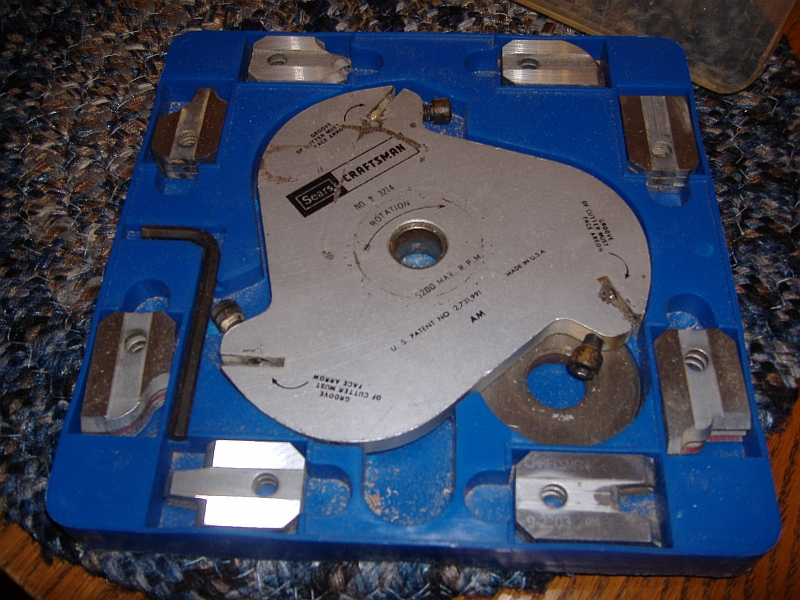

I have to have an arbor for my molding head. I don't have a shopsmith molding head as I owned this one before I got a shopsmith back in 1976.... This the one that Sears sold way back when:
[ATTACH]3011[/ATTACH]
[ATTACH]3012[/ATTACH]
So as you can see not all molding heads are the same.
