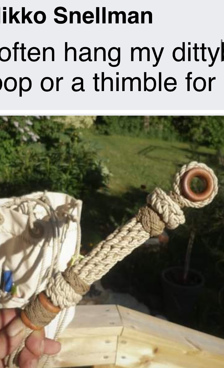

BTW, I finally got that cup center out... I held the drift with a pair of pliers so I could whack the heck out of it and it finally came loose.

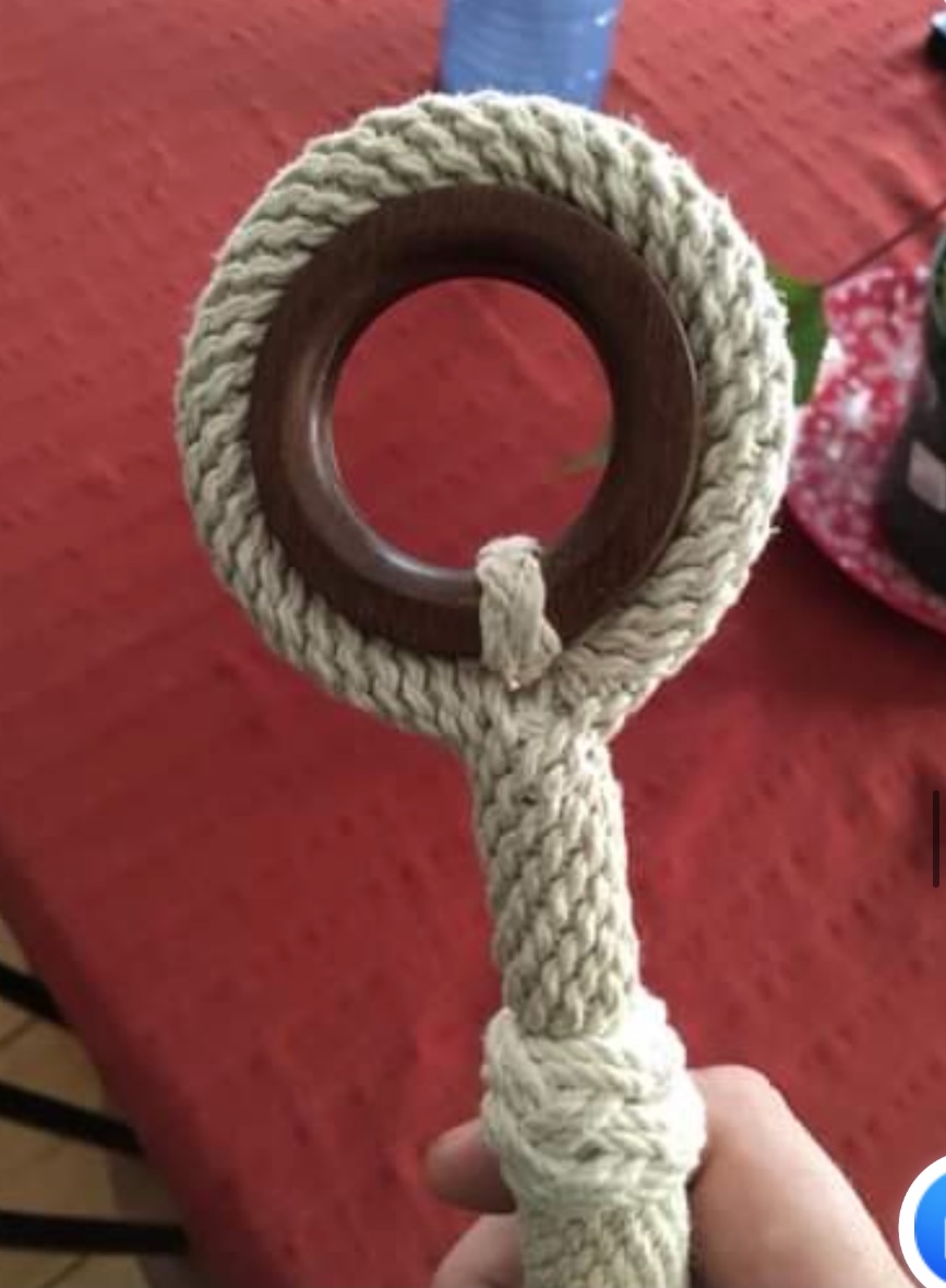

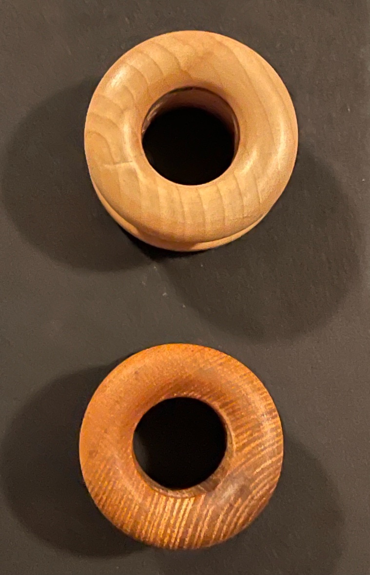

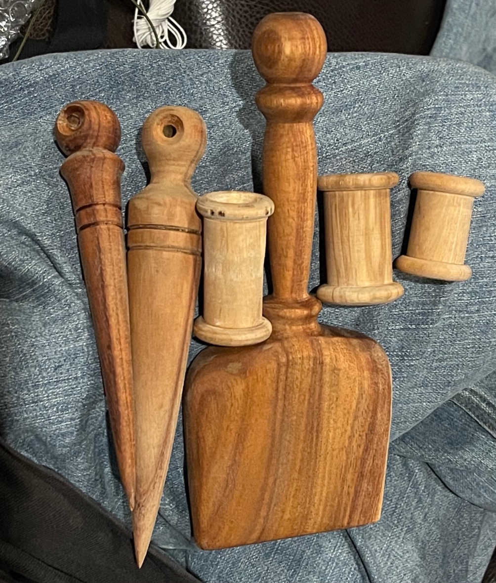

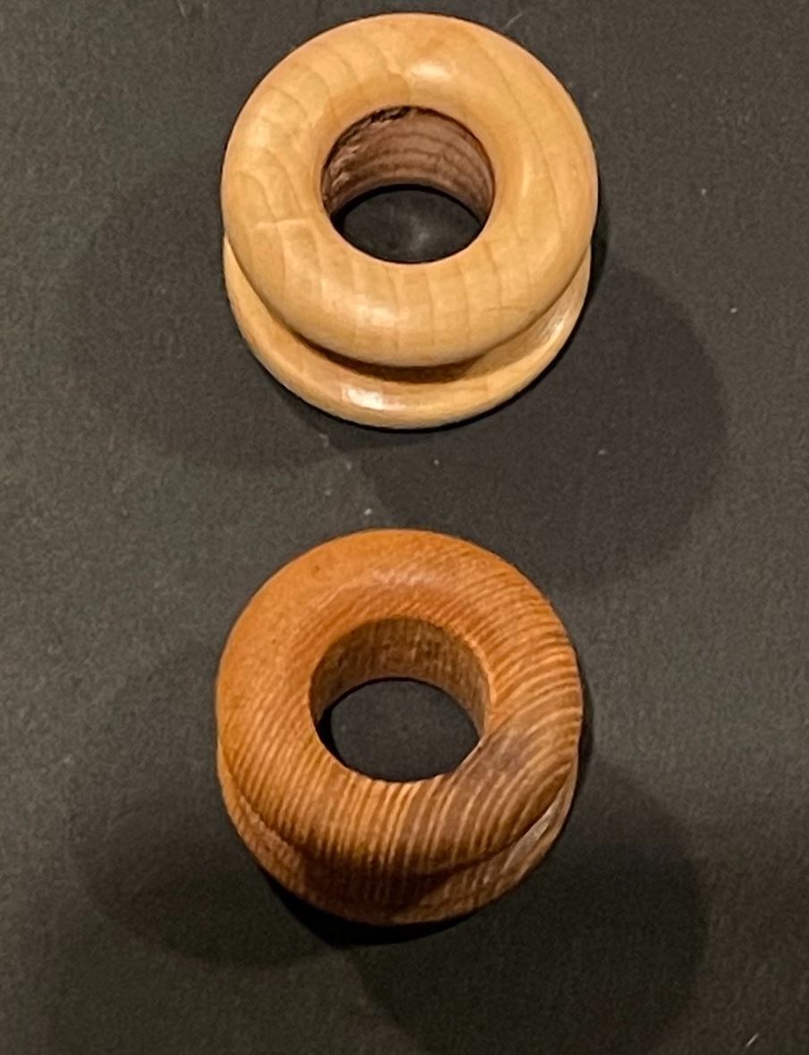

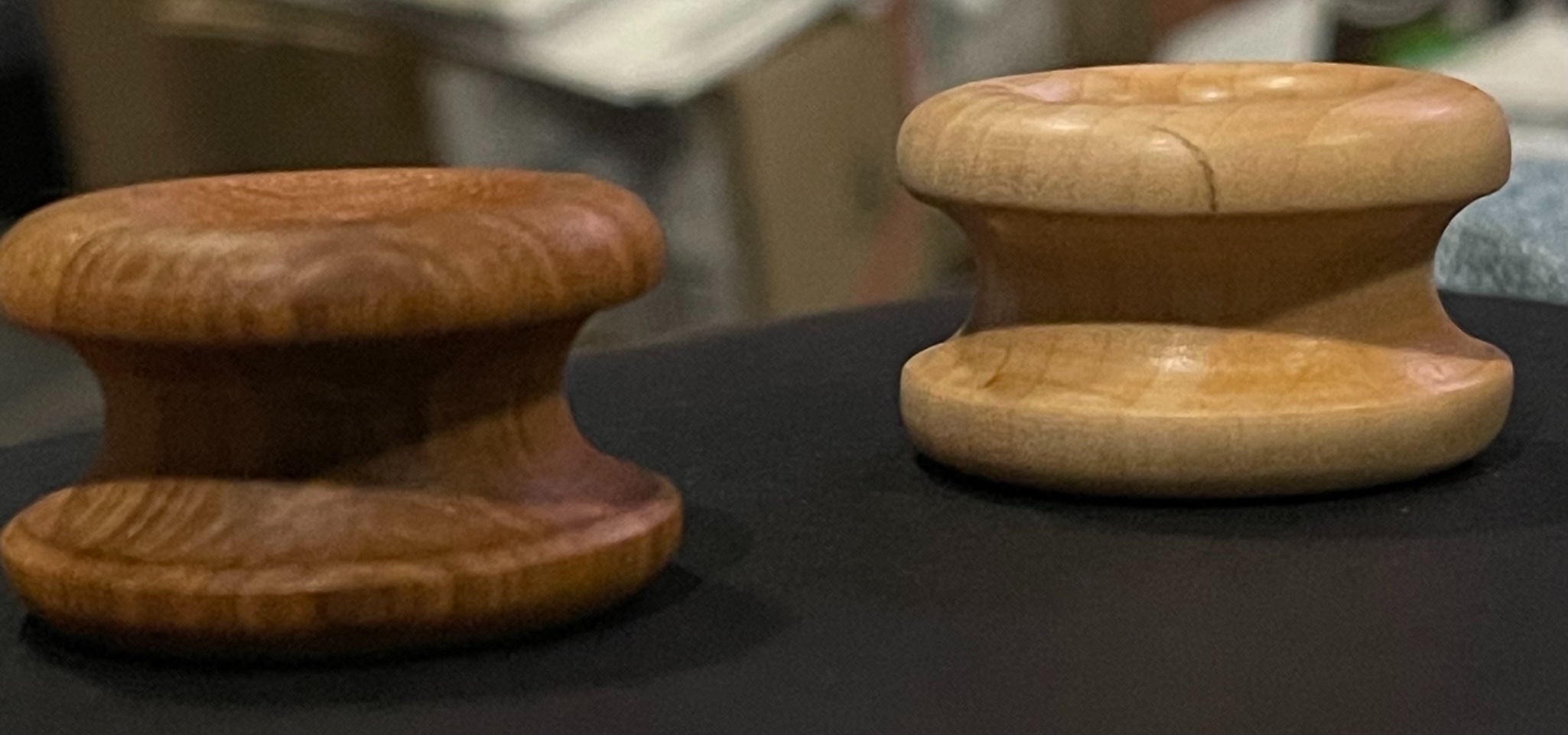

What type of center would you recommend for making thinks like wooden fids and thimbles? I can post pics if y’all aren’t familiar with those...the fids are basically wooden spikes used to splice rope and the thimbles are small ferrules used in nautical rigging...

Hopefully these will help a bit...

Re: Beginning fixing up a 10E — Need help please
I think I would be inclined to attempt that with a small chuck.
jumpmaster
- Posts: 57
- Joined: Mon Mar 22, 2021 4:32 am
I was thinking of a Nova chuck with appropriate adapter?
How would you do the interior hole? Probably a forstner bit, but I’m not sure how to round/radius the edges...
Same way thee rounds the od.
