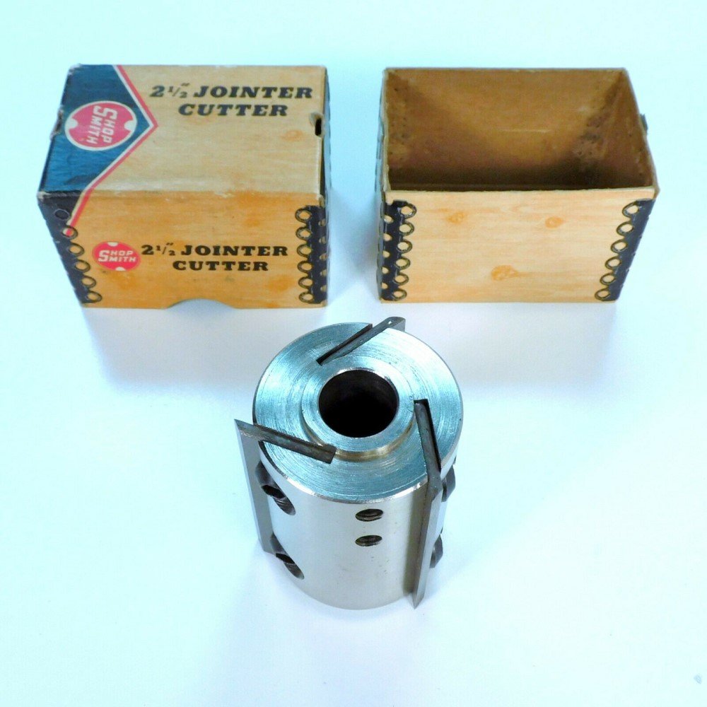

2 1/2" jointer cutter
I have the shaper/jointer fence with my 10er, have the shaper cutter arbor but do not know what the jointer cutter arbor-spindle looks like. Anyone know?
Re: 2 1/2" jointer cutter
It fits directly on the spindle, no arbor required. The hole on the outside end is smaller, so it can only go on in the correct orientation.
- Posts: 4538
Below is a picture of the Jointer Cutter Head. Note the 2 set screws that hold it directly on the Quills 5/8" Spindle. The set screws will be either 1/4" (Model 10s) or 5/16" (Mark 5).
