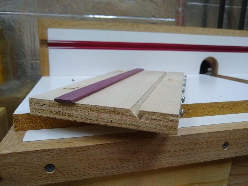

I built a jig for myself. It holds 3 blades.
The slot angle is such that the top of the blades run parallel and at same height to that piece of purple heart (?). The angle is based on the blade angle
itself ..which i forget at the moment. I think i put something on the purple heart riser to avoid sanding it away ..maybe aluminum foil. The screws on right side come into the slot and press the blades flat against slot wall.
In this configuration, the wet stone or diamond sharpener resting on both the blade and purple heart would be moved from right to left.

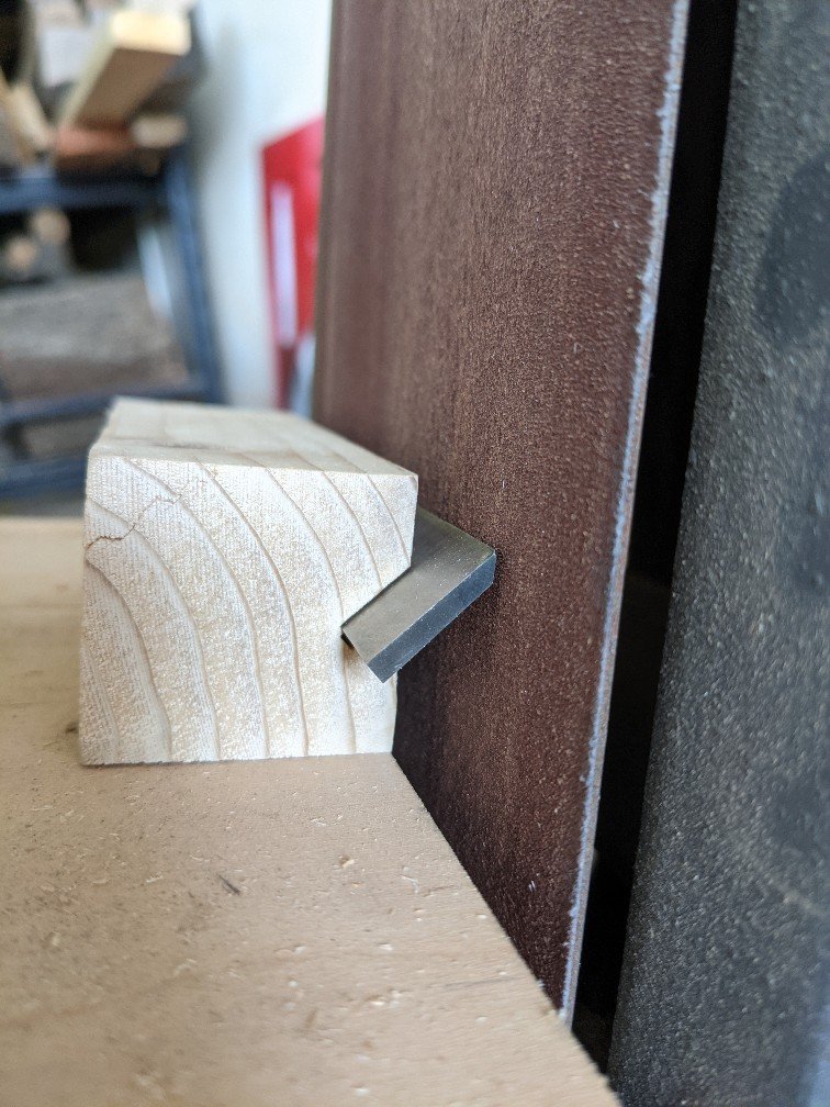

I made something very similar myself. I'll try to upload a photo later today. It works ok, but I'm having trouble getting the height of the shim just right. I used duck tape to protect it from wear.
Yesterday I attempted to use my SS belt sander to sharpen the knives with some good success. I'm just not sure how sharp the blades really need to be. I'm hoping to hear from someone on that point in particular.

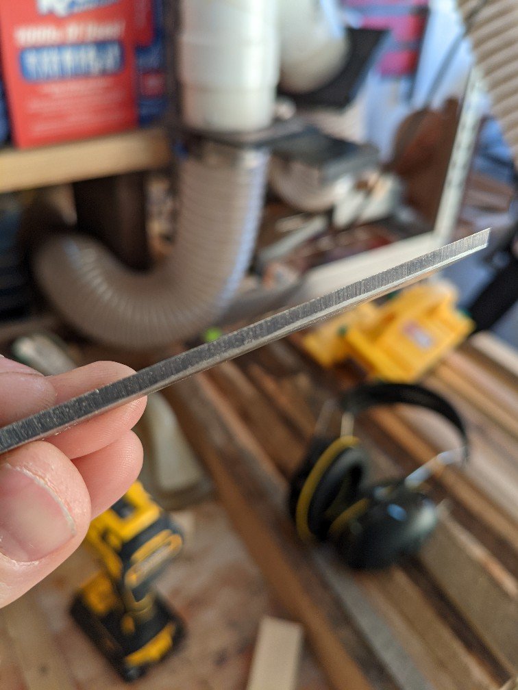

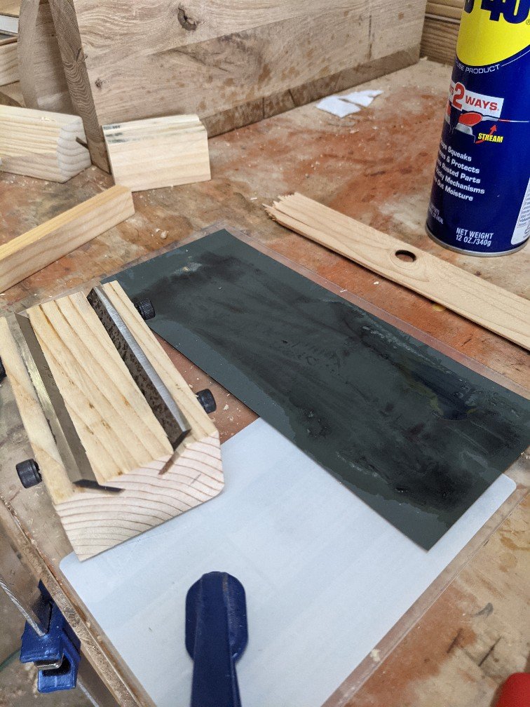

For anyone that might want to know what I have eventually decided,...
I did the initial sharpening on my belt sander using a block with a slot cut in it that holds the blade at the right angle. I then used a jig I made to hold the blades at the proper angle (mine isn't perfect but it's good enough). I used 2000 grit sandpaper to honr.

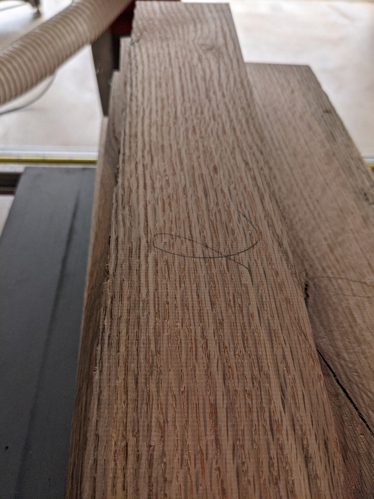

The photo of oak is of a piece after joining. It looks pretty good to me and the jointer performed better so I guess the blades are sharp enough using this method. No telling how long they will stay sharp though.
Ithabks to those who commented! would still love to hear from someone who has been doing this a lot longer than me about how to tell if the blades are sharp enough for joining though.
