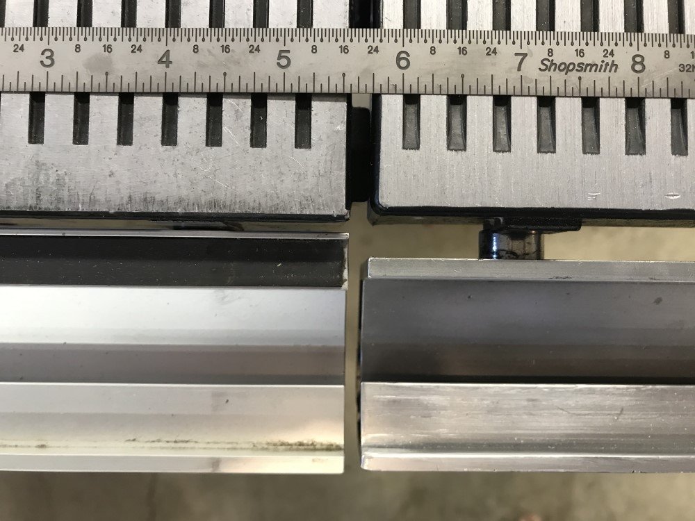

What do those magnetic tapes stick to on a Mark 7/520?
Ed from Rhode Island
Posts: 4229
Re: Magnetic Tape on 520 Front Rails
They stick to the front extruded aluminum fence rails on the Mark V 520 and Mark 7. In the picture below the table on the left has the magnetic strip closest to the table edge and the one on the right is the earlier fence rail without the magnetic strip. As you can see the ruler itself is wider than the magnetic strip.
