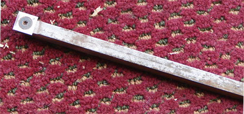

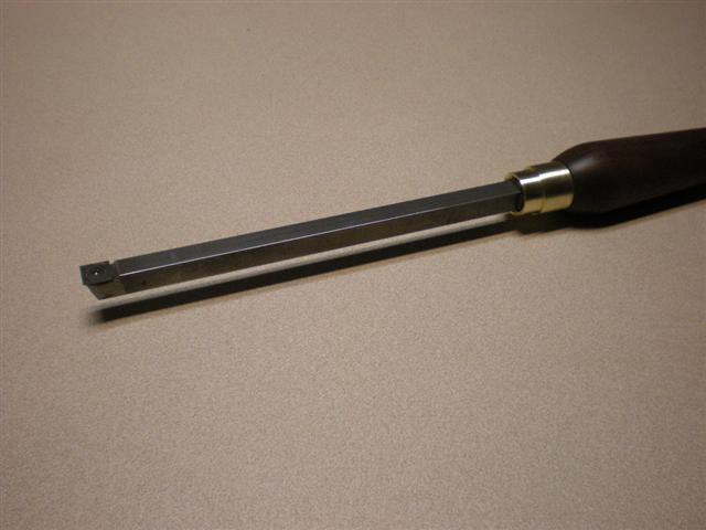

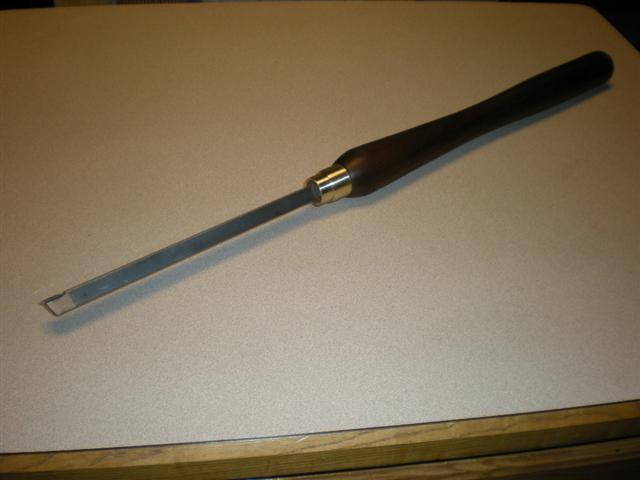

ed, the cutters come from grizzly for about $2.50 (but they come in boxes of 10) the 3/8" square stock came from hartville hardware (hope dusty doesn't see this) the handle was from skid lumber (hard maple and free) and turned to what i call "sorby" style 14" long. the ferrule came from hartville also (3/4" copper coupler $.46) cut in half $.23. i shaped the end of the square steel stock [ATTACH]3014[/ATTACH]
[ATTACH]3015[/ATTACH]
[ATTACH]3016[/ATTACH]carefully on a bench grinder about 2" to pretty darn close to 3/8" diameter till it fit in a 3/8" hole in the handle and epoxied it in. (not figured in total cost as it was on hand) the tool end was rough shaped on the bench grinder and finished in a vice with a dremel tool. i used a #21 drill and a 10-32 tap to hold the cutter in place. 10-32 x 3/8" flat head screw also from hartville $.18 these pics are borrowed from the IAP site and are not mine.
