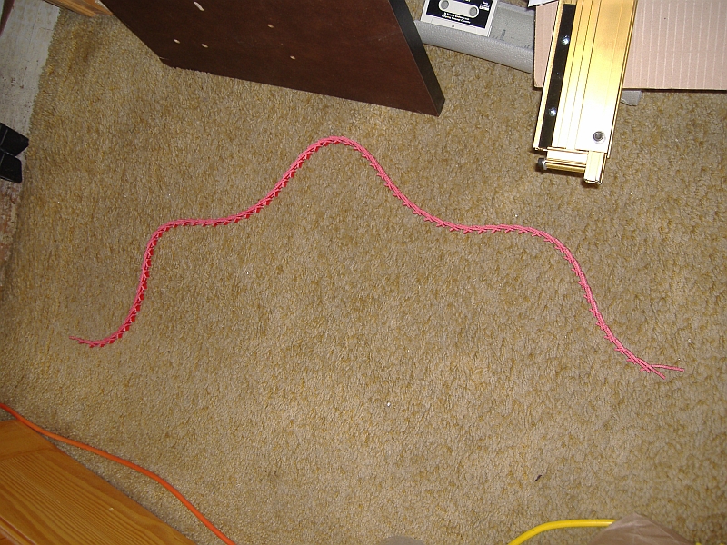

Un-packed my link belt and was thinking that maybe some of you have no idea what these belts look like. I snapped a couple of pictures. First one is after the belt had been out of its package about an hour... the set is coming out as it was wrapped in a chipboard holder much like a regular belt might come in. I just dropped it on the floor and this is how it fell.
[ATTACH]3096[/ATTACH]

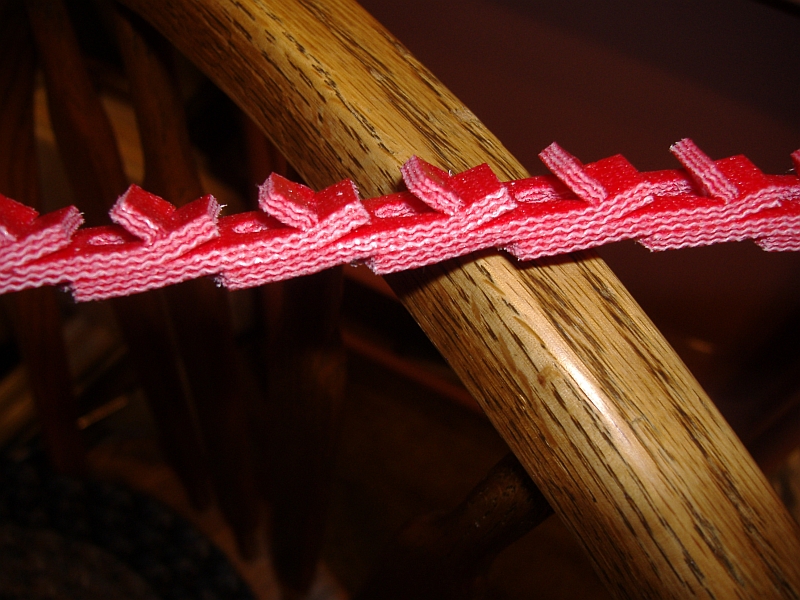

The next shot is what it looks like on the outside, much like it would look sitting in a pulley.
[ATTACH]3097[/ATTACH]

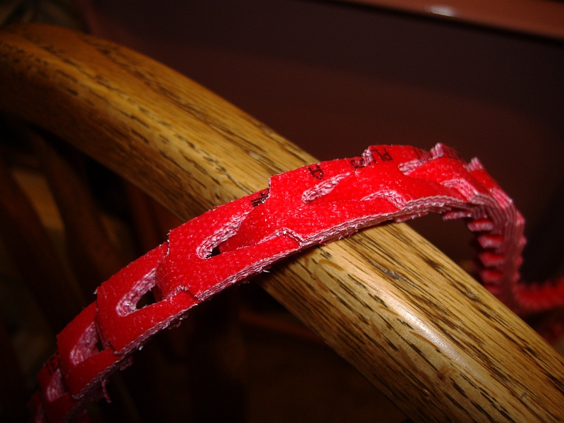

The inside looks like this.
[ATTACH]3098[/ATTACH]

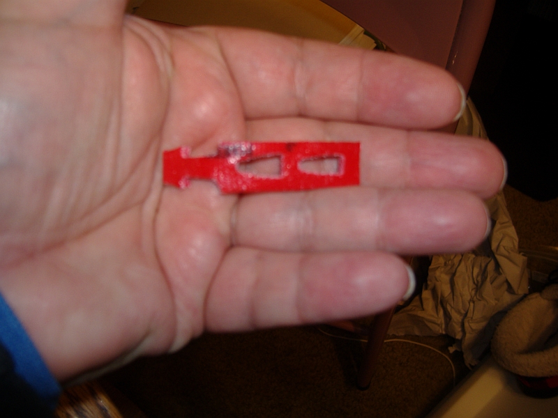

A single "link" looks like this.
[ATTACH]3099[/ATTACH]

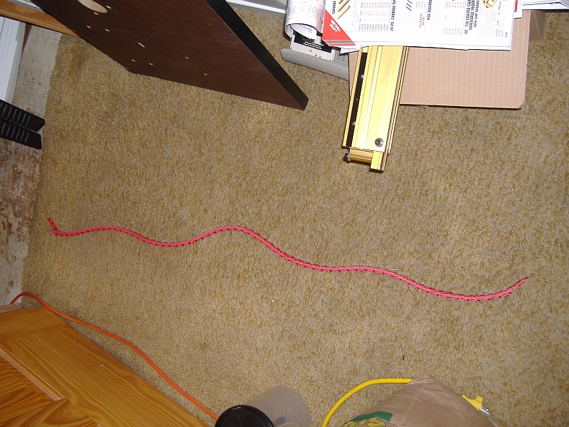

In about another hour I'll shoot and past another image of how the set is coming out of it. I'm as interested as you are as it has been a couple of years since I last did this.
It has been about another hour and as you can see it has lost more of its packaging set. My guess is that it will still get a little better but not all the set will come out until it has run for a while in a real application.
[ATTACH]3100[/ATTACH]
OK now I'll wrap it back up and stick it in a box until the weather warms... that is unless some one has another picture they would like to see???
