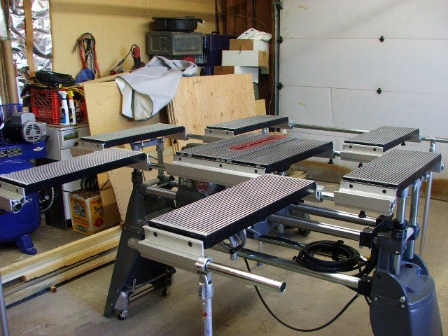

If I had two more they could be added between the main table and the fixed extension tables on either side. You would need to use 5' tubes on the main table instead of the short ones.

John's set up is a great example of a different table arrangement. Do keep in mind he is using 2 sets of the Infeed/Outfeed Extension Table Brackets P/N 555997 plus extra table parts. On page B-46 (the last page of the Assembly & Alignment section) of the Mark V 520 Manual, if you have the same version as mine, is a page of optional setups. With longer connector tubes like the 5' ones available (P/N 521942) and extra Floating Tables you can expand the table system in many different ways. With 5' connector tubes John's setup for the infeed and outfeed tables could be spread wider apart. The only real limiting factor to table arrangements is the Main Table is the only one that can have 4 connector tubes used in it, 2 in the front rail and 2 in the back rail.

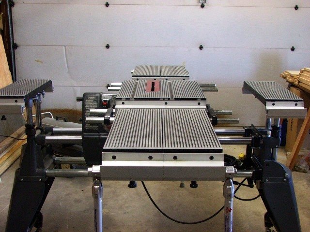

Here is another example. This does not use the Infeed/Outfeed Extension Table Brackets P/N 555997 but you need two sets of telescoping legs.

John's example above is exactly what I was referring to when I said
There are so many options for setting up the tables.With 5' connector tubes John's setup for the infeed and outfeed tables could be spread wider apart.
