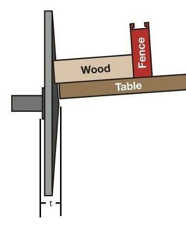

If someone has a conical sanding disk maybe they could figure out how thick it is for me. I'm looking for the distance 't' in the drawing below. I'm designing a dust collection shroud for disk sanding and need to find the width I'll need for the various disk types. The flat steel disks are quite thin but I also have an aluminum disk and that will already need at least 3/4" total space for clearance with the ribbing it has on the back. I think the conical won't be much wider than that if at all but might as well prepare in case I get one someday.

It is slightly different than your drawing. The thick portion of the hub does not protrude beyond the rim as you've depicted it. So my 't' starts at the rim. I got 13/16".

This was a bit beyond the capacity of my longest calipers, so take this with a grain of salt, but I measure 1/2 inch.

Uh Oh. DLB and I are way off. And I don't think I'm squaring with his objection to your drawing.
Are there different versions of the conical sanding disk?

My drawing comes from the product page: Shopsmith Exclusive Conical Sanding Disc
That's all I have to go from, I've never seen one. 13/16" should be fine. If it is only 1/2" I'll have plenty of room already.

davebodner wrote: Sun Jun 06, 2021 6:47 pm Uh Oh. DLB and I are way off. And I don't think I'm squaring with his objection to your drawing.
We are way off, I'm thinking there must be different versions. The rim alone on mine is 1/2". Which might explain why on mine the thick part of the hub is not seen in that view. Not even close.

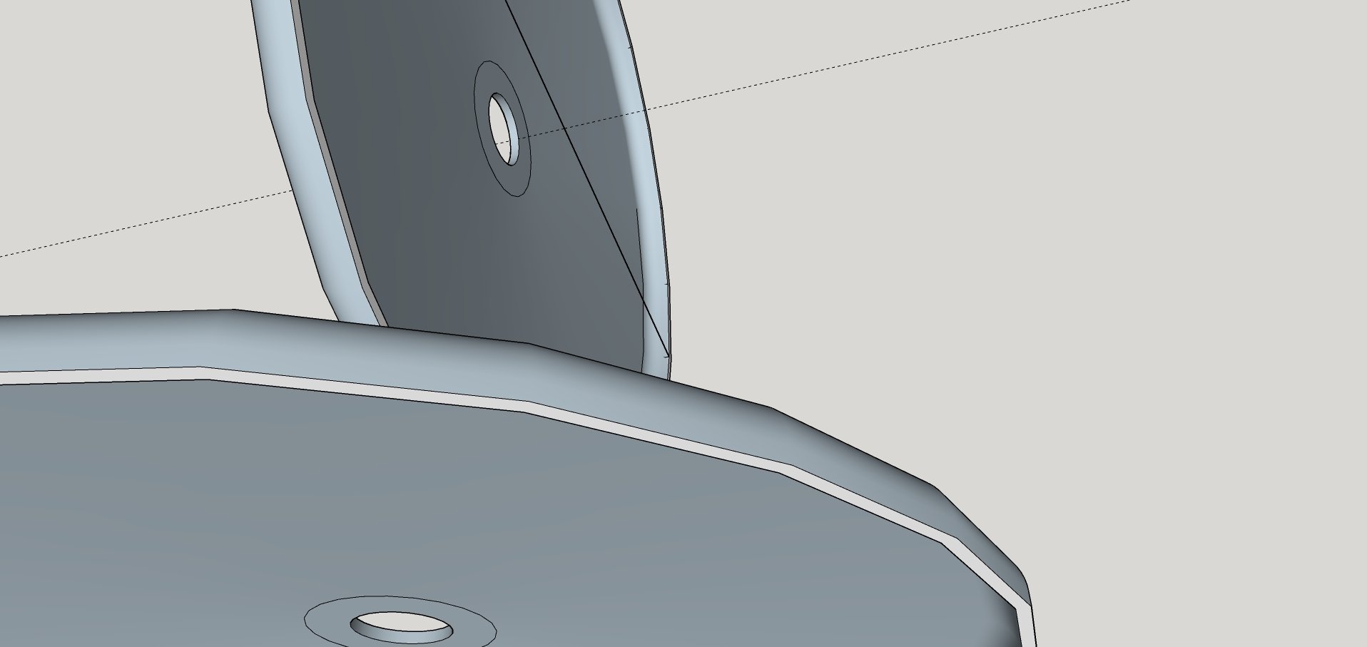

Re: Conical sanding disk thickness
YES there is a difference of some sort..
The disk itself (measured without the spindle is 51/64" thick.
Conical Disk without the spindle.
A Conical Disk.jpg (79.03 KiB) Viewed 1636 times
To make this measurement, I removed the spindle from the disk, laid the disk flat on my workbench and measured the distance down through the hole to the workbench surface.

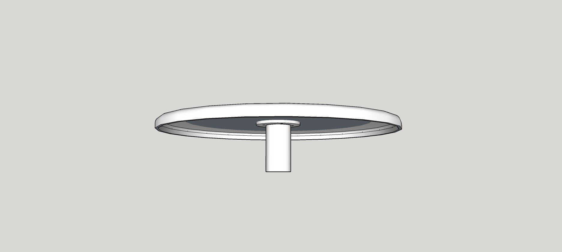

Adding the spindle creates a entirely different situation.
Conical Disk with Spindle attached.
A Conical Disk with Spindle.jpg (43.77 KiB) Viewed 1632 times

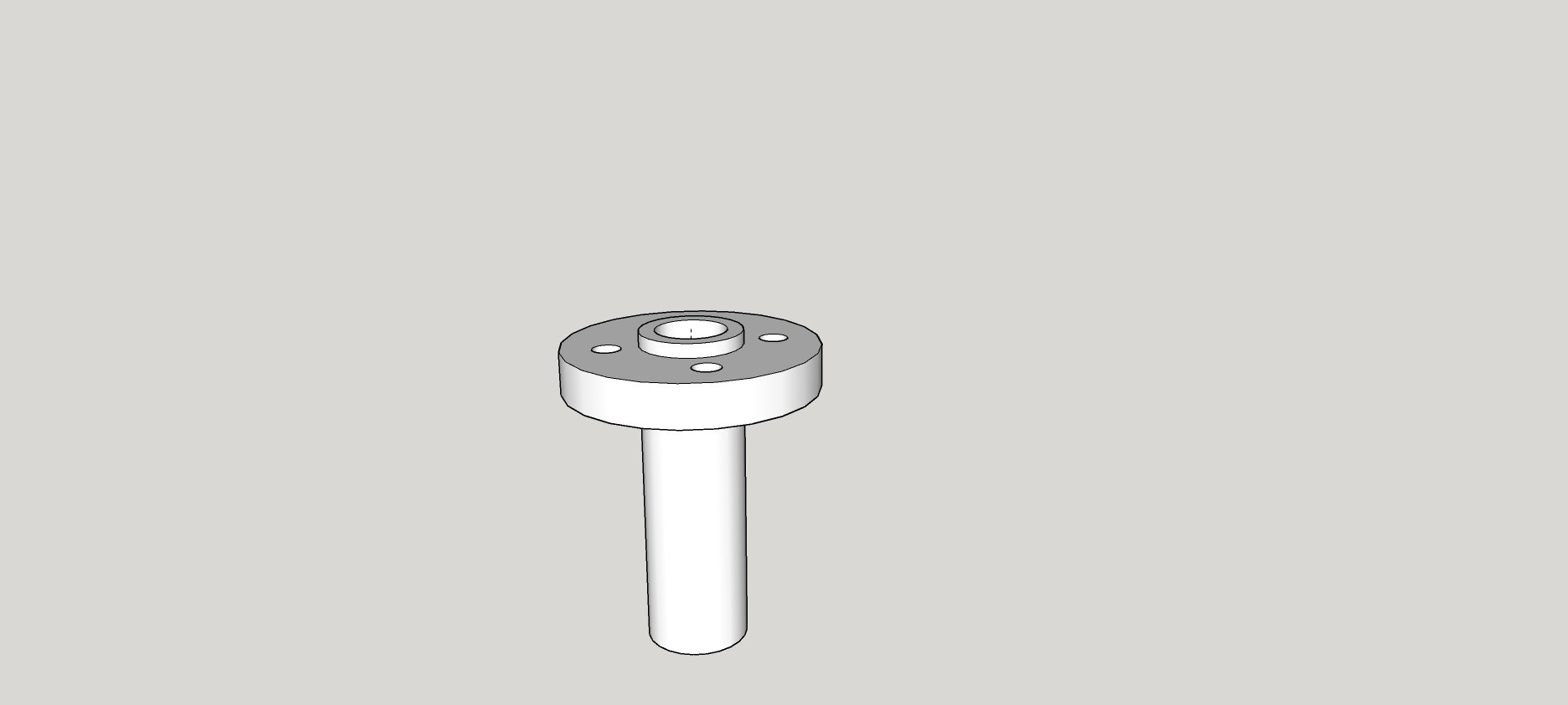

Then there is the Spindle
Spindle for Conical Disk
A Conical Disk Spindle.jpg (36.16 KiB) Viewed 1625 times
