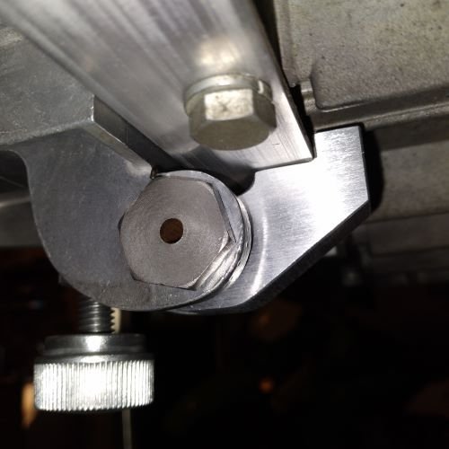

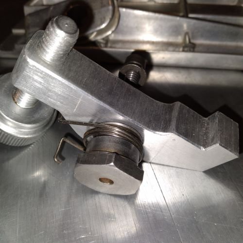

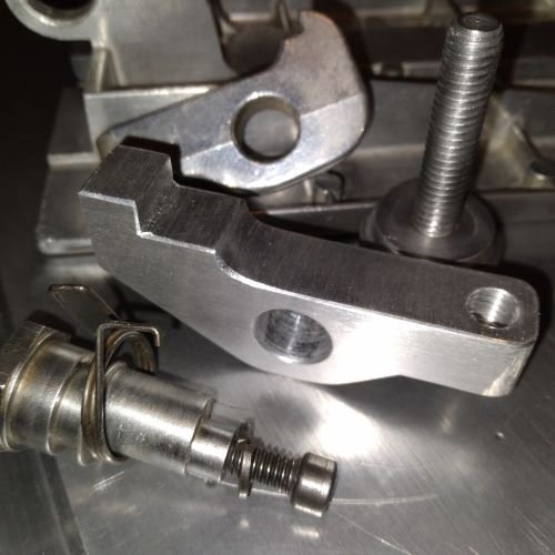

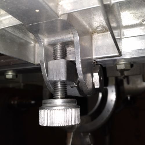

Hi Russ, that is the question. I think it is the one with the square block shape at the attachment point, as opposed to the one I inadvertently purchased, aka the Greenie version.
Hopefully JPG can provide the dimensions to confirm. I only know of two attachment types.

The distance from the pivot hole to the outer end is 1 3/8"
The first 'flat is 3/8" in from the end.
The second flat is another 1/2" (7/8 overall).
The final flat is 1 1/6 from the end.
Realize these are eyeball measurements.
If you need more holler.

You need to wiggle the spring a bit. The spring is in a groove on the cam. If you center the spring it will come out of that groove and the cam will slide out.
Could you post a few pics looking directly at the side of the attachment piece. I am trying to see if all the flats are parallel to each other, or if one has a slight slope.

I believe they are parallel including the non functional long surface.
Will reattempt disassembly and if successful post a pix.

No worries JPG, I am all set. Don't bother disassembling yours. It can be a pain to get back together.JPG wrote: Sun Jun 13, 2021 1:20 pm I believe they are parallel including the non functional long surface.
I used your dimensions, the greenie part, and some wild ass guesses. It came out perfect, mates up precisely with the aluminum rail and works like a charm.
