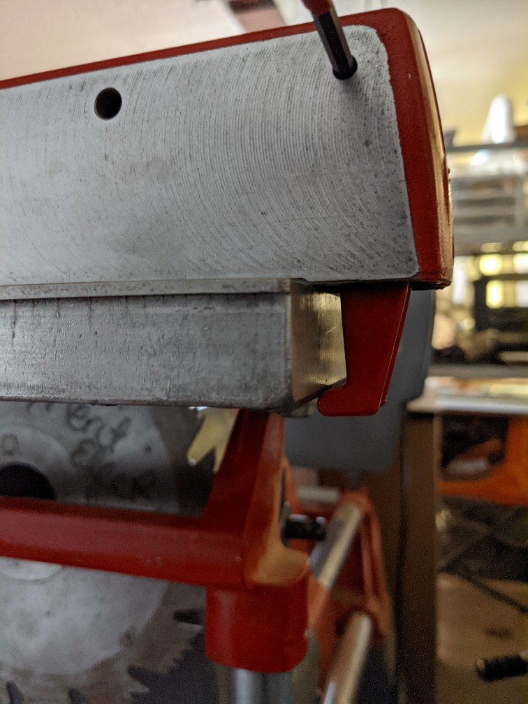

I took a closer look at the tip Fence for my mark V 500 today and was surprised to discover that the non-handle end doesn't look like it locks to the table correctly. It could be just my understanding of how it's supposed to look but Im assuming the L bracket in the photo I've attached should fit around the end of the table, but it doesn't.
Is this how it's supposed to look? Nothing looks bent so if not what should I do?

On my 'pre-500' Greenie the outfeed end lock goes further than in your pic, but I don't think the contact area is significantly different. The vertical part of the lock piece on mine is more vertical, about parallel with the table edge when locked, but is not in contact with the table. Seems like there was a similar thread not too long ago, maybe an issue with the sequence of the parts on the rod. I'll look for that, in the meantime someone else probably knows.

That other thread was this one: viewtopic.php?f=10&t=23391&start=20 It has a good bit of detail and may be the issue you are having. The OP's first pic looks similar to yours.

Thanks for the link! It does provide some helpful info...but also what seems to me to be conflicting information. In some photos the L bracket sits flat against the end of the table, but in others it doesn't. I'm not sure which position is correct, but I'm starting to think mine may have been a manufacturing defect
My assumption is in large part because I have a hard time believing the intention is for an L bracket to not sit flat around the end of the table. If that was the intention why make it an L shape in the first place?
I took the whole thing apart (including the roll pins) and I'll put it back together tomorrow so I guess I'll find out if there was something amiss in alignment, but considering that photo was taken with everything but the roller pins removed I'm not holding my breath.

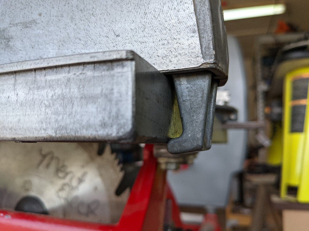

I've taken some photos of the fence now that I've had time to play with it. Based on the thread link provided I think either the part or the fence was not made properly. Based on the following two photos, which one looks correct? (I used some alen wrenches of different sizes to hold the part in place)
- PXL_20210615_011512590_copy_756x1008.jpg (148.02 KiB) Viewed 5380 times
- PXL_20210615_011642203_copy_756x1008.jpg (140.06 KiB) Viewed 5380 times

In looking at this more closely I see more difference between the Greenie main table and the 500 main table than I was aware of. The most obvious difference, which I was aware of, is on the front edge. The Greenie front edge is cast as part of the table, where the 500 version appears to be an aluminum extrusion bolted (?) to the front of the table. But the difference I'm noticing for the first time is that the chamfer on the outfeed end of the table appears to be much more pronounced on the Greenie. So, on my Greenie the fence engages the table on the chamfer at both front and rear. It makes engagement of the rear lock only on the chamfer look perfectly normal and as intended. I can't say with certainty that it is correct, but the only part of the "L" that touches the table is the tip of the horizontal part, and it engages right on the table chamfer. When locked, the vertical part of the "L" is roughly 1/8" away from the table on mine. I used it this way for decades and never had an issue with it locking. But, full disclosure, I'm all in on 520 now, and I don't have a true 500 table to look at. Note the Greenie outfeed end chamfer in the first pic from the other thread, I think this is much different from yours: viewtopic.php?p=268087#p268087

Yeah mine is from the 80's (I don't recall exactly what year at the moment). It's good to know though that it shouldn't make that much of a difference in the long run. I guess as long as the fence still locks in place I have nothing to worry about.
Thanks for the information and advice!

The "L" shaped clamp is intended to ONLY contact the back edge of the table on the beveled edge. The bevel provides both front to rear clamping and vertical as well pulling the fence down against the table top. The actual dimensions of the bevel is not critical. as long as the rounded surface on the "L" contacts the bevel.
