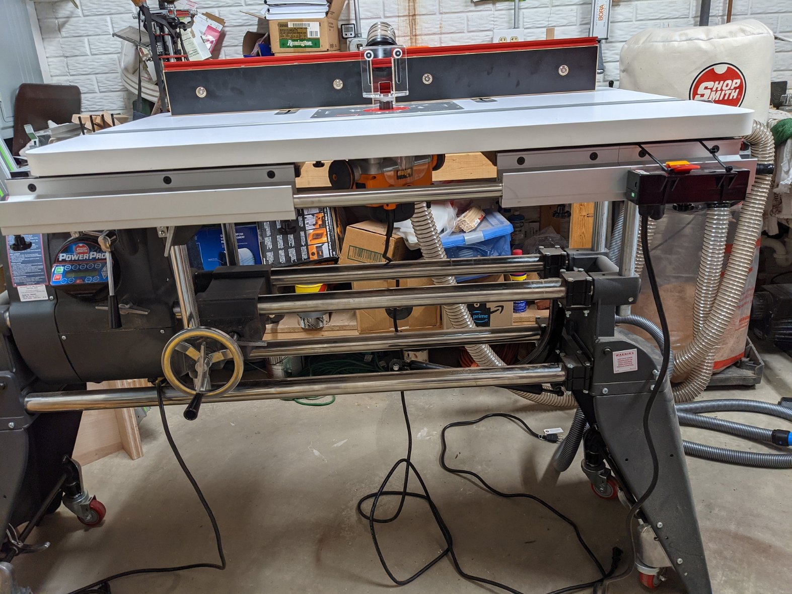

c2h6o wrote: Sun Jan 29, 2017 3:20 pm Image[/img]First want to thank everyone for comments, insights and suggestions. After careful thought I decided to mount the Phenolic router table (3/4 in thickness) on top of the SS work table and an extension table. I adjust the spacing between the worktable and extension table so the it provided support to the router table, leaving just a big enough gap to allow for the router and a lift should you want to use one. Drill four holes in the router table and SS tables to accept 5/16 flat hex head screw (1.5 or 2 in) and 5/16 screw knobs under the table. The hex head screws are counter sunk in the router table to provide a flat surface. If I ever need an out feed extension table I can use the left side extension table for support and lay down a 3/4 " piece of plywood. I will be mounting a remote switch to the SS for easy on-off and emergency stop function. Will ad a fence and debating on the need for a lift. This table configuration is easy to mount and remove. Saves shop space and gives me the flexibility of height for the router set-up. Posted a few pictures.

Deicer wrote: Mon Jun 28, 2021 6:13 am Hi, What size of the woodpecker table is that?
Thanks you Jim
Welcome to the forum! That table is offered in 24" X 32" and 27" X 43". To me it looks like either could be adapted to this installation. But it looks to me like he used the smaller. If c2h60 is still active he can say for sure. The fence is 36", and in the photos extends beyond the table. (See Woodpecker's PRP-2 and PRP-4 packages and you can see what I mean.)
That is a nice setup. I would not recommend it for MDF though without adaptation to add support to prevent the table from warping downward between the SS tables.

This is what I ended up doing.

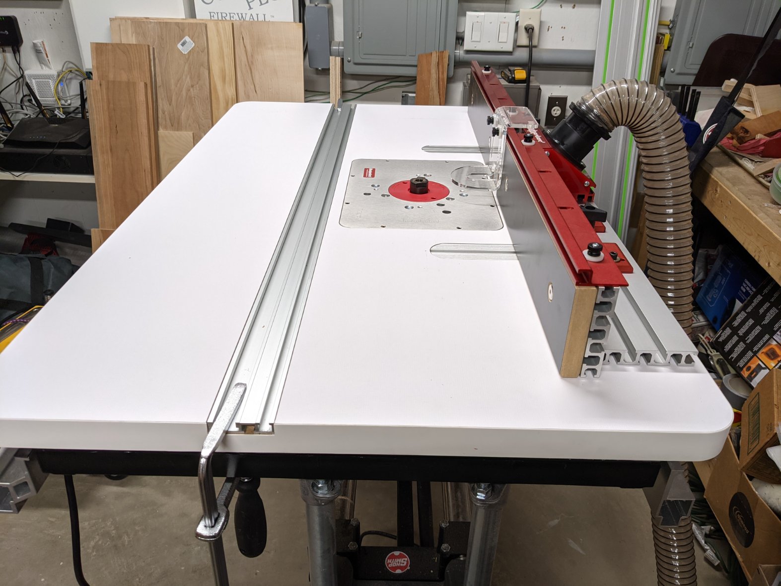

Another pic

Post by algale »
That looks like a great set up!
