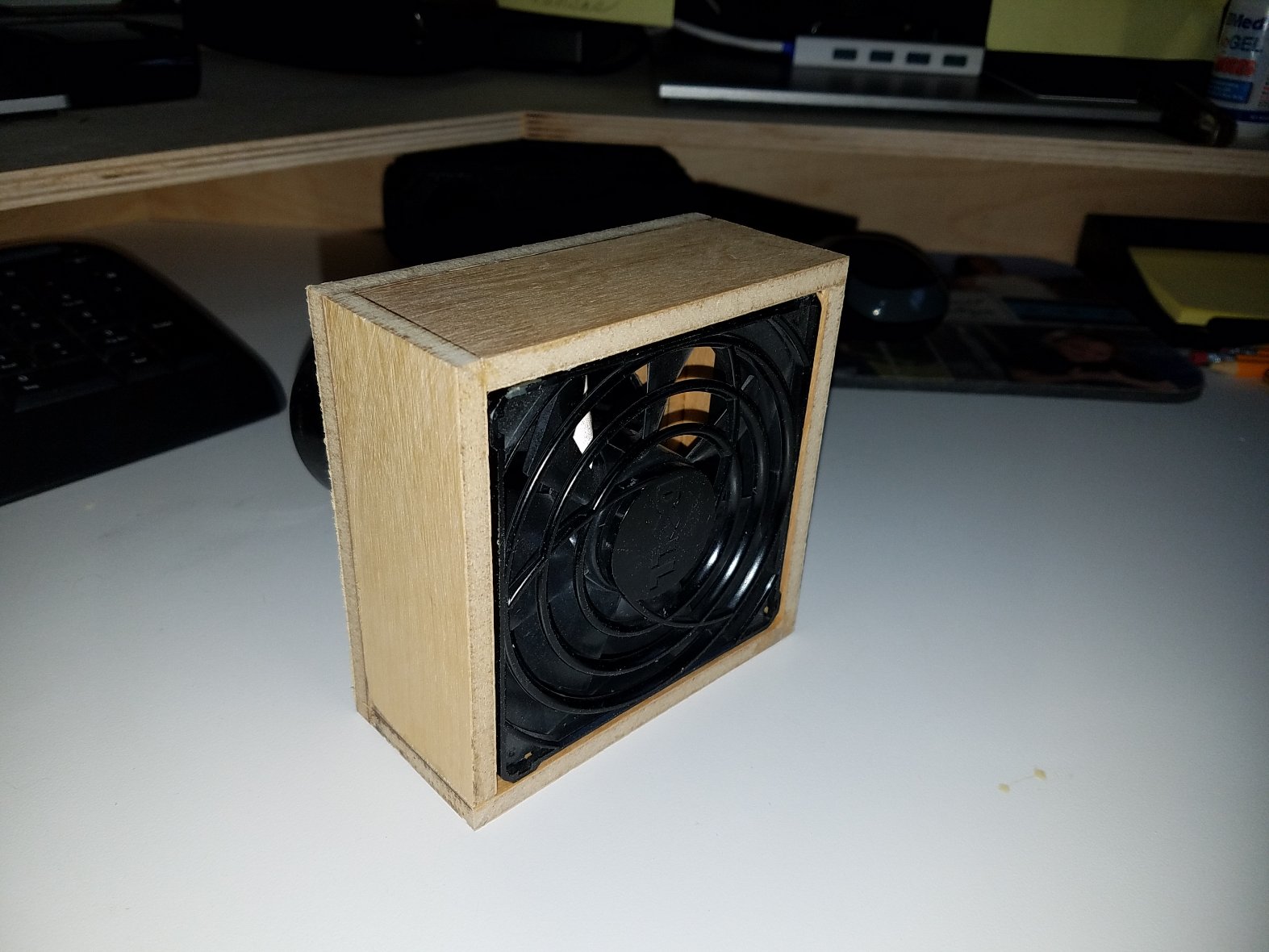

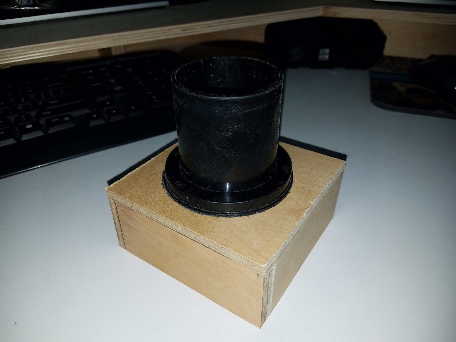

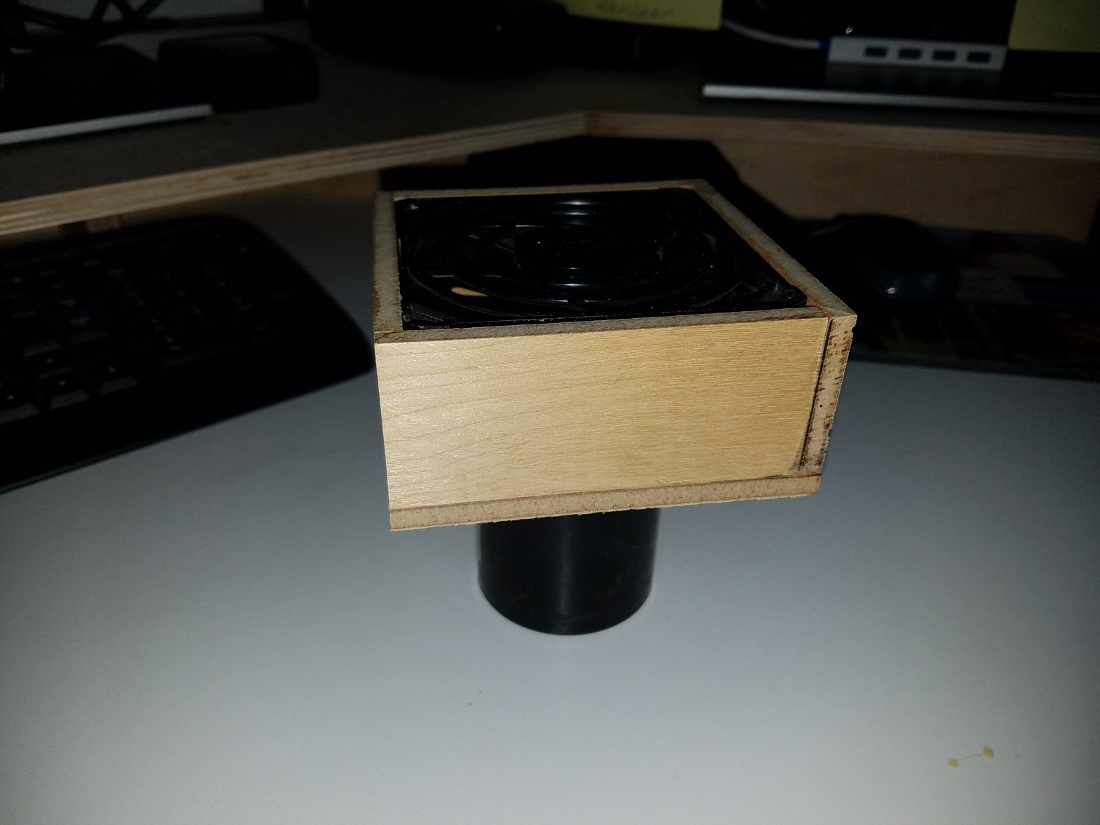

I am no longer without instrumentation. It would not make it through a calibration lab but it will do what I need ( that is excited by Dust Collector air flow) and provide a relative indication of the different hose configurations. Understand that a tachometer is needed to take the rpm readings off the fan blade.
