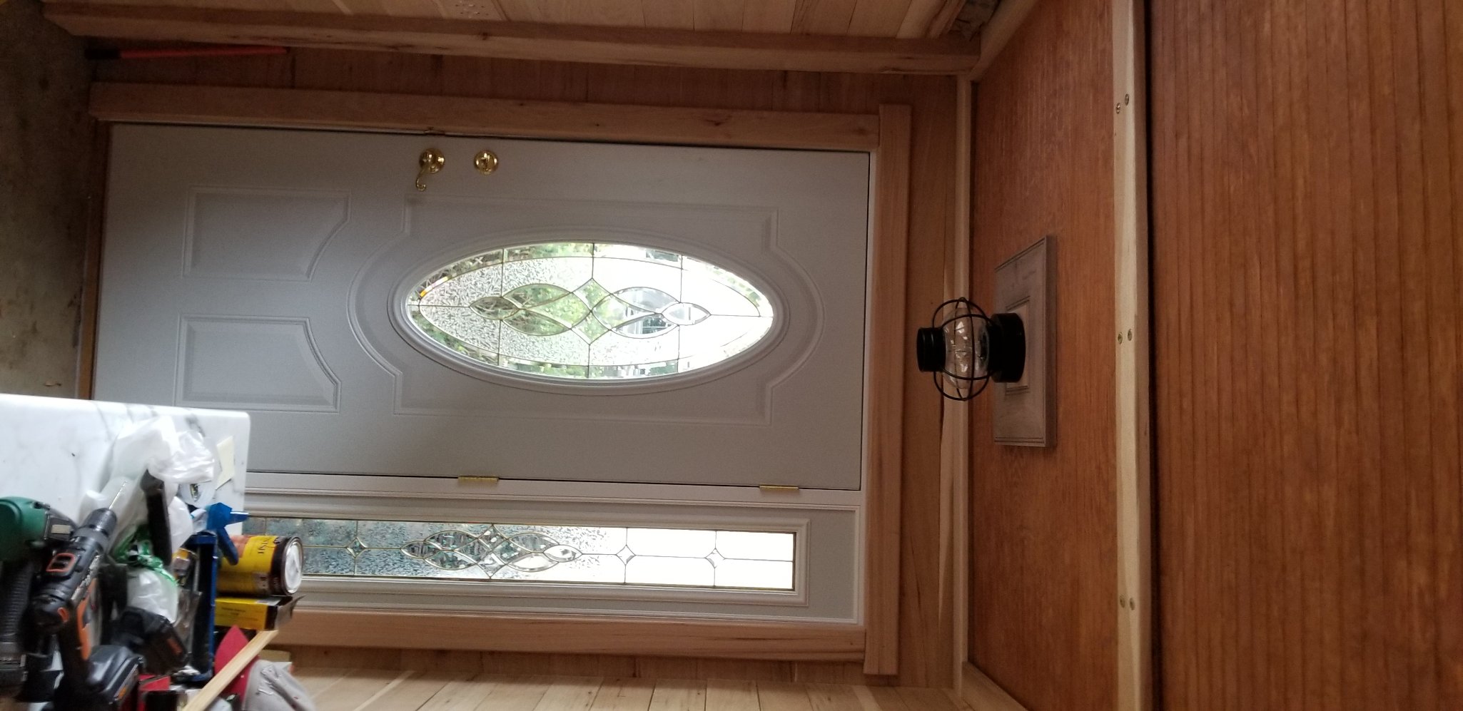

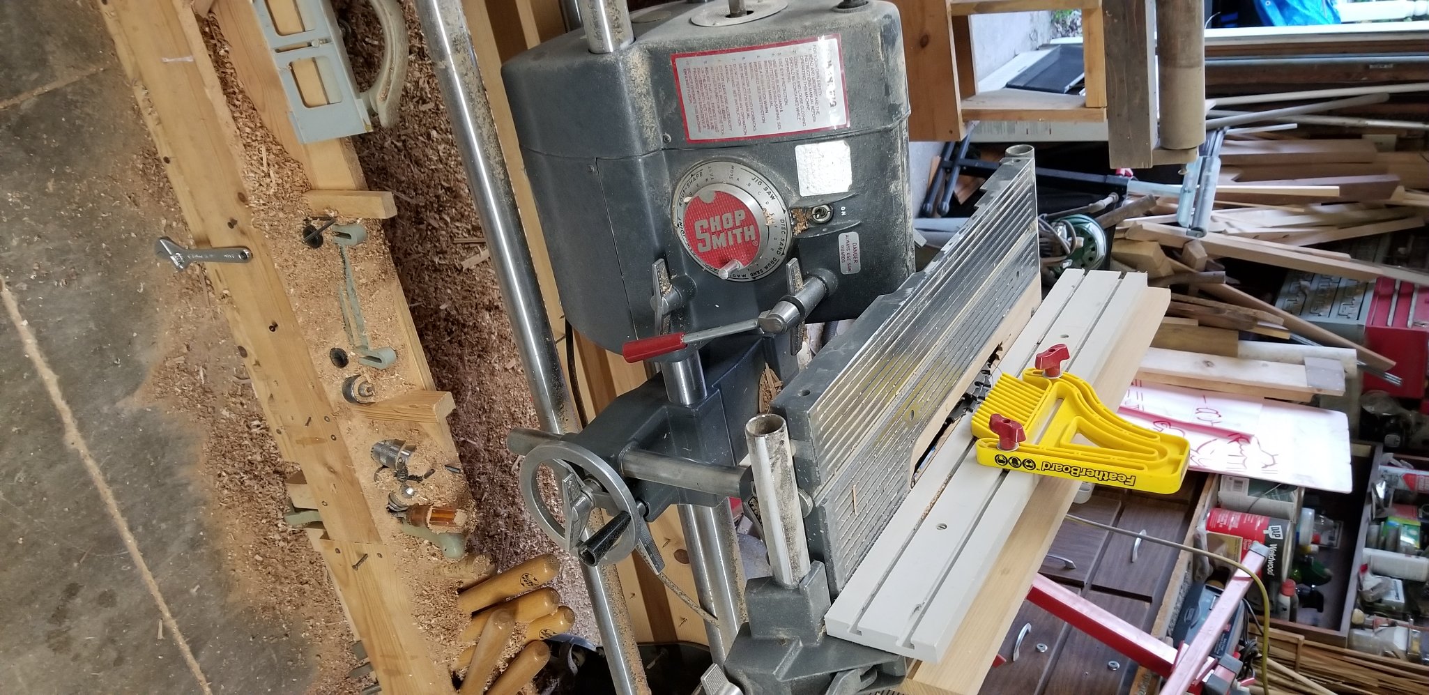

This started a project 2 years ago with a trip to the saw mill and the purchase of a little over 250 bd ft of rough cut Hickory , some 6x6 , some 2x4 and a bunch of 1x? what ever they could get from the log , some was 1/4 sawn some was flat sawn and some was rift sawn, it dried for over a year and 1/2 and took up a lot of garage space during that time. after the porch was finally enclosed and the electric was installed the real work began , about three months ago the wife and I started the interior , one board at a time we cut and prepared each piece of wood , the hickory had to be cut to fit between each hickory post and was rabbited on opposite edges to fit together , we thought about a tong and grove ion the boards but decided to just lap then about 3/4 inch on both edges , the MKV done a excellent job , we even rabbited the edge on the 2x4 hickory beams for the ceiling and the door trim , the MKV once again came through with flying colors, I used every cutter and spacer in the stacked dado set and it did a awesome job . this took us quite a while do to the limits on my health but thats life of a old guy . I had issues with the saw horse table when it came to putting the beads on the light bezels and than I got smart and used the SS and the work station as a bench , here are a few pictures of our progress,

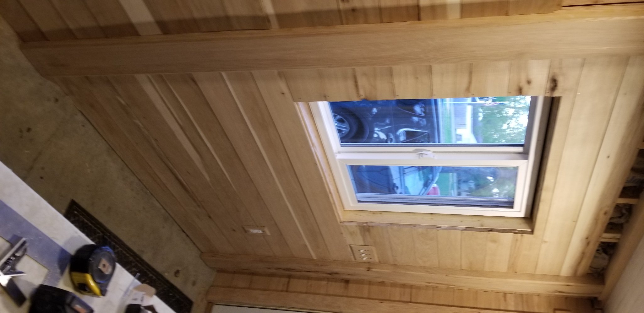

we still have a few nails to put in on the siding to make it all come out even and the floors are yet to be

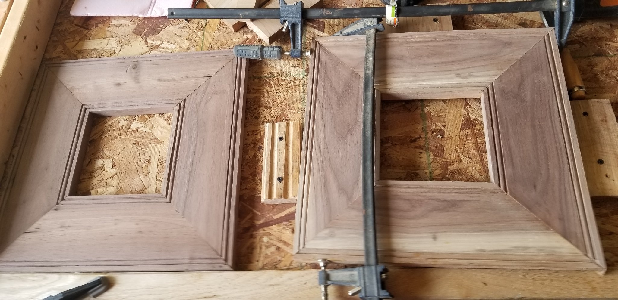

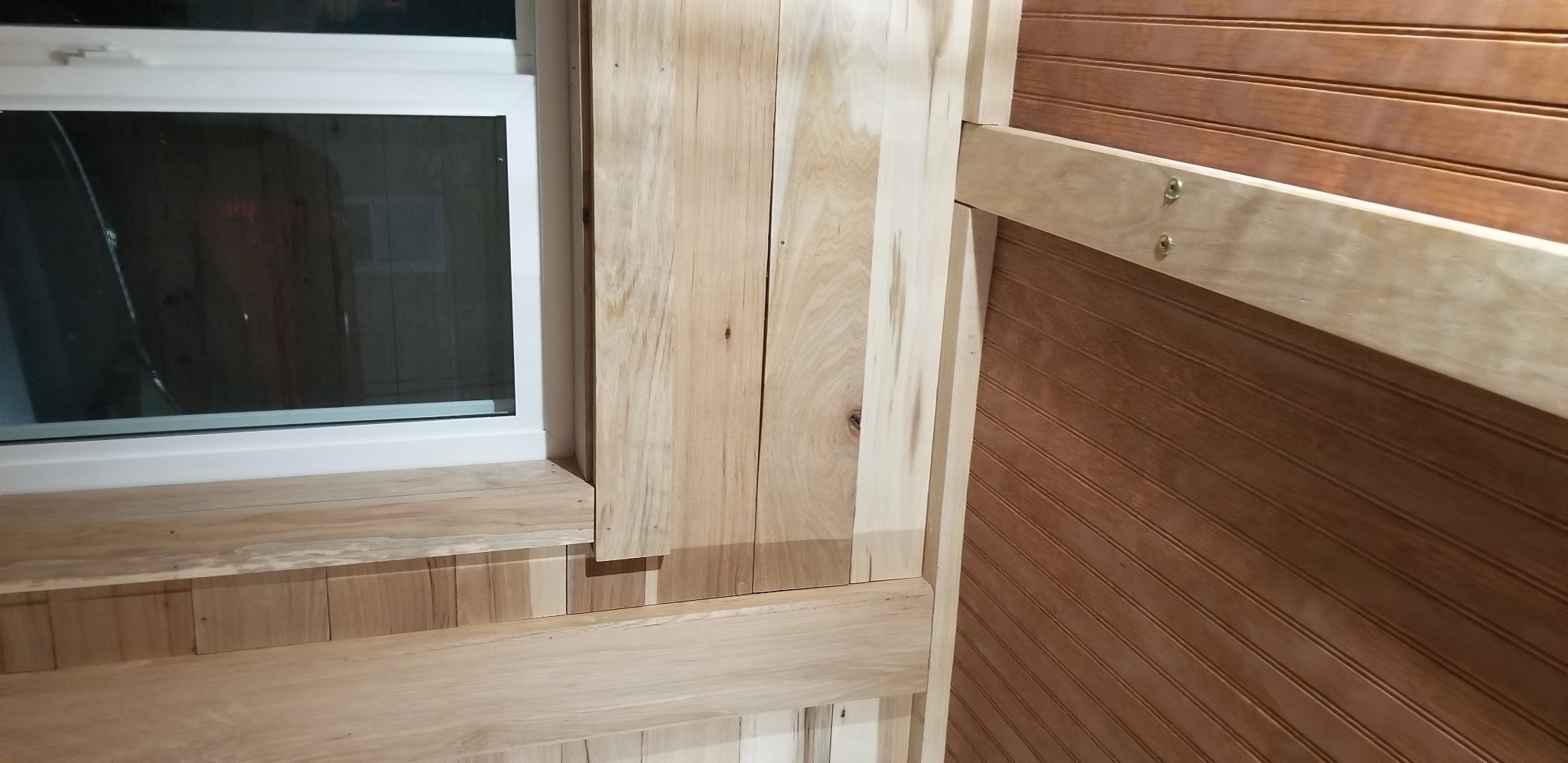

we are now working on walnut trim for the ceiling , making the the beading work by hand with the combination plane is a challenge but getting easier .

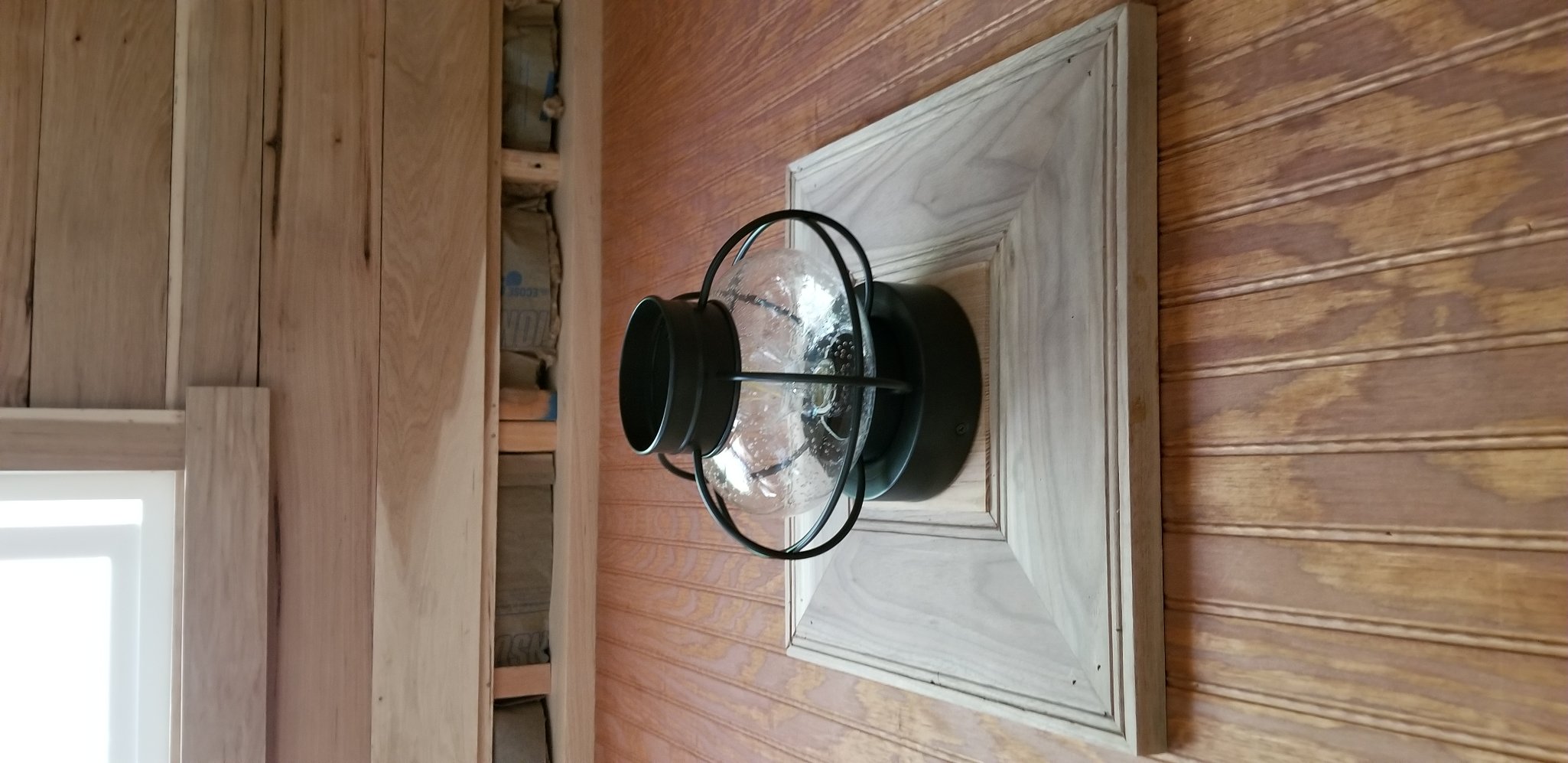

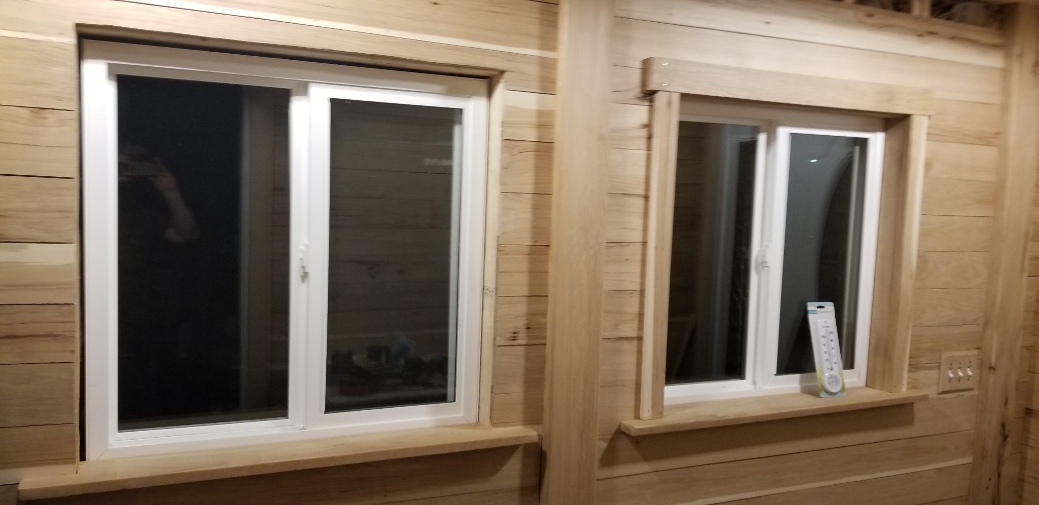

The window sills are made of cherry .

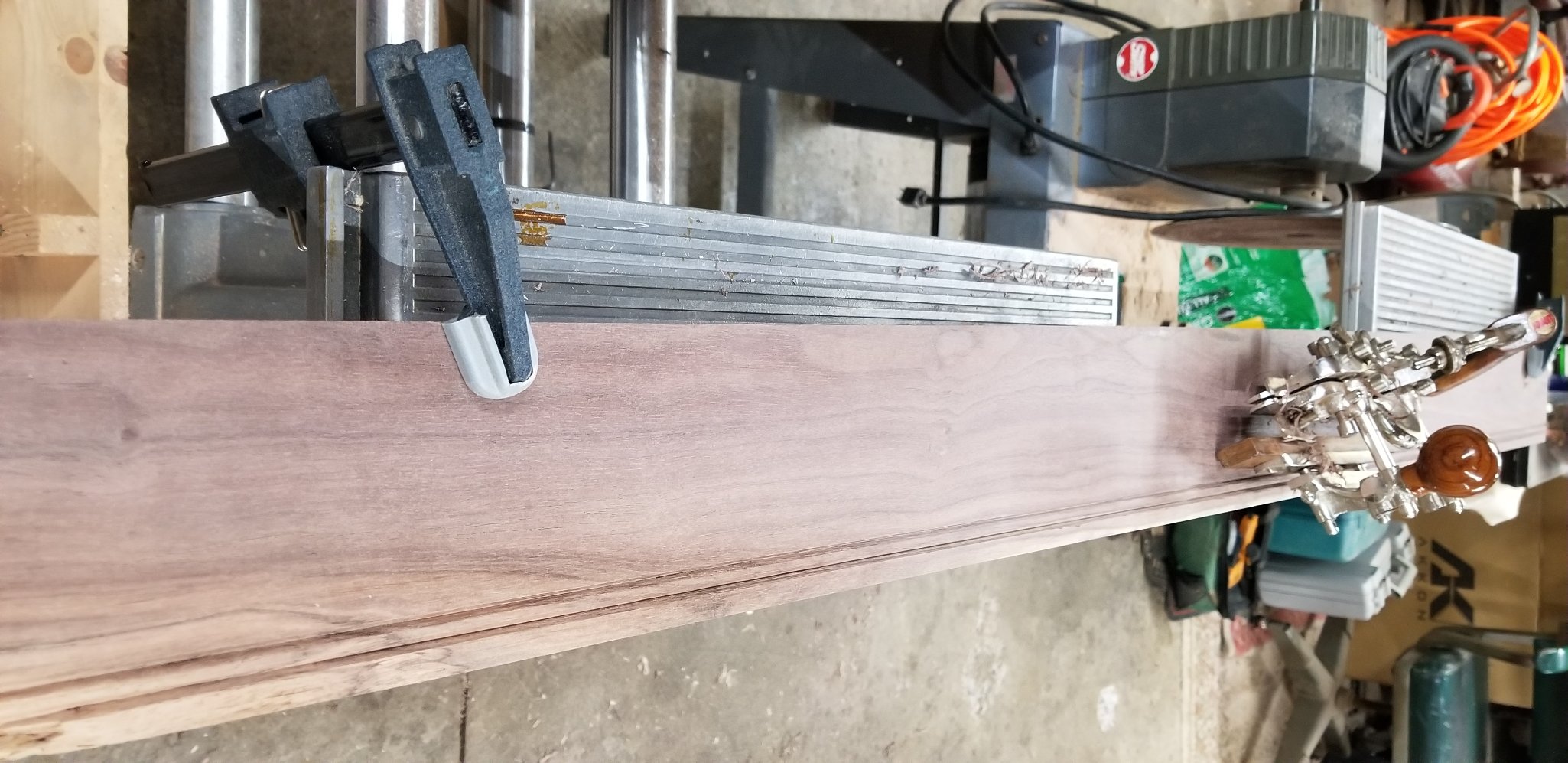

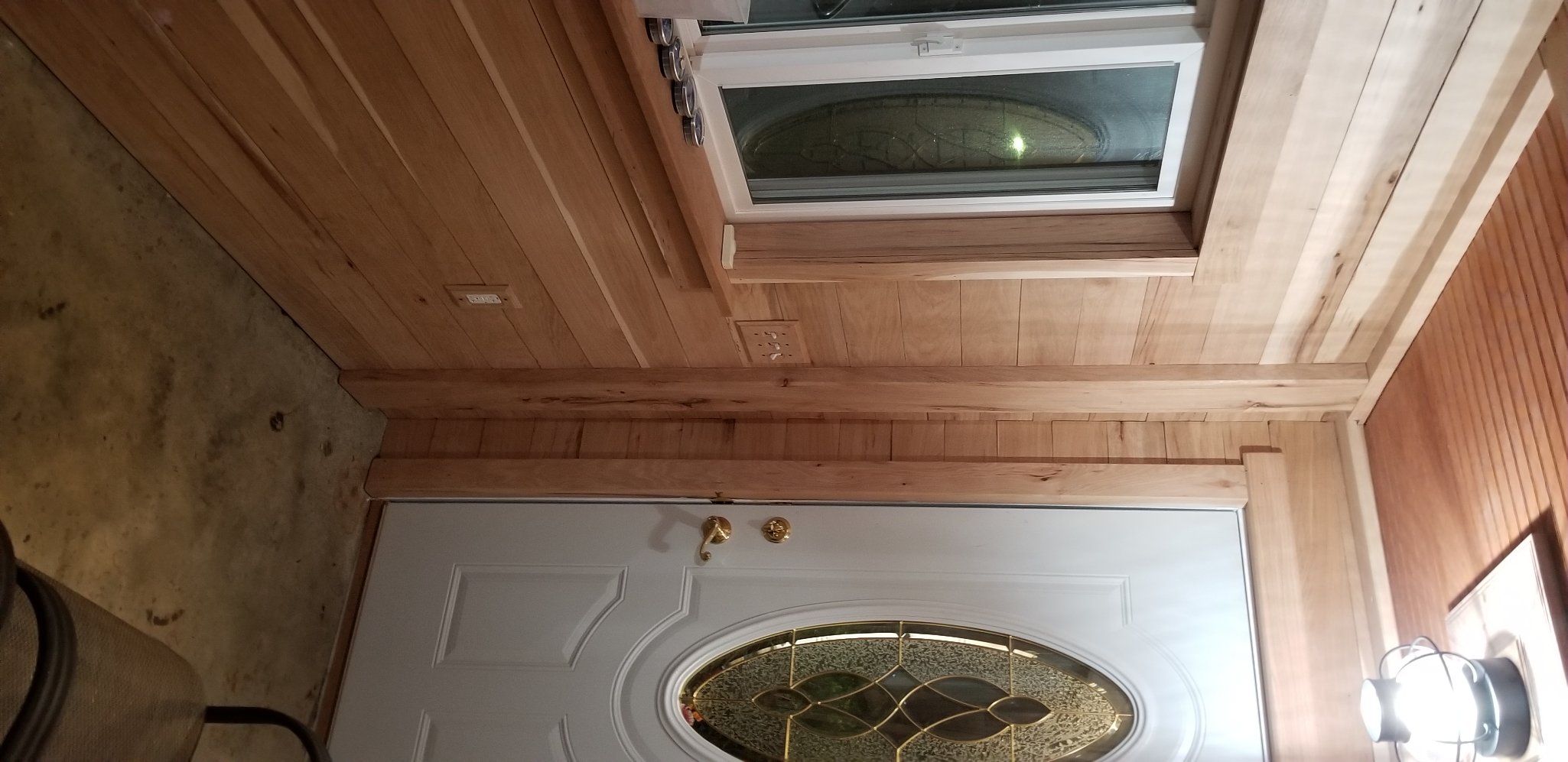

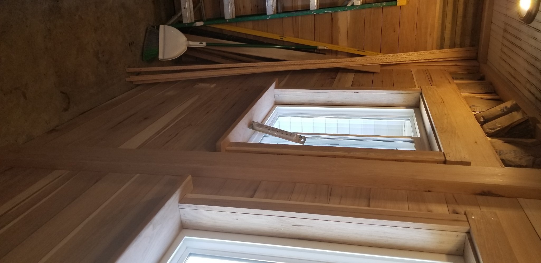

the 2x4 hickory ceiling trim the piece is over 14ft long

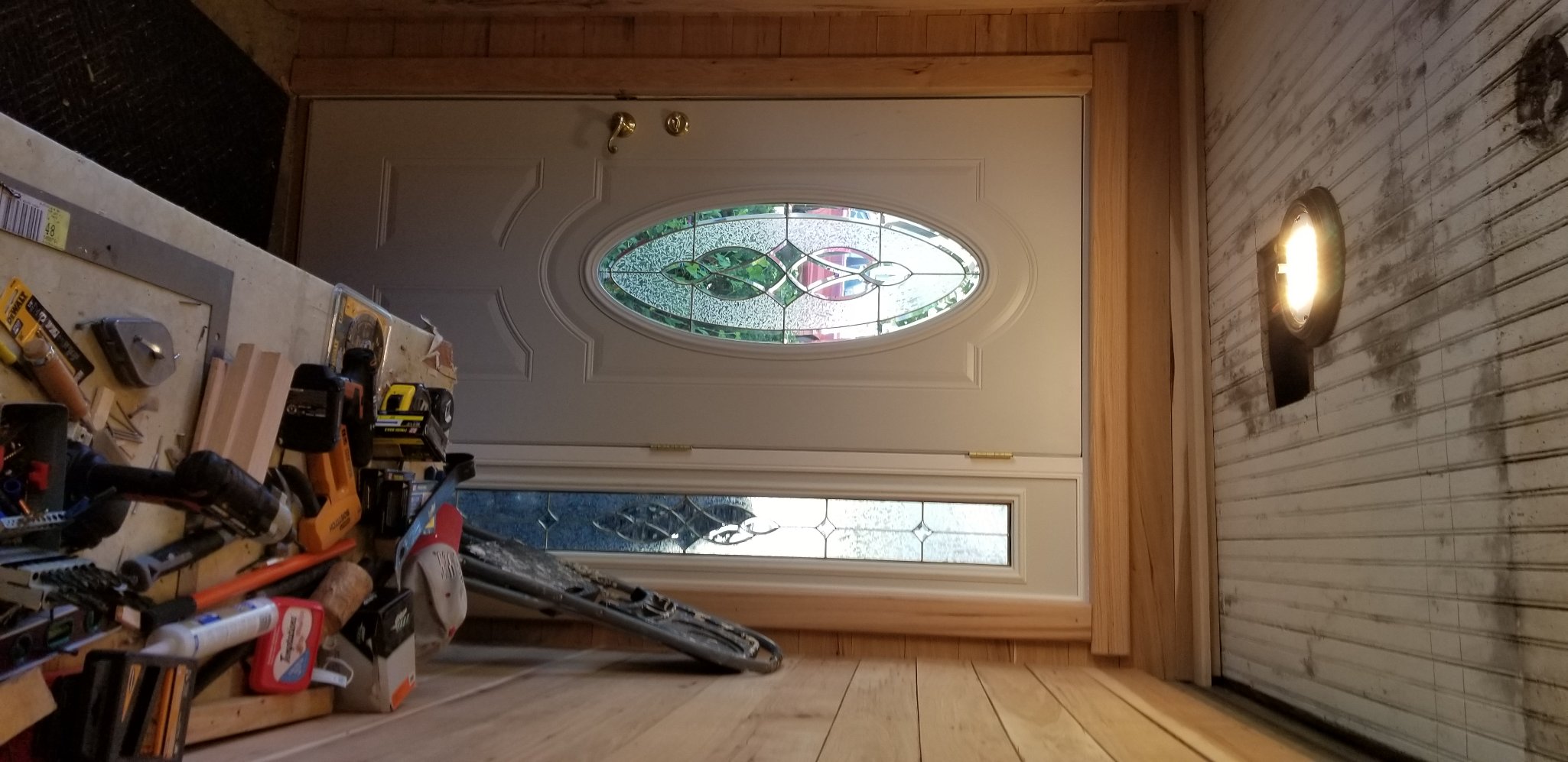

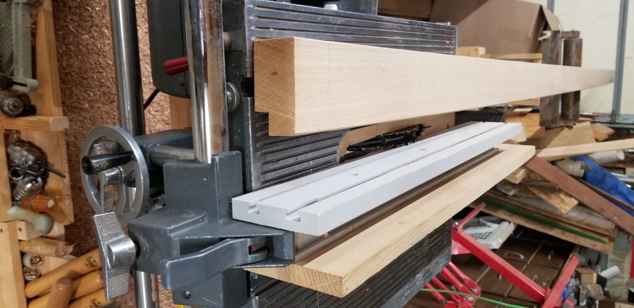

so far we have emptied 8 large garbage cans of sawdust from the planer and the SS to the compost .
