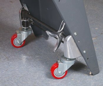

First I would like to make sure we are talking about the same wheels. Below shows the Shopsmith Premium Upgrade Casters mounted.
_ _
Is this the wheels you have?
I don't know of a "shelf life" for the casters. I have one set I put on my Mark about 5 years ago and no problems. I live in Oregon and my tools are in my insulated garage, concrete floor and no heat or air conditioning. Outside temperatures here goes from below freezing to the highest temp I have ever seen here at 116 degrees a few weeks ago. The garage temperature, including the concrete floor, goes up and down with the outside temperature since the garage door is opened at least twice a day. Temperature changes and other conditions could effect the life of the wheels.

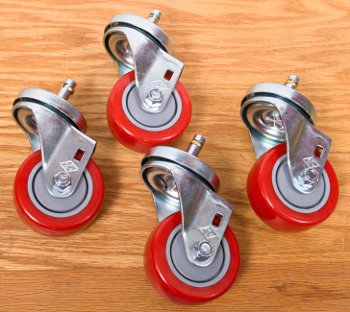

The casters use a standard end to go into the retractable caster assembly. See picture below. There have been other wheels used. You could go back to 2" wheels and even find a set of older type metal wheels like those first used on the Mark 5. Of course it won't roll around as easy. That would require remounting the retractable caster set back to the original holes on the Mark's legs.
_ _
Shopsmith replacement casters are found at the link below.
https://www.shopsmith.com/ownersite/cat ... asters.htm
Standard 2" replacement casters are found at the link below.
https://www.shopsmith.com/ownersite/cat ... caster.htm

To answer your specific question about replacing wheels: Yes. if you have the wheels shown here they can be replaced. Are these the wheels you have?

The stem on the 3" wheel casters is 1-3/8" long while the stem on the 2" wheel casters is 1-5/8" long. A longer stem would not work well in the retractable caster assembly's sleeve since it would leave the excess stem below the bottom of the sleeve adding height to the assembly. The 3" casters "ride" on the base around the stem against the bottom of the sleeve while the original 2" casters "ride" on the top of the stem inside at the top of the sleeve.
I hope this makes sense for getting the correct measurements for a replacement caster.
