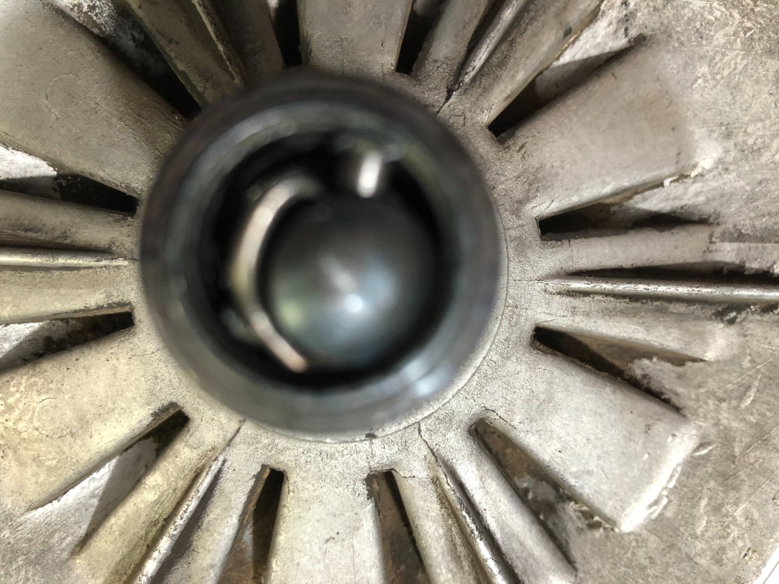

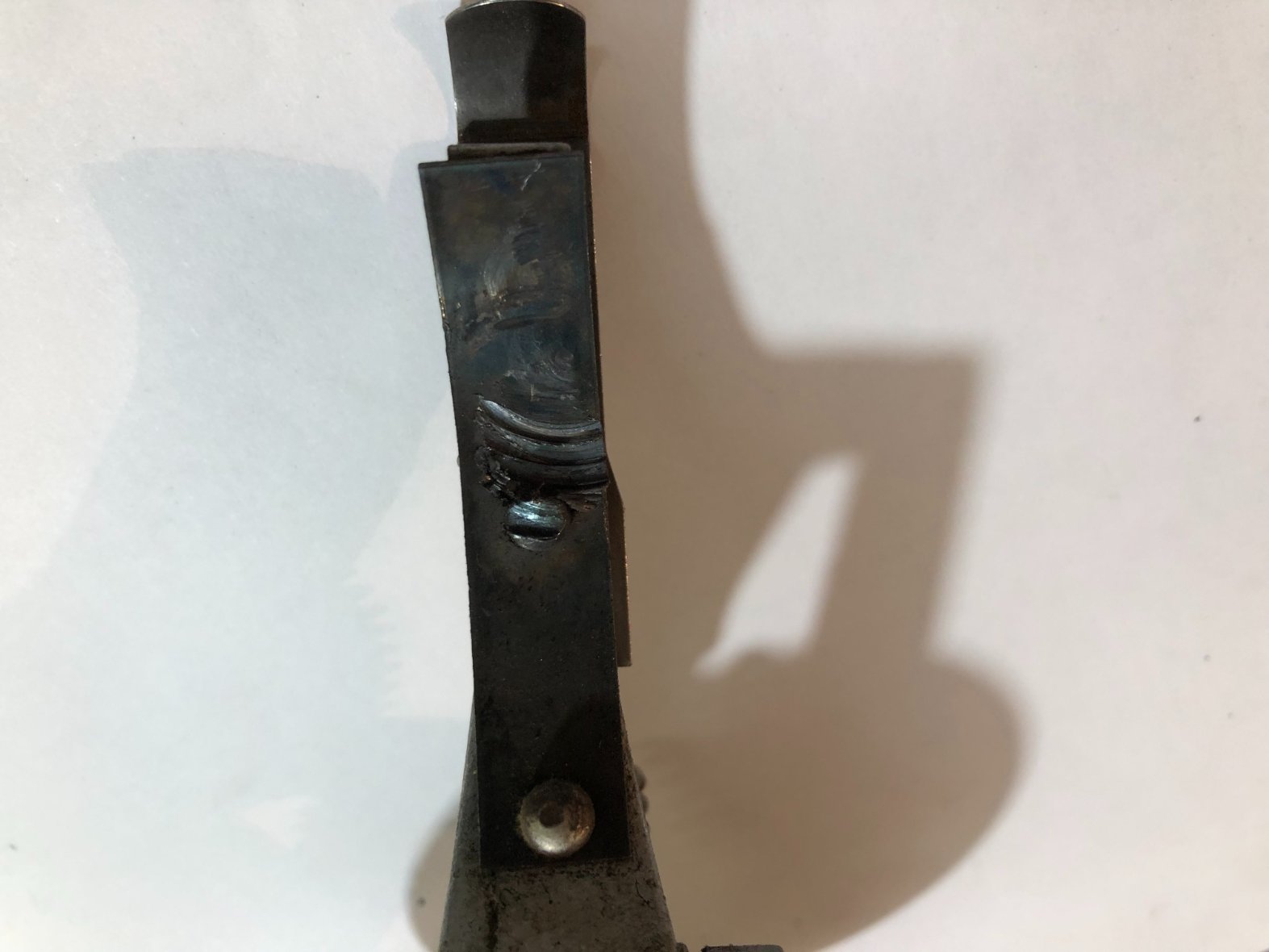

David, Russ and JPG....I am so thankful for your help. While I have some mechanical aptitude this is still a bit challenging. I have attached three photos which may be of benefit if I have in deed attached them properly.
As the piece holding the button bearing in the control sheave seems to be broken I assume that I need to buy a new control sheave assembly. Would you concur? The sheave does seem to slide freely but not sure how difficult it is to replace the button bearing?
Also, I am thinking that I need to buy a new speed control assembly since mine is worn?
The third picture is part of a broken spring. I am going to have to investigate where it came from. It was in the bottom of the pan when I opened it. I think the other spring attaches to the front of the dial indicator. There is also what appears to be part of a bearing that was in the pan. Not sure where if came from.
Any additional thoughts are quite appreciated. Let me know if the photos do not show up or are unclear and I can try again.
Richard

- It appears that the button bearing needs replacement or a new control sheave?
- IMG_0581.jpg (327.31 KiB) Viewed 1499 times

Your picture came through fine this time. The link below may help in understanding how to post pictures.
viewtopic.php?f=7&t=19246
The sheave needs the the button bearing with the wire loop replaced. That's the broken piece from picture 6 at the bottom. You can try either getting the button bearing with the wire loop (non-OEM) or replace the Sheave assembly. My other concern there is how much has the end where the button bearing goes been worn down rubbing directly on the damaged area of the Quadrant Assembly. In that same picture the other wire spring part goes behind the Speed Control Dial and still looks okay. The Quadrant Assembly aka "pork chop" has a lot of wear from the sheave rubbing directly against it. I agree it should be replaced. If the rest of the Speed Control Assembly is in good shape you can replace just the pork chop. The pork chop is held in place by a roll pin but when reassembled others have used a machine screw and lock nut instead.
