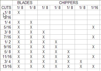

About 6 years ago I was bored and wasn't able to get in the shop just like now.... I had been doing some dado's the summer before and had to do a lot of "fitting".
I have both a wobble and stacked dado set. The summers project had me using the stacked dado and I was trying to get some odd sized dado's. I have the plastic shims for adjusting the stacked dado, but it seemed to take me a while to get to the result I wanted trying to figure out what parts I needed to put together and what shims I needed either for the initial setup or for adjustments later.

OK then I first did a very simple table for my dado blade. It looks like this:
[ATTACH]3085[/ATTACH]
I know I know everyone can do this in there head but still it was a starting point.

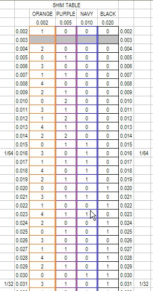

What I did next was to build a shim table. Well to tell the truth two of them, just a bit of different format difference between them. These table are much larger then I can show in an image any have be able to read them so this is only a sample of each. They go from .002 to about 1/32" but the real tables go to .138". They are dumb tables just telling you about shims and don't take into account logical places where you might want to change shims for cutters... but I think you will see that if and when you get to see the whole table.
Now before I post these let's look at an example that you can use the charts for. Say you have some wood that you run though your planner and for some reason when you check them they are not 1/2" like you thought but rather 1/32" oversize. The closest that the dado set can get you is either 1/2" or 9/16" (1/16" chipper). At this point you grab the box of shims and start trying to figure out how to add 1/32". Sure you can do the math but what if you simply went to a chart and picked out 3 oranges, 1 purple and one black or shims that added up to 1/32"mmmmmm?
I know some of you will hate the small number and some of you already have other ways of doing this but how much interest is there in having me try to come up with a way of posting this information? I don't want to go to the trouble of messing with it if no one wants it anyway. And would you like them both or ???

OK I can see the tables didn't show up right... the decimal places for the different colors like say orange is .002", purple is .005, navy .010 and black at .020. The spread sheet has them right but when I moved them to open office they lost formatting. I'll fix that later.

I just went to lay down and then it occurred to me that someone might be thinking hey he said if I set up for a dado of x/y" with those shims I will get these cuts down to .001". Sorry it unlikely that this is going to work that way. In fact depending on your blade set you might find the combination of chippers and blades may not come out as close to a size as you would like. Trial cuts are needed... the cut comes out say off my .010" putting or taking out .010" shims still may not get you to that perfect cut. These are only guide lines you will have to tweak from there.
How close to you have to be? That all depends. If it is a drawer back for in your shop maybe not so close. But say you have some cabinet fronts for your living room and you want to inlay some contrasting wood, I don't think you will impress many people if the dado is 1/32" larger then the insert... yea that might be a redo.
Now I don't have one of those expensive sets so maybe they do better at sizing them but a little testing never hurts.
So everyone got that... using these table will not necessary provide you the dimensions for a perfect fit... they will however be worth every cent you pay for them.
