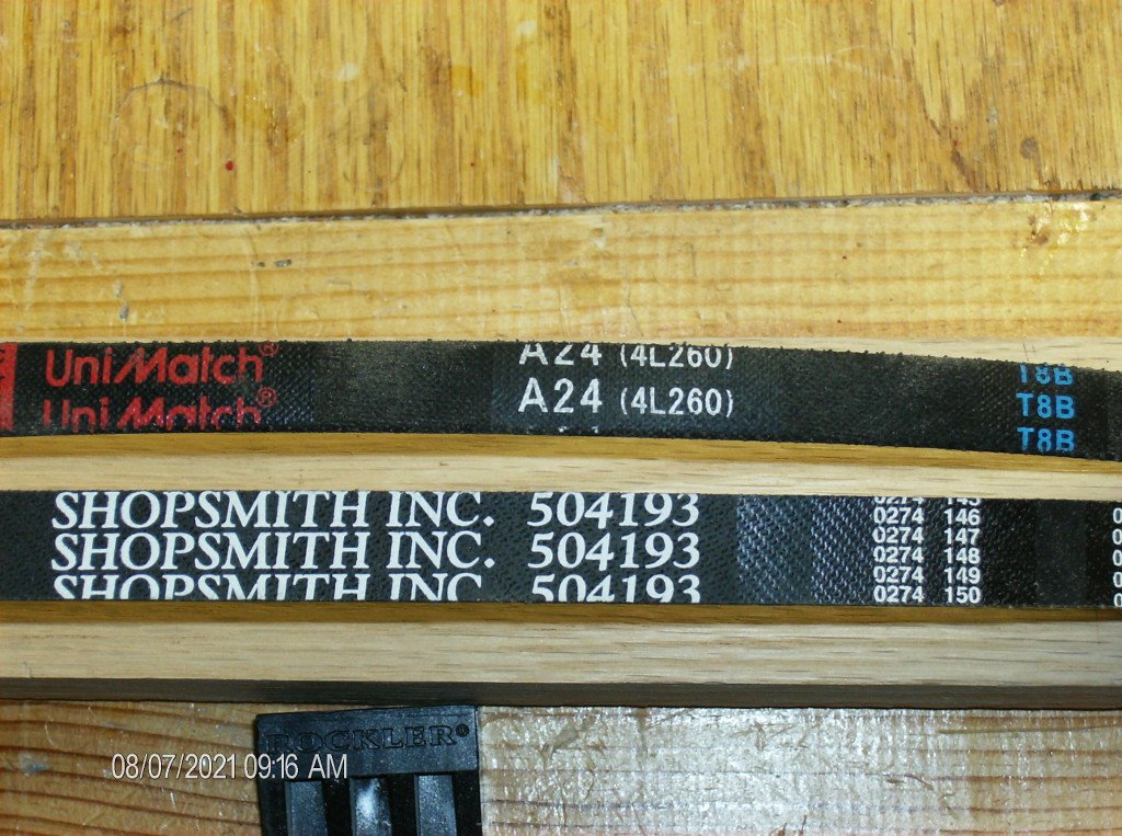

According to Marc's measurements the new belt is 0.465" wide, many of us replace the belt if it measures below 0.5" because the speeds will be wrong. If that measurement is correct this one is bad out of the box. Also this is a 26" belt while the design calls for a 26.5" belt. The 1/2" increments are no longer available as 'standard' and most 'standard' 1/2" belts are narrower than 1/2". SS belts are unique, no longer standard. That's the whole point of others in this thread suggesting buying from SS, so the belts will fit correctly. Experience has already determined that standard belt sizes are not okay as replacements.

Is there a spec somewhere that defines the belt dimension to be 1/2" x 26 1/2" or is this a dimension that we (the users) have come to expect.
As for the speed being wrong - isn't that why the speed is variable? If you set the speed dial at "R", what is the anticipated RPM (+/- what)?

How quickly thee forget. It is short! It is narrow. It is not made to original specifications from 1950's.
Past experience with off the shelf belts failed.
Using SS belts was recommended since that previous disaster was corrected. SURPRISE! - disaster is being repeated.
As for +/-speeds, ok as long as thee are not near the ends of the range.(near the center of the movable sheave pulley(s)).
P.S. "apparently working" and "working correctly" are seldom equivalent.

It looks like Shopsmith supplies 4L260 standard size belts when they don't have their own in stock. The 4L260 will work, but the different width should change the speeds somewhat from the Shopsmith wider belts.
I checked my spare belts. I have one from Shopsmith, and a generic 4L260 spare on hand. The brand of 4L260 I have is slightly narrower than 1/2" while the Shopsmith one is a bit wider than 1/2".
I use the Shopsmith original size whenever possible, but I keep a spare 4L260 on hand in case of an emergency.

It must be mentioned that the reason for letters on the speed indicator dial is intentionally vague(letters rather than numbers[rpm] is because the reeves drive is not concise. So a slightly 'off spec' belt will work, but that introduces an additional variant as is belt wear over time.
The effect of a worn belt is similar to that of a new belt that is narrow.
However the reduced length of the belt has a more serious effect. The shorter belt will cause the belt to run closer to the point at which the narrow belt will get jammed in between the 'vanes' on the sheaves.
So the combined effect of both narrow and short will shorten the length of useful life the belt will provide.
Recently there have been 1/2" belt length belts commonly available.
Today's "1/2 inch" belts appear to be 12 mm belts.
