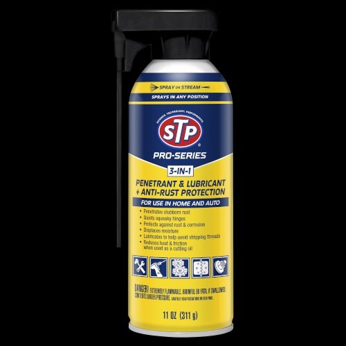

There once was a discussion about using bee's wax. I gave it a try and it seemed fine until it got colder, then it got about as hard as a soft rock and I ended up chipping it off one cold day in the shop when I wanted to use my shopsmith. I do not recommend that for any one living in a colder climate.
What I do love is STP, yea the one that you can put in your car. I started using it on a upside down router(table mounted) that I had to keep taking apart to keep it moving up and down smoothly. Once I started using STP that went away.
The STP does get sawdust in it but a tooth brush removes it extremely easily and quickly, it stays soft and doesn't cake up. And of course the controls move nicely between times.

Ed,
Is this the STP product you are using? When I think of STP, I think of fuel or oil additives. Didn't know they made a lubricant.
📶RF Guy
Re: Speed control lube
I didn't know they made that lubricate..... I use the stuff that is added to the oil. The bottle is maybe a pint and I'm sure it will be a lifetime supply.
