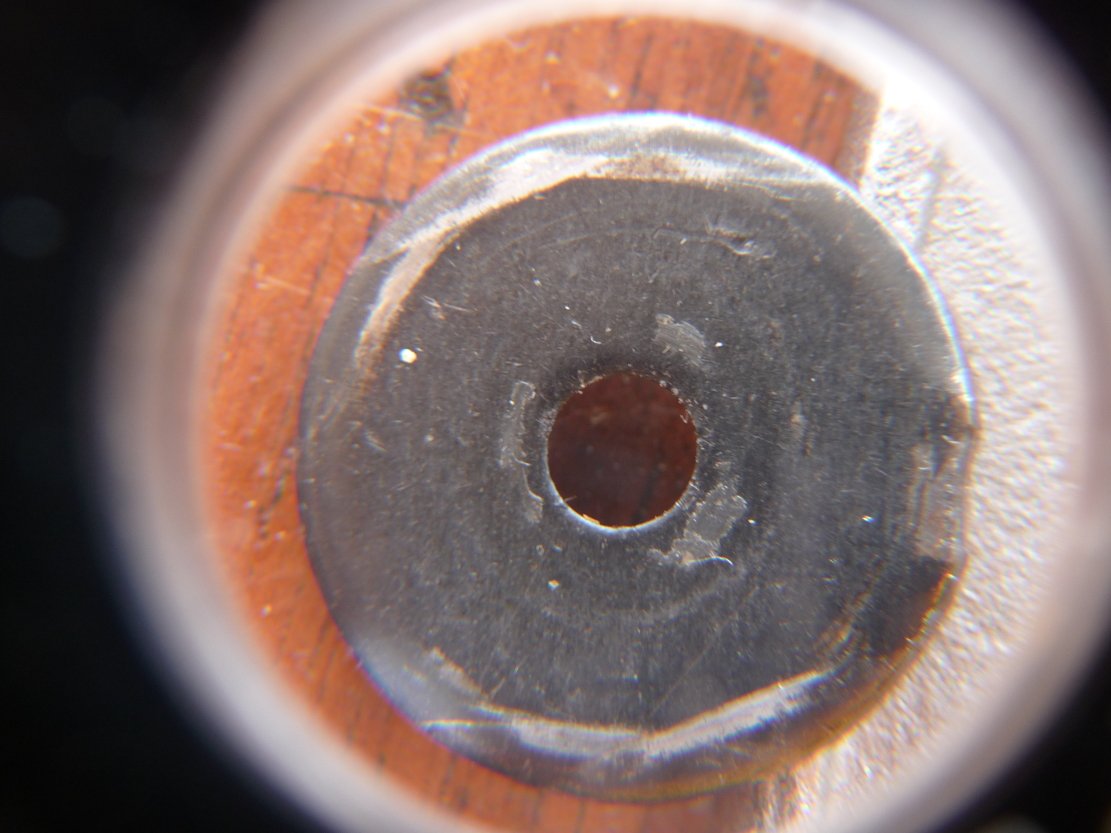

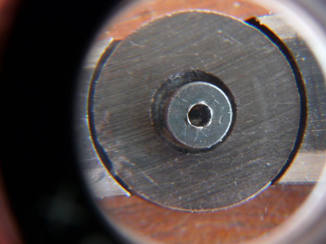

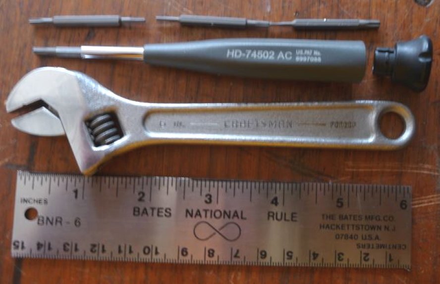

I tried removing the washer from mine today to use it on my cast iron bandsaw. I couldn't find an Allen wrench to fit although I have almost every size imaginable. On close assisted viewing I discovered the po had aggressively rounded out that tiny octagon. So I let it soak in WD40 for abut a hour, got a small torx screwdriver and forced it down into the hold. Using an adjustable spanner I slowly i\unscrewed it. Perhaps this may help someone down the line.

Great idea! Did the Torx survive the operation?

The torx did quite well. I bought this several years ago for something and have used only a few times. But it was there when I needed it.
