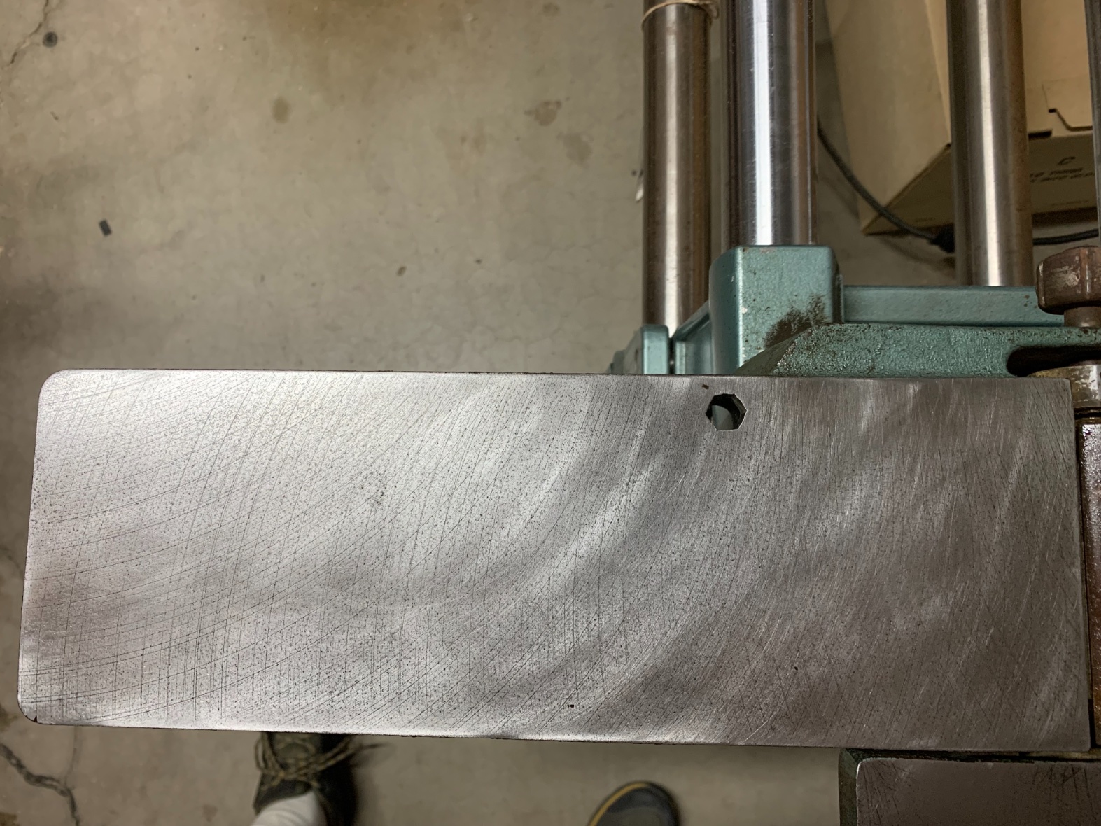

I’m cleaning up my jointer’s bed and fence and after removing a lot of the heavy rust using Scott Markwood’s method, with a green Scotch-brite and WD-40, I’ve found some pitting and deep scratches from what looks like a course sanding disk. Because there was still significant rust left, plus the small pits and deep scratches, I switched to medium Emory cloth, wrapped around a 2”x2”x5” scrap, to see if I could smooth them out a little. After maybe an hour of work the rust was gone, and some of the pits and smaller sanding disk scratches were smoothed out a little bit. I then switched to 400 grit wet/dry sand paper and WD-40, to remove the Emory cloth scratches. But there remains a lot of small pits and the deeper sanding disk scratches.
I began to be concerned about taking too much off, and sanding too unevenly across the bed of the jointer. I checked for flatness with the long leg of a large construction square laying on the jointer bed and saw a few spots where light shows through, so it looks to me like the jointer bed is not completely flat. I don’t know if it was me or the previous cleanup that caused this, but I was careful to wrap my sandpaper around a very flat board and did not linger too long in any one spot.
My questions are, how flat does the jointer table need to be. And, if it does matter, how would you flatten the bed? What are your thoughts?

A closer shot of the infeed table.
Infeed Table, with scratches and small pits

A closer shot of the outfeed table.
Outfeed Table, with scratches and small pits

Those tables now look tremendously better!
I believe that the “deep scratches” are actually machining marks from the original factory flattening process, known as “Blanchard grinding”. The brief video below shows the process and resulting finish.
On machine wear surfaces, having machining marks visible is usually considered a good thing, as a lack of them may indicate excessive wear.
It’s dangerous to use a jointer for a too-short workpiece. I forget the recommended minimum length for a Shopsmith, but it’s on the order of a foot, and is equal to the distance between the two bumps atop the jointer fence. As long as a workpiece of that minimum length easily bridges any low spots, they shouldn’t affect accuracy.
The small rust pits are strictly a cosmetic issue, except that rust likes to re-form in them. To prevent that once and for all, apply Penetrol generously to the entire surface, rubbing it well into the pits, and then wipe off the excess. Let it dry for a day or three. Then clean the Penetrol off of the top surface with mineral spirits, but not so aggressively as to clean it out of the pits. Finally top-coat with JPW (Johnson’s Original Paste Wax) or equivalent, and it’s good to go.

IMHO you should stop smoothing now. The pits don't matter as long as you've softened their edges and they don't catch on wood. Flatness is the most important aspect of a joiner table but small pits and scratches don't count. It's flatness on the macro level that matters, not on the micro level. Get a good enough microscope and you'll see that metal actually looks like the surface of the moon.

I think Dennis and Ed have your questions pretty well covered. The only way now to restore the surface of the infeed and base/outfeed tables to like new would be to have them reground as a set. That is how they are done at the factory, It is also why you want to buy them in pairs and not individual parts. Putting a infeed table, for example, from another Jointer may give you an out of alignment table set. It can be corrected but it is a pain. One final check for your infeed and base/outfeed tables would be alignment. With a flat edge at least the length of the tables check to see that the two are flat to each other from end to end both on the front and back edges. If they are not you will not be able to produce a true flat edge on stock.
When reassembling the tables clean up the points on both the infeed and the base/outfeed tables where they slide on each other and give them a good waxing too. It will protect those bare metal contact points while lubricating them too. Also when painting them keep paint off those contact points. If you had to remove paint from those contact points and it also removes any metal you could change the alignment between the tables.
