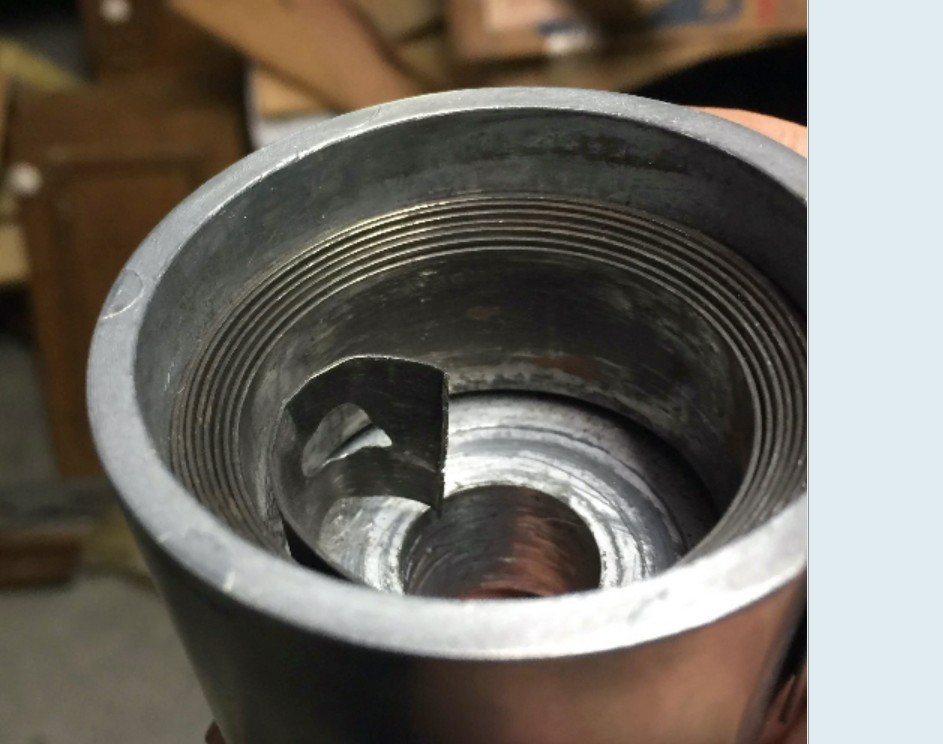

so looking further I am wondering if something is wrong with my quill spring as in a previous post... here is the pix there.

shopsmith sells a 521875 Quill Housing w/Spring ... $33.37.
if my spring looks funky, is this what I need.

- quill spring.jpg (87.94 KiB) Viewed 3161 times

Is that a photo of your spring?

no that was from another thread....I haven't the nerve yet to take mine apart, probably tomorrow

I suspect your spring has just come loose from the screw (41) that holds it to the shaft (43). If you look at your photo of the spring, you see that oblong hole, it just fits over the screw, which is actually not screwed all the way down to the shaft. The hole in the spring just catches onto the screw and the spring tension holds it in place. That is why you never want to let the spring become completely untensioned (I know this from experience). When you take the spring housing and shaft loose, don’t take it apart. You can use a small straight screwdriver to push the spring down onto the shaft as you turn and catch that hole. Maintain some tension, and put it back together.
