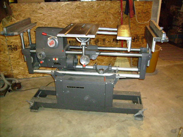

Re: Turning Bowls in a Wheelchair/Powerchair
Shopsmith sells a Deputy kit that might be worth looking at for ideas. They mount on a base you design so both height and leg/base placement could be done to your advantage. You would not have to purchase the kit but just it as a base of discussion.
https://www.shopsmith.com/ownersite/cat ... deputy.htm
A second idea would be a base along the lines of the old mark VII.
download/file.php?id=16073
Anyone know if a mark 5 can just be put on the base of a mark VII? If not then one could make something pretty much like this without too much effort I would think.
