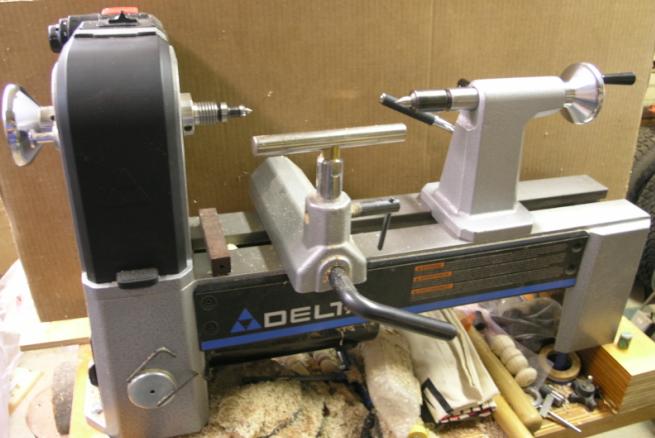

Here is the tailstock on the Delta.
[ATTACH]13215[/ATTACH]

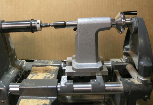

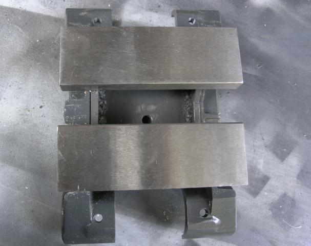

Here is a photo of the way adapter allowing use of the Delta tailstock on the SS510.
[ATTACH]13216[/ATTACH]
A photo with the tailstock mounted on the Shopsmith.
[ATTACH]13217[/ATTACH]

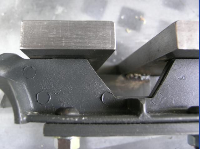

Another view:
[ATTACH]13218[/ATTACH]

I used a tie down lock to secure the new assembly to the original SS ways.
Another view:

I wanted to come up with a way to make the tail stock on my Delta 46-460 lathe interchangable for use on a SS 510.

The first step involved preparing the new way sections. I ordered a one foot piece of 5/8" x 2" tool steel and used a metal cutting band saw to cut the metal in half lengthwise. This probably could be done with a hack saw but I would not attempt it.
Next, I made sure the SS head stock and tail stock centers were in alignment then mounted the Delta tail stock between centers on the shopsmith. This was and attempt to trim the new tail stock mount and to eliminate any pitch or yaw while keeping the head and tailstock centers in alignment. Here is a photo of the Delta tail stock mounted between centers.
[ATTACH]13224[/ATTACH]
The tube holes on the hold downs were cut off to allow them to fit over the SS ways. These were placed on the ways and the hanging Delta tail stock with the new ways was used to mark where the hold downs needed to be cut off. I cut just a bit extra off so the new ways would sit on a 1/4 plate frame that would be made to support the new ways. An appropriate sized piece of 1/4" plate was cut and bolted to the SS hold downs.
