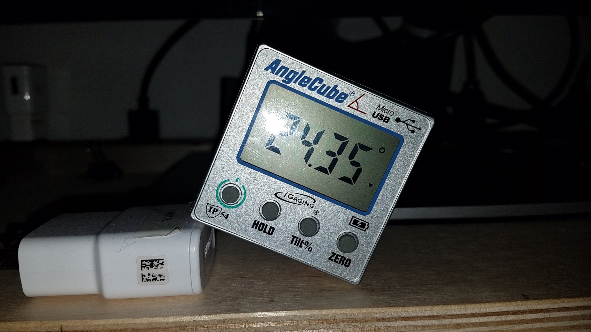

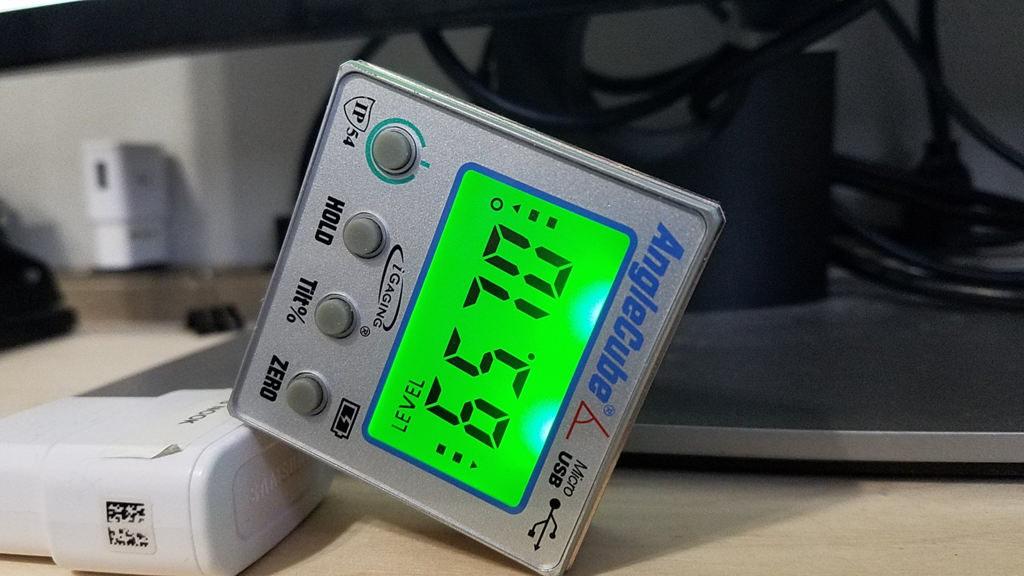

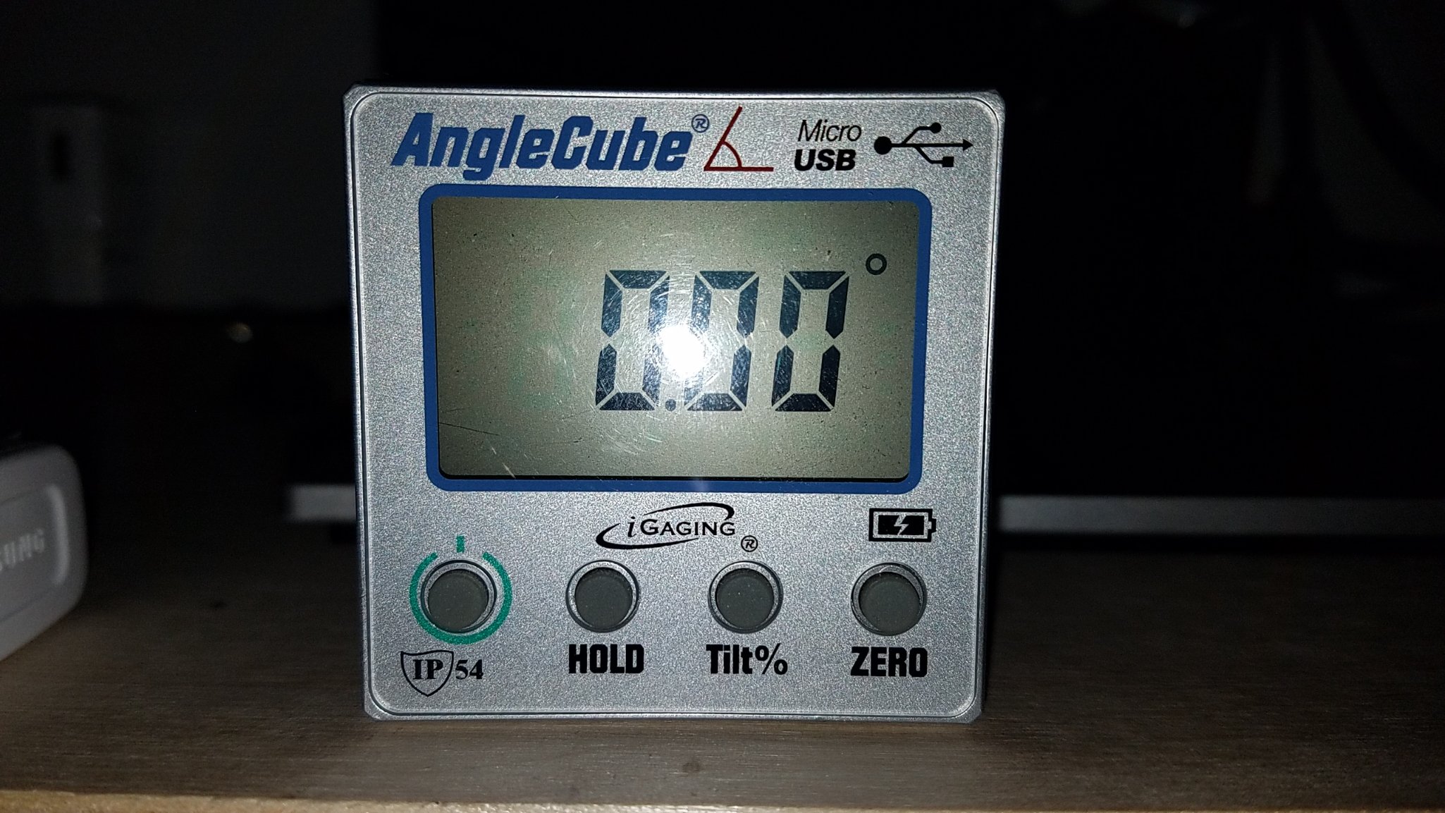

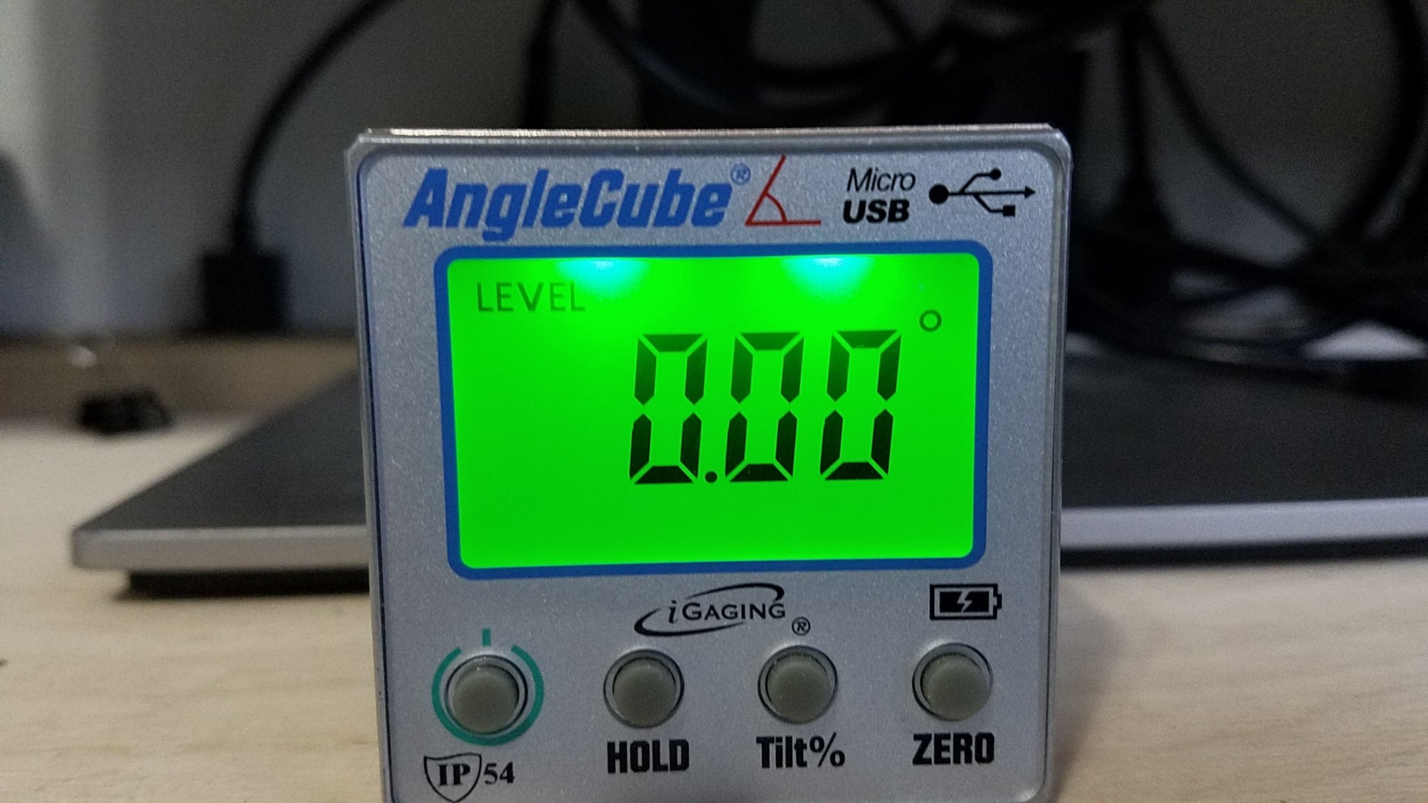

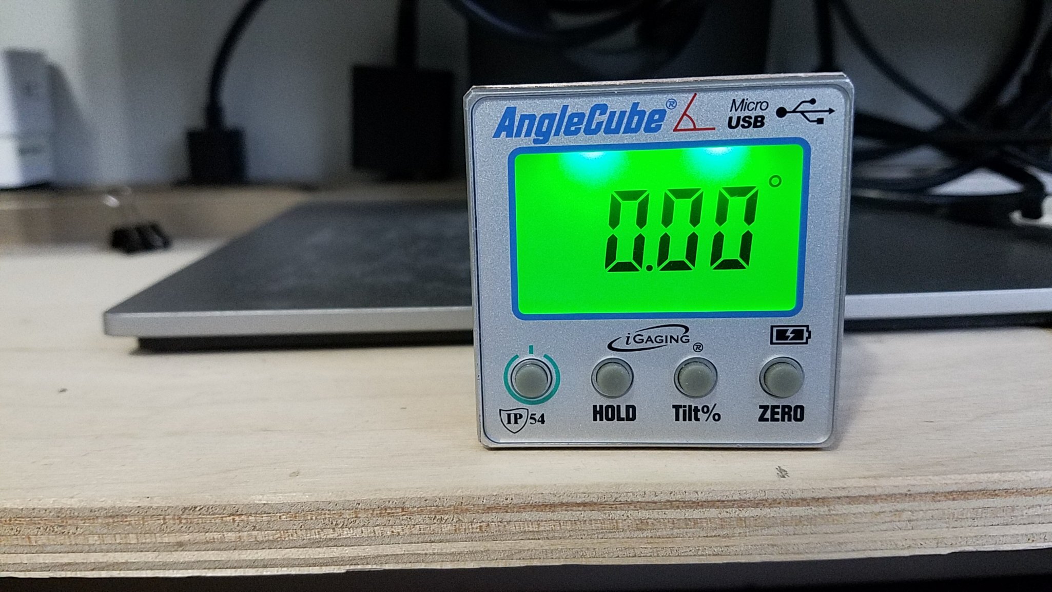

I use my IGaging AngleCube for many uses both in and out of the shop. It is a powerful little tool but one must get use to some idiosyncrasies to avoid frustration.
As a starter - a couple images of my AngleCube.
Zero It
Zero It
Tilt Right and Notice Arrows
Tilt Left and Notice Arrows
Tilted 90 Degrees  Notice No Arrows (neither side is up or down)
Tilt Even Further (Over Rotate if you will) and Note the Arrows.  ALSO: Note Display is Inverted. Gone Past 90!

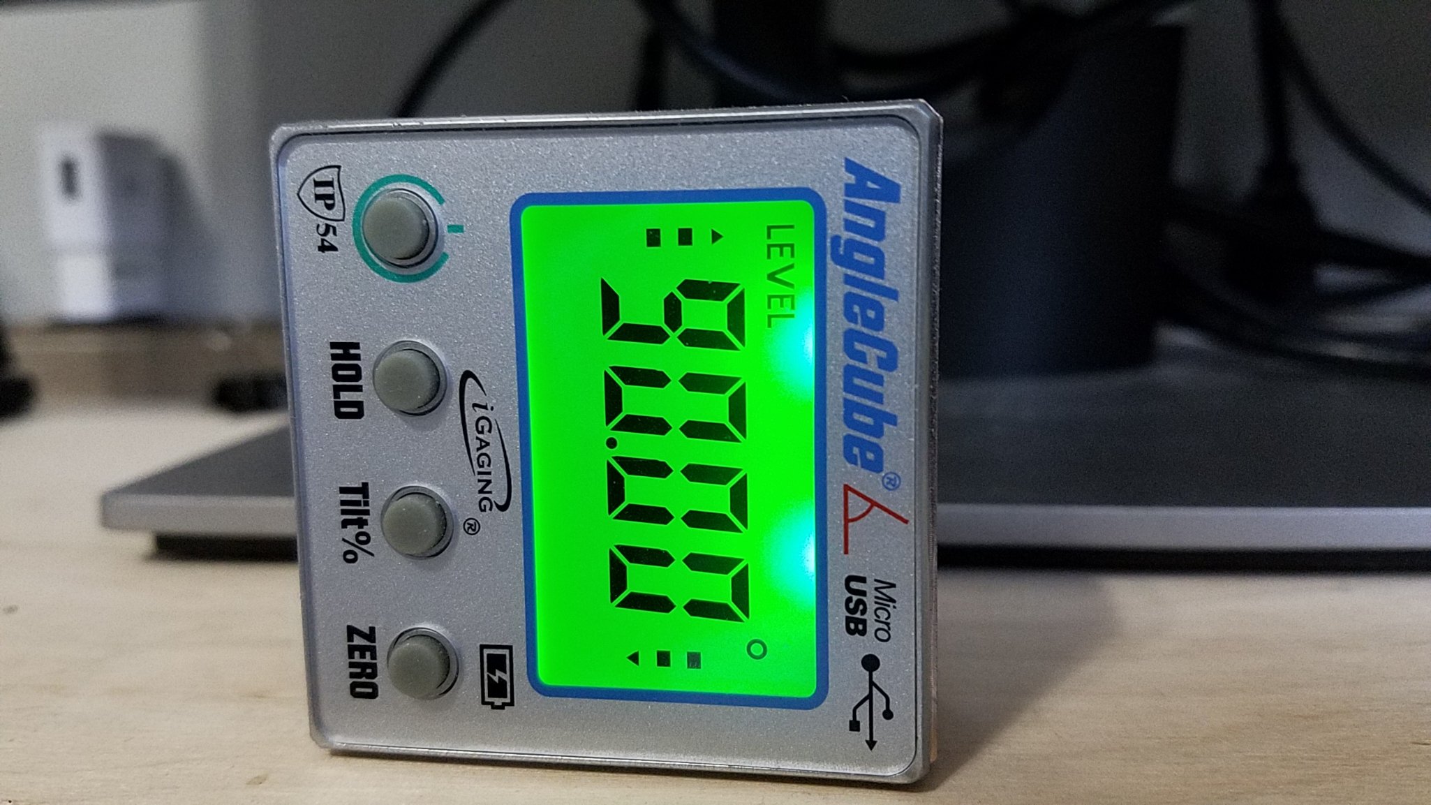

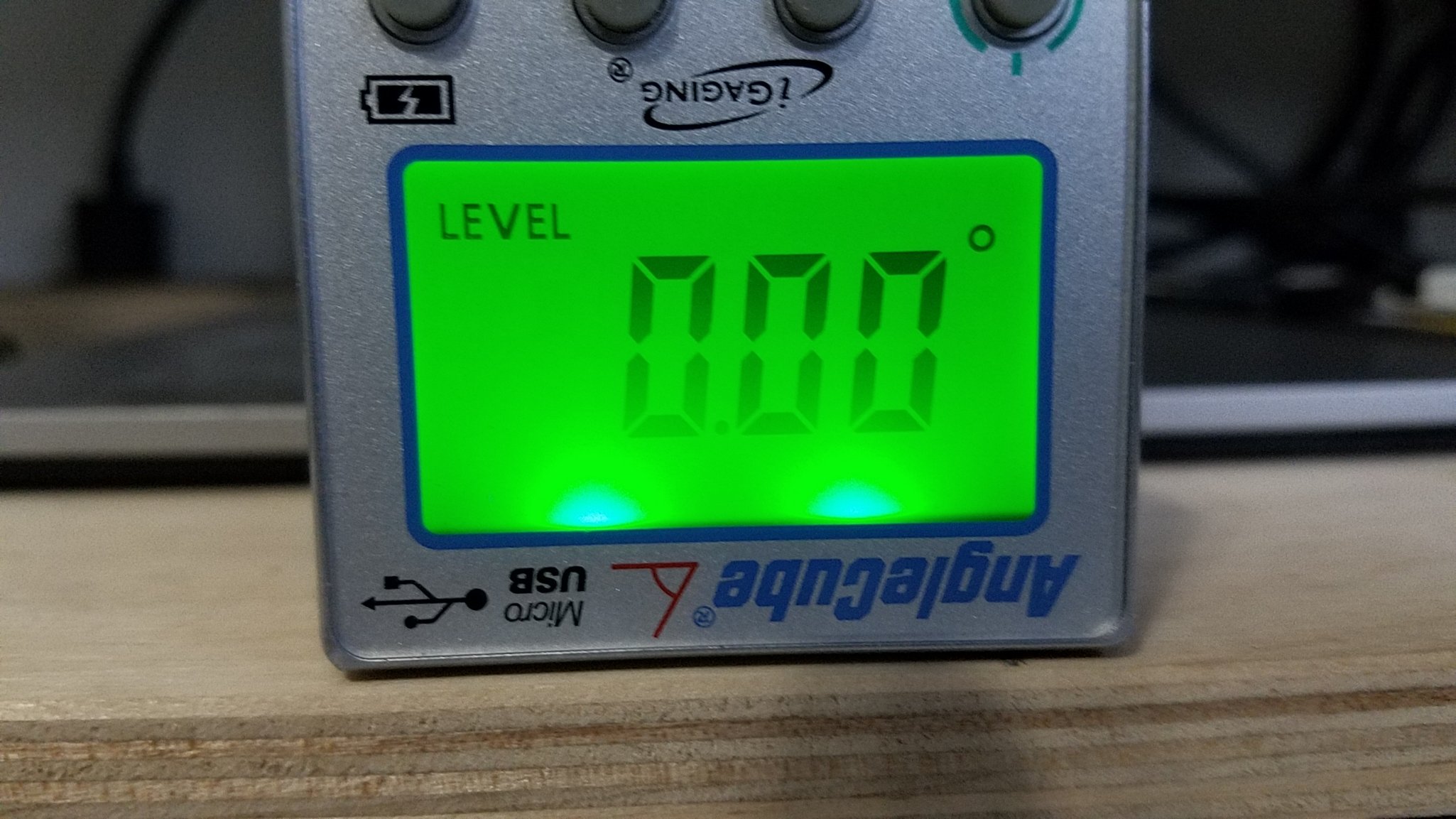

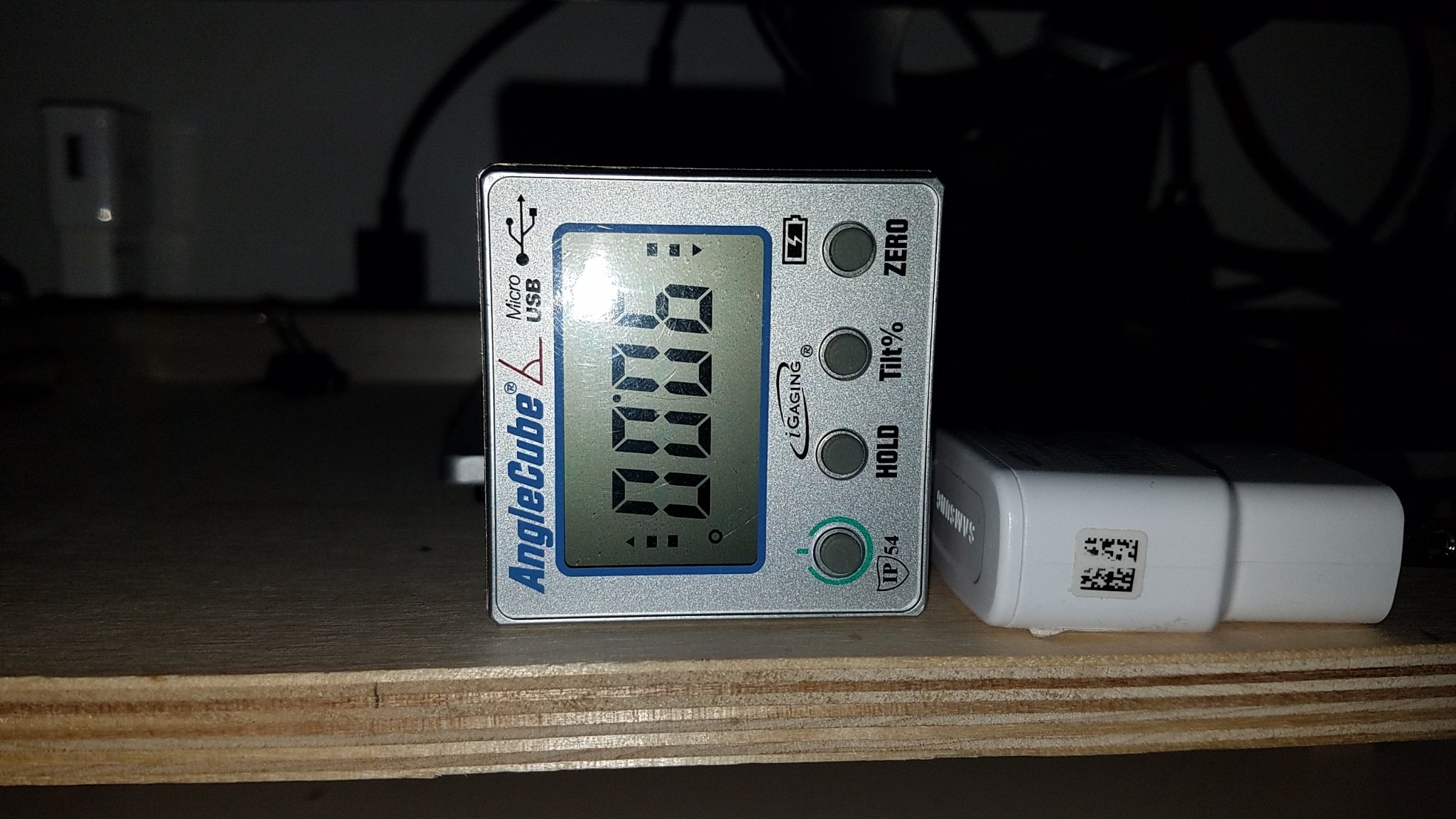

A full rotation to the right (clockwise)
Zeroed Here
Zeroed Here
90 degrees off starting position
More than 90 off starting position
More than 90 Less than 180 off starting Position
180 off starting position
Back to Starting Position (360 degree rotation).

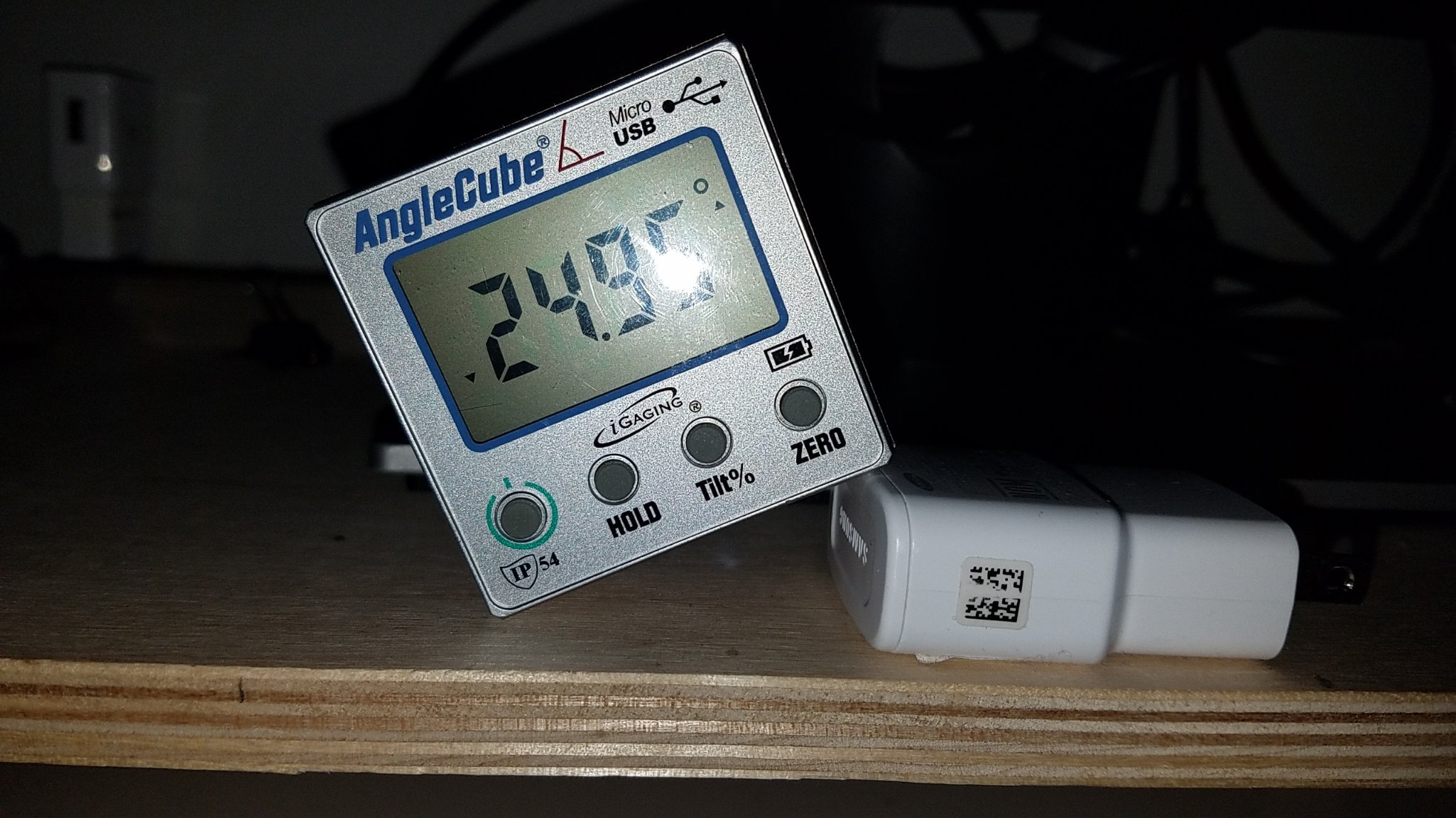

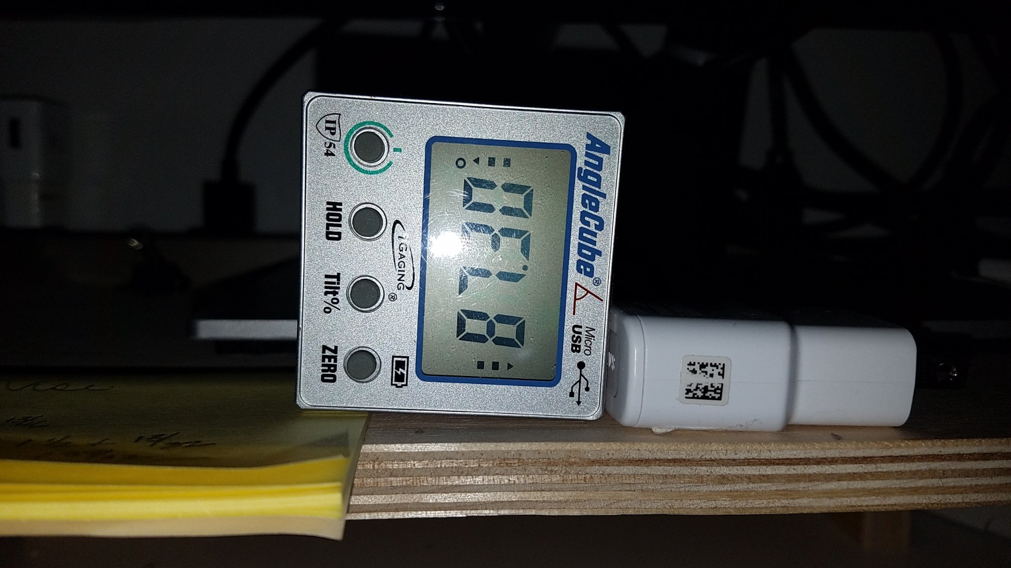

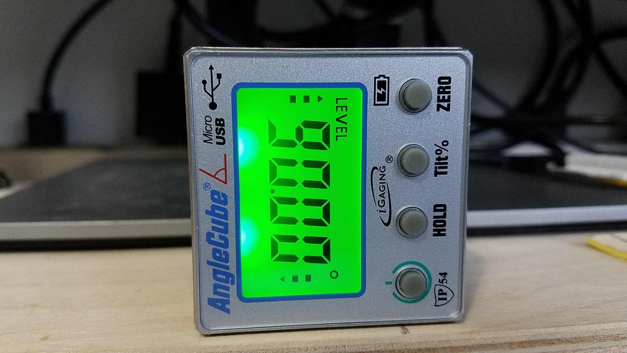

I have the original anglecube(no backlight, no %, no rechargable battery(uses 9v), no usb port(battery charge and data).
However I believe the screen symbols are the same(xx.xx°,up/down arrows AND the square symbols(0 to 2 on each side).
Some observations:
ONCE I got a level Zero reading with NO arrows.
A zero reading with arrows either direction is possible(very low deviation from "LEVEL").
As the cube is tilted from level the angles display value increases and the arrows indicate the high and low status of the respective bottom corner of the cube.
At 10.00° a square symbol appears at the 'fat' end of the arrows. An additional indication of high/low bottom corner of the cube.
At 70.00° a second square symbol appears.
As the cube is further rotated from level it will eventually indicate 90.00° The arrows and square symbols do not move.
Additional rotation(VERY small amount) will cause the 90.00° display to invert(become 'upside down' and is then to be read viewing the cube 'upside down'). The arrows and squares also 'flip', but are still indicating the same relative to the "bottom" of the cube corresponding to the bottom of the display(which has become the 'top' of the cube).
Additional rotation causes the angle display to decrement down from 90.00°.
At 69.95° the second square symbol disappears.
At 9.95° the single square symbol disappears.
And so on til the cube is rotated 180°(upside down(and the display reads correct in that inverted position).
Further rotation essentially repeats the steps above until the cube is again top up.
Now all this being ?informative? is "interesting?, but this cube had magnets on three sides(left,bottom,right) and thus all this tilted 90° becomes moot.
One can simply attach the cube right side up to a vertical surface and read angular rotation from the reference directly(keep in mind the displacement can be CW OR CCW. The arrows will tell thee which way.
