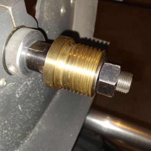

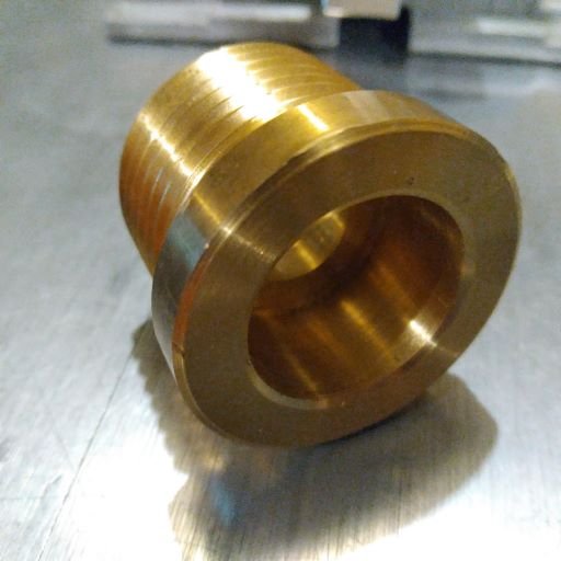

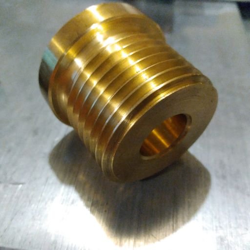

Re: Shopsmith Teknatool Chuck Adapters
Post by miken »
reible wrote: Fri Sep 10, 2021 7:22 pm The shopsmith adapter will also have the angled set screw . . . .
I decided to go a different way than peterm when he machined his adapters. Instead of making the adapter with the set screw mount for the SS spindle built in, I made mine so it fits onto the 5/8" Universal Arbor. I was limited on material with enough diameter to cut the 1 1/2"x8tpi threads, thus brass, and the different design. It works well with less than 1/128" of runout, around 0.008". It works with my chucks and the arbor stays within the chuck, but it won't work with a faceplate unless I counterbore a hole in the wood for the arbor nut clearance. It was a good learning experience, but I doubt I will use it much as I think the Nova chuck is a much better option. Anyway, just thought I would share.
Thanks, Mike -
