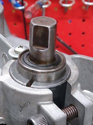

Decreasing speed puts some outward pressure on the Idler parts, and the idea is to keep everything except the control sheave in place. On most Marks, there is a screw and washer that go into the headstock casting just above the eccentric bushing. Its purpose is to keep the bushing in place. On newer Marks, or those that have had the eccentric bushing (not necessarily the bearing) replaced with the split eccentric, there is a second screw that goes into the eccentric that similarly keeps the bearing from going too far outboard. The split eccentric is mandatory with the new Idler from Shopsmith, identifiable by two separate bearings rather than the one long 'water pump' bearing. Some owners use a larger OD washer on the first screw to limit the travel of both the eccentric and bearing. I presume you don't have both screws based on your symptoms, but please describe what you have.

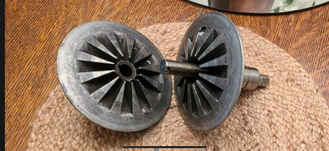

Excellent analysis on minimal data, David; all great suggestions. I believe another possible cause for the belt to be binding in the idler sheaves is the mis-adjustment of the high speed setting. I know mine was chewing up the belt due to being pinched between the sheaves as I tried to decrease the speed. If the high speed setting is too high the sheaves will get too wide and the belt drops down too far where it gets caught on the bottom of the vanes. If the belt gets hung up on the vanes it makes the spindle is harder to turn, and you can hear and feel the belt grinding as it tries to work its way up out of the bottom of the sheaves.
Photo below shows the vanes on the inside of the idler sheaves, and you can see how they will bind and chew up the belt if it gets below the bottom of those vanes.

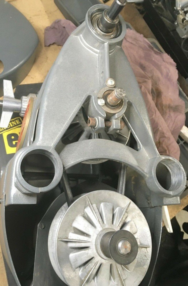

Below is a picture to help with David's description of a possible problem with the eccentric and Idler Shaft Assembly. Also consider Marc's concern about pinching the belt.
_

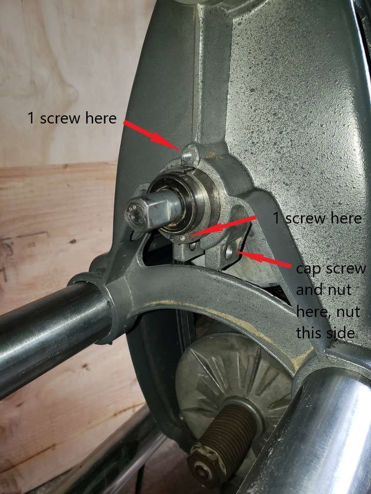

In the picture above the location of where screws go are indicated. None of the screws, washers or the nut are shown in the picture. The picture above has the Idler Bearing and Eccentric pushed out but they will be flush with the casting against the screws when properly aligned as shown in the picture below. The picture below shows the screws, washers and nut in place. It is these hardware parts that hold the Idler Shaft Assembly in place in correct alignment while the sheave is moved in and out on the Idler Shaft. Do note there has been variances over the years as to what hardware has been included there to hold the Idler Shaft Assembly in place. Most older headstocks with the water pump bearing without the split eccentric have a set screw through the eccentric to hold it onto that bearing. Early Greenie Headstocks had other parts to hold the assembly in place.
_

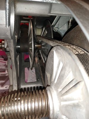

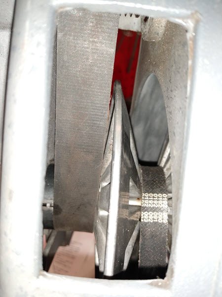

Thank you to all who responded. It really helps. Pictures here. The good news is that I looked inside the case real good to make sure there was nothing loose or broken. Everything looks ok. I did oil the idler shaft before assembly and slid the second sheave back and forth several times to make sure it moved easily. I'm still having to turn the spindle assembly at the front and back with both hands. It sure seems like it should turn much more easily than that. With everything so tight, I'm afraid to plug it in and turn it on. I've adjusted the eccentric bearing until the poly v has 1/8" deflection.
idler shaft.jpg (27.28 KiB) Viewed 5394 times
Re: Idler shaft moving around
First thing I noticed is the poly-v belt is NOT on the drive sleeve pulley correctly. It is two(?) grooves too far to the 'rear'. The pulley has 13 grooves. The belt has 9 ribs. Center it.
