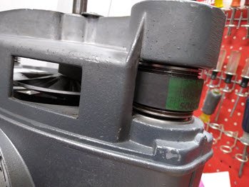

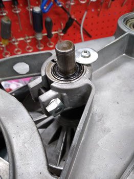

A Poly-V belt is way too loose if it can shift grooves on the pulley. The pictures only show one side of the eccentric so can't tell if there would be a set screw, but not sure if that would apply to that eccentric. He can use a larger washer to hold both the eccentric and the bearing in place.
coldje, is the eccentric bushing moving also or just the bearing? If the eccentric isn't moving then the clamp is tight enough. If your eccentric isn't tapped for a screw to hold a retaining washer (doesn't look like it the picture) then try a larger washer on the top where you have one retaining the eccentric already.
I wouldn't recommend tightening the clamp, it may not tighten the eccentric at all while the slot is near the 9 o'clock position. If the eccentric can be rotated very easily within the housing perhaps the clamp does need some tightening with the eccentric slot rotated to the 6 o'clock position, but that has to be done with great care. A crack in that clamp is probably irrecoverable.

coldje,
Thanks for posting pictures. The last one tells me the Idler Shaft is protruding out beyond the eccentric which it should not. The eccentric appears to be the type that does not have the retaining screw as shown in my pictures. Eccentrics with a retaining screw also have a cut on the narrow side to allow clamping pressure to go through to the bearing from the headstock casting. Eccentrics with a set screw do not have the cut on the narrow side and the headstock casting only clamps the eccentric itself. Yours should have a set screw in the eccentric to "lock" the bearing to the eccentric. If it does not have a set screw in the eccentric it may be from the early Mark 5's which had neither a retaining screw or set screw and needs the Bearing Retainers used on the "Greenie" Mark 5 beginning in the 1950's.

Russ, I did replace the eccentric bearing on my headstock because it had a crack in it. The newer (used) eccentric bearing you see, is something I just put in. I thought I could use it on this headstock. Serial# 120962

Looking at the first pix, it seems you have the newer split eccentric so you do not have the set screw mentioned above.
You need the older version with the set screw or at least the retaining screw/washer.
Post a pix showing the entire outward facing side of the eccentric.

JPG wrote: Wed Oct 27, 2021 2:17 pm Looking at the first pix, it seems you have the newer split eccentric so you do not have the set screw mentioned above.
If you are handy with a drill and tap adding the screw and washer is easy. Whatever alloy the eccentric is made from it threads really easily. But it has to be a very small diameter screw. Personal opinion, I prefer the split eccentric but until now I've never seen one without the stop screw for the bearing. The screw in question is shown above in Russ's last picture at about the 8:30 position on his eccentric.

I think it's fixed. So I decided to install the old eccentric bearing even though it has a small crack in it. I think having that pointed set screw in the old eccentric bearing really helped to keep the idler shaft from moving around. I also installed a larger washer to retain the bearing and idler shaft as advised. Squeezing the drive belt together while turning the spindle assembly helped keep everything turning smoothly while dialing the speed control to Drum Sanding for a test. Tested, she sounds just like a Shopsmith. I have a few stickers to replace and then the headstock will go back on the way tubes. This thing was a mess when I got it in VA for $300. It had been stored in the rafters of a shop for some time.

Using the larger washer to keep the eccentric bushing and Idler bearing does pretty much the same as the normal use of the 2nd screw in the eccentric itself to keep them from pushing out.
Something to remember about the Idler Shaft assembly is the forces at play in the pulley system including the motor's pulley. The spring of the motor's pulley assembly wants to close the pulley and push the belt up out of the pulley to its limit. The Pulley Assembly of the Idler Shaft Assembly with the Speed Control Assembly closes the Idler Pulley Assembly forcing the motor pulley open against the spring. If the Idler Shaft Assembly including the Eccentric Bushing is not held correctly in place than it can move back and forth in the headstock casting when trying to change speeds. The force applied from the speed control to the Idler Pulley to close it can instead push the Idler Shaft Assembly out of the headstock casting instead of opening the motor pulley which is held closed by the spring. The "relaxed" position for the speed control components is in the high speed position when the motor spring is least compressed. This is also the reason it "feels" harder to lower the speed the closer you get to slow and maximum compression of the motor pulley spring. If the resistance going to slow speed increases it is usually an indication of needed maintenance, i.e. lubricating the Pulley Sheaves of both the Motor and Idler Shaft Assembly. If changing speeds in either direction gets harder that may indicate the need for cleaning, inspecting and dry lubrication of the worm gear and the teeth of the quadrant assembly aka "porkchop". These should both be done at the regular maintenance intervals.
