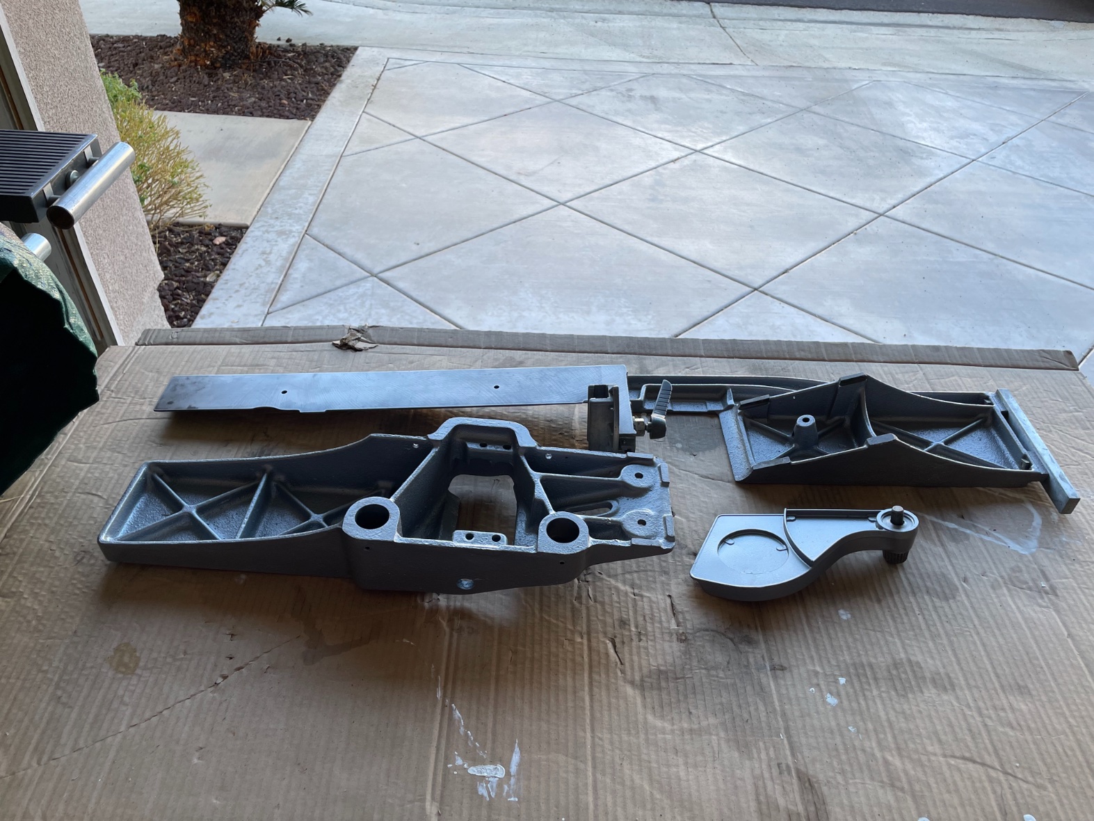

Here are some progress photos. I followed the cleaning, penetrol, waxing and painting procedures several of you recommended and this is how it turned out. Installed new bearings on the cutter head and sharpened the jointer knives. Marc Jones graciously let me borrow his bearing puller set and SS knife sharpening jig. I was careful not to get paint on the in-feed and out-feed sliding surfaces. Received the eccentric tube mounts from SS today. After adjusting the jointer knives I’ll be ready to make some test cuts. I definitely would have been lost during this restoration without all of your expert tips and recommendations. Thank you!

Very nice job Tony. That old jointer looks new, I’m sure you’ll enjoy using it. Can’t wait to see it mounted with some sawdust n it.

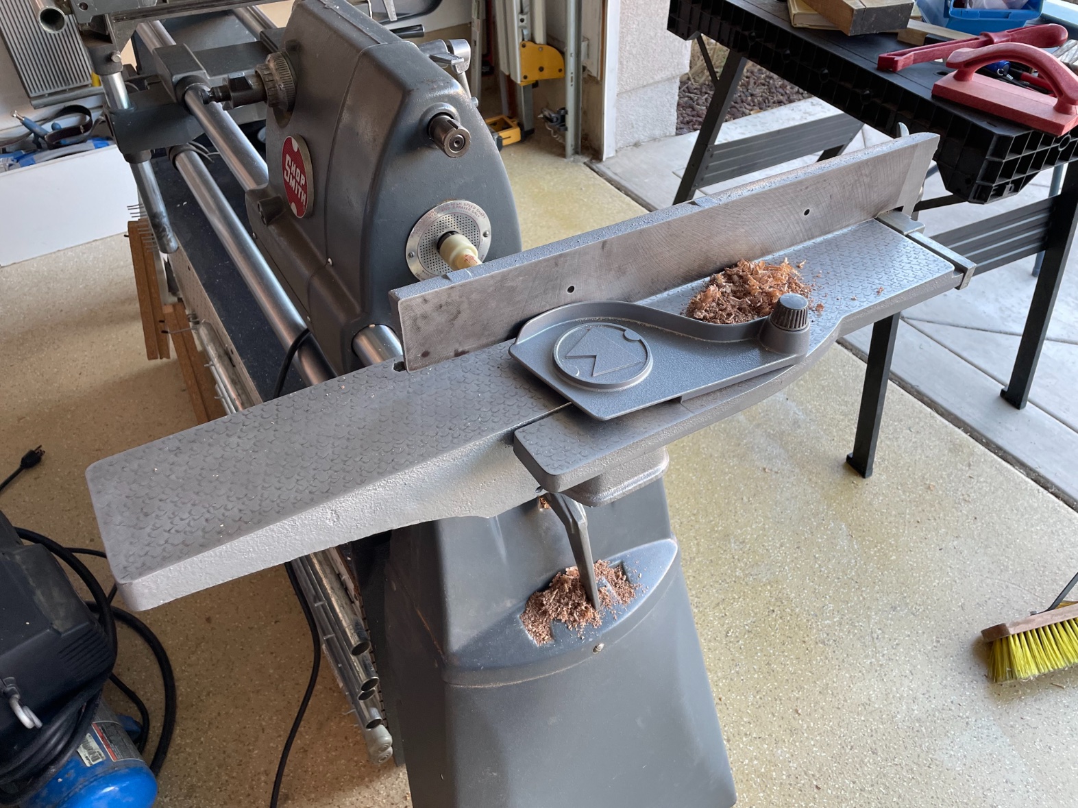

Here are a couple of pics showing the restored jointer. I made a couple of test cuts and obtained nice square cuts. I have about 1 1/4” snipe on the trailing edge of the test stock. From my review of the forum thread regarding snipe I must have the blades set too high. Will adjust accordingly and try again. I purchased the SS Jointer Retro-Kit , #555077. Got this new kit from an EBay seller and it includes a chip chute, shaft guard and rear cutter guard. The instructions come with templates and call for drilling and tapping small holes through the fence to attach the rear cutter guard and into the side of the outfeed table to attach the shaft guard. I’m curious to see if anyone has used this kit before and to determine if there are alternatives such as using JB Weld epoxy instead of drilling/ tapping holes for mounting screws. Any advice much appreciated. Thanks.

I love it, Tony, you've got the wood chips on the machine! It look great. Once I got everything completely adjusted I don't think I had any snipe on the few boards I ran through it, so it should be fixable.

I added the Dust Chute Retro-fit kit (555077) to my 1979 Jointer. I installed it by drilling and tapping the holes for the rear cutter guard and shaft guard. 2 holes for each and the dust chute holes are already there. Not a difficult job to do as long as you have the correct size drill bits and taps. The rear cutter guard is all metal and the dust chute and shaft guard are plastic.

Re: Jointer Cleanup and Repair
