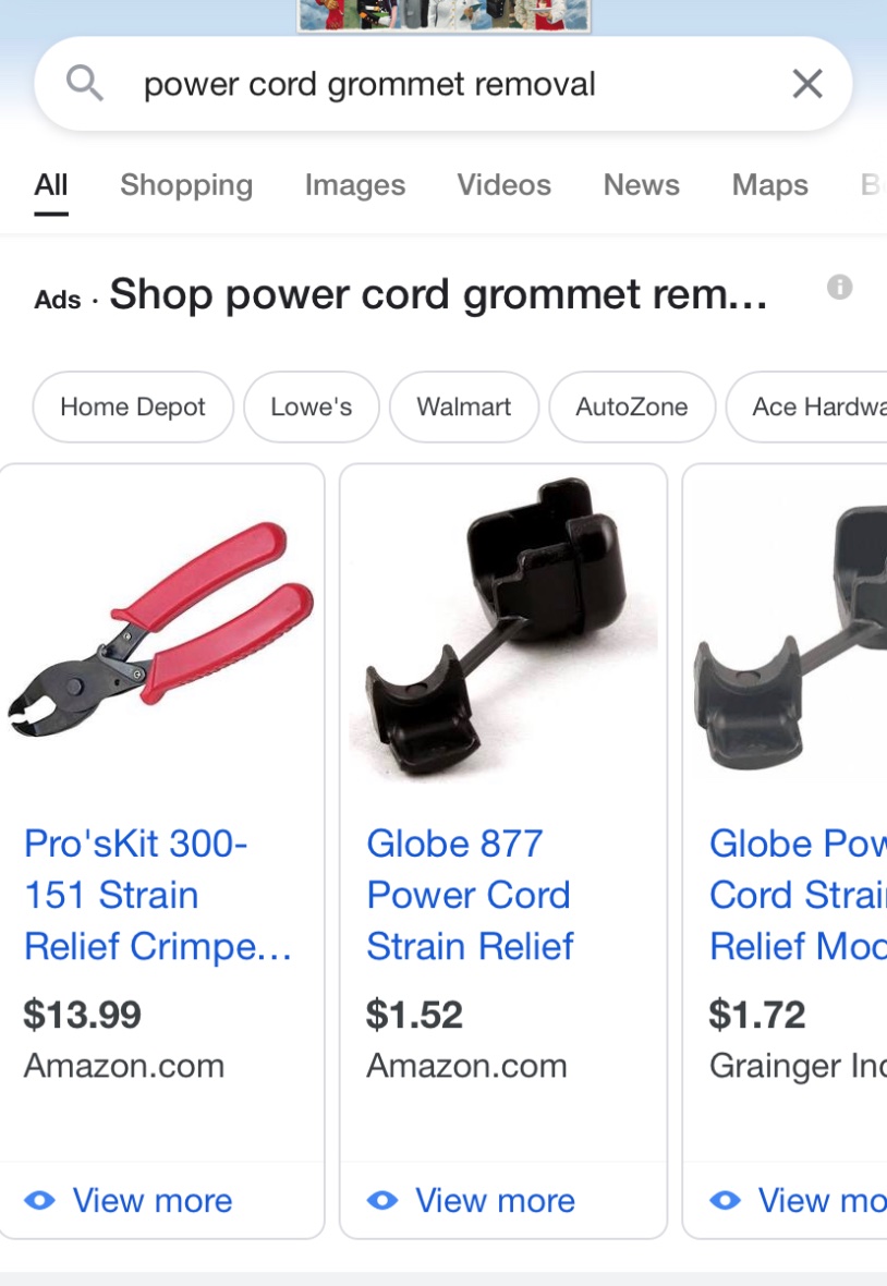

I’ve seen these types of strain relief bushings on all kinds of equipment, from table lamps to ShopSmiths, and they are all a real bear to remove… until you figure out the trick of using channel locks (or special pliers made for this, but who has those) to squeeze the locking tab on the inner side of the equipment.
They are inexpensive, and can be purchased from many places, including Amazon. I have included a link to the Hayco page that discusses hole sizes for different gauges of wire. Also see a screen grab of a good search for options. Like John said, they certainly don’t have to be Hayco.
https://www.heyco.com/Strain_Relief_Bus ... f_Bushings
