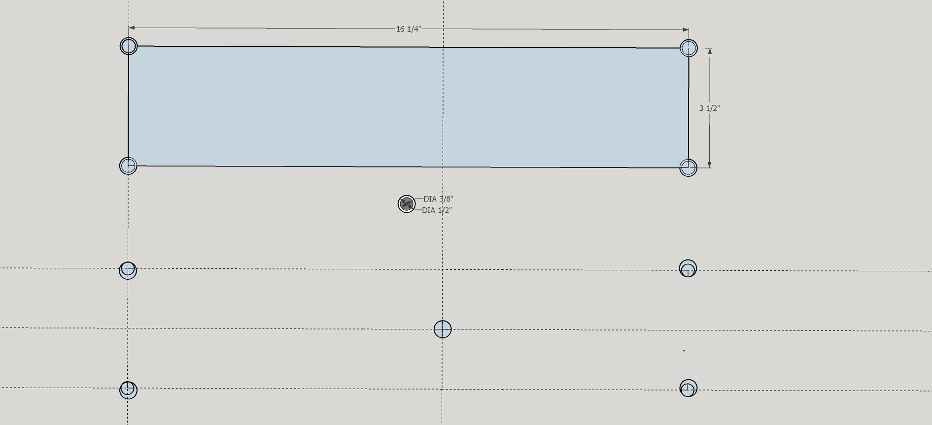

dusty wrote: Sat Nov 13, 2021 11:25 am
algale wrote: Sat Nov 13, 2021 10:26 am I still think the movement would be 1/16th in any any/all directions, not just due north, due south, due east, due west.
I think the dynamic that is not being taken into consideration is what happens at all four locations when something moves.
Oh, I'm taking it into consideration. I just may be wrong!
Re: I have wondered about this for some years now
Table moved 1/16" and rotated .45 degrees. Yes, ther maximum movement at any of the four holes is 1/16" If the table is simultaneous "rotated" the movement is slightly less. I think Ed's disclosure will be the same (1/16" in all directions about the axis of rotation). Like an eccentric with 1/16" offset.
A 1/8" dot.
AFour Trunnion Bolts and Holes with Movement.jpg (74.26 KiB) Viewed 786 times
DLB wrote: Sat Nov 13, 2021 9:03 am
dusty wrote: Sat Nov 13, 2021 8:42 am Is this not a math question?
The trunnion holes are 1/2" and the trunnion bolts are 3/8". Based on that, I would say that the table can be moved 1/16" in all directions; thus the maximum travel from one extreme to the other is 1/8".
Yes, there might be some vary slight deviations brought about by component tolerances but is that really going to be significant.
I agree. Deviation up or down from that value could have multiple causes, but that's the nominal.
I'm scratching my head about the earlier Nick post. I've seen a couple of Marks with undersized holes and IIRC it is one specific hole on one specific trunnion.(?) And I always believed it to be deliberate, kind of acting as a hinge point for aligning the table. Sometimes unsuccessful, but deliberate. With two undersized holes the table would be essentially un-adjustable.
The rear trunnions are the ones I redrilled and I redrilled both holes. I think that was the jest of Nick's post (not just one hole). May be wrong.
- David

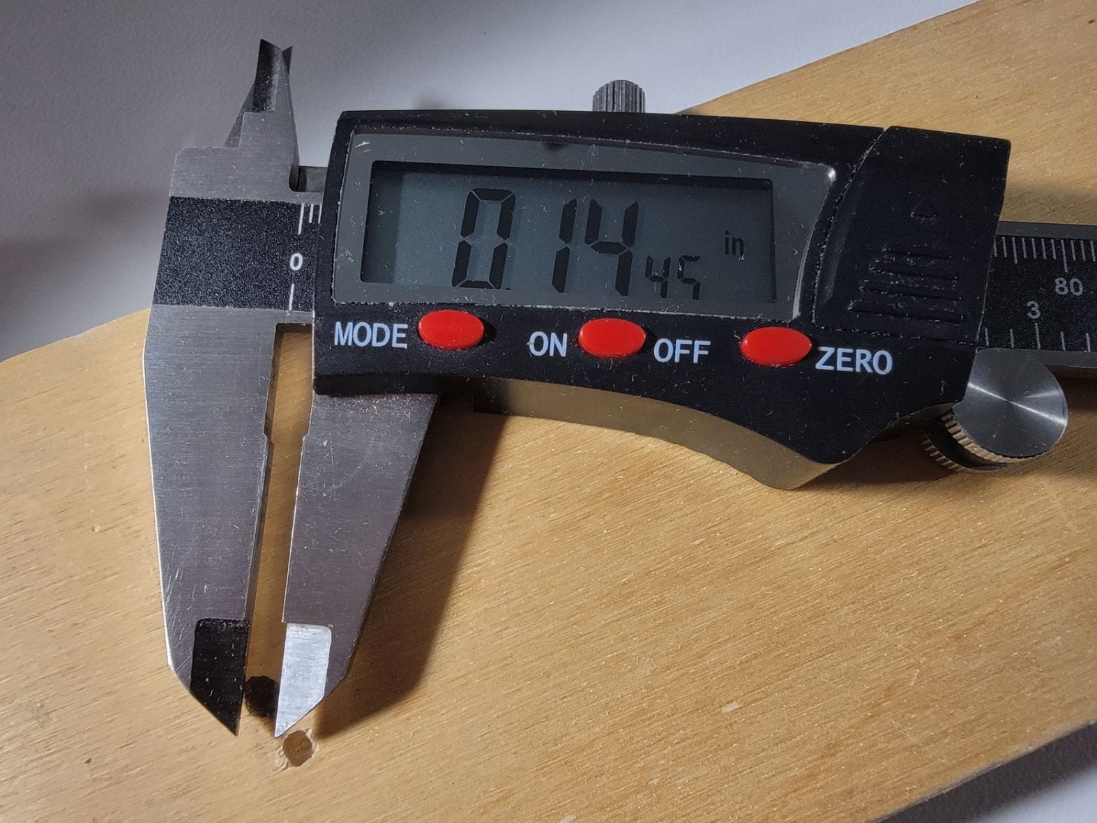

I am having trouble with pictures taken with my new Smartphone. Thet are rejected because they are too large.
Until I figure this out it will have to suffice to say "Ed's Image has been confirmed"; my dot is approximately 1/8".
The Dotv.jpg (345.03 KiB) Viewed 645 times
Please ignore the unwanted hole at the tip of the calipers.
It now occurs to me that the diameter of the dot is equal to the distance between the bolt (3/8") and the trunnion hole (1/2"). This had me puzzled big time.
