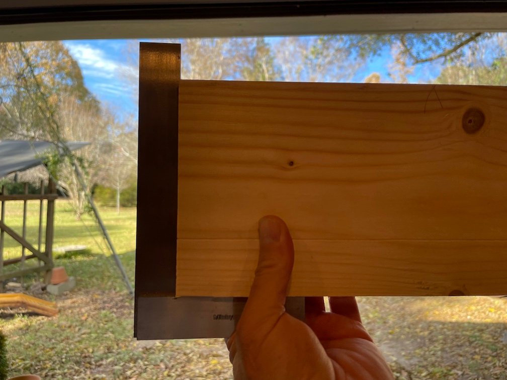

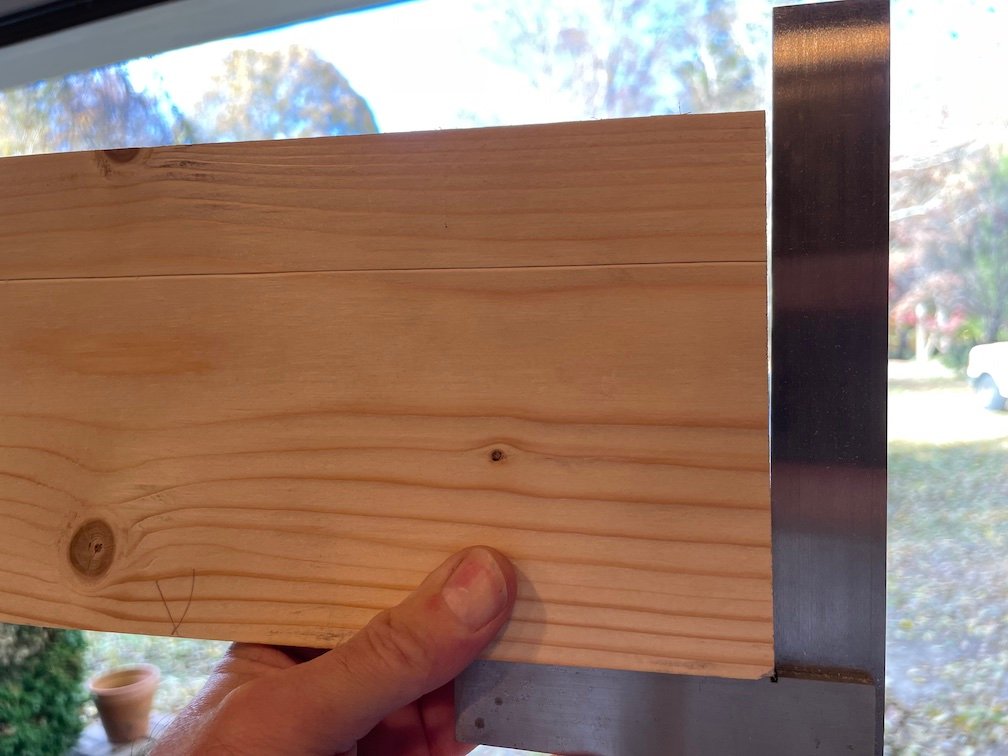

And the answer is.......
Operator error! There is flex in the table but clamping it to the aux table didn't help. The new blade (whilst making a MUCH better cut) didn't help either.
But what I found was that in my effort to ensure that the piece stayed hard against the miter gauge face, I must have unconsciously been putting torque on the miter gauge. Even though everything is tight and there's very little slop in the bar/slot interface, there does seem to be some flex in the gauge. I must have unconsciously been putting counterclockwise torque on the miter gauge when in the right side miter slot, and clockwise torque when in the left. Adjusting nothing, if I consciously put counterclockwise torque when in the left slot, it cuts absolutely true. And it doesn't take much....
For the record, here's what I was seeing BEFORE:
