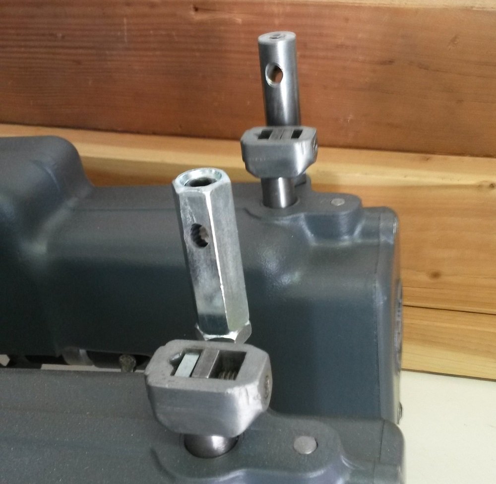

You can use it without the support but if you want one, I fabricated one out of thread stock and a hex threaded coupler. Those couplers that are like an extremely long nut. It is shown in the foreground in the picture below.
_
11 100 4 and 5c.jpg (102.52 KiB) Viewed 1284 times
It did help having an OEM one to "copy" when I made it. The hole for the Blade Guide (134-41) angles up at about 50 degrees. The post overall is 3" long with 13/16" of thread area and 2-3/16" long for the 5/8" diameter shaft. On the one I made there is an extra jam nut up against the all-thread nut to lock it in place (seen in the picture) besides the jam nut against the lower main frame to lock it.
