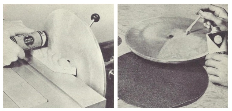

The stick adhesive was called Distic. It melted with heat.
Distic Application.jpg (77.5 KiB) Viewed 9315 times
Back in the day, one would hold a piece of soft wood against the disk as it turned creating sufficient friction and heat to apply the Distic. It was a form of a shellac and using the wood to assist spreading it evenly across the sanding disc allowed it to get it even as you worked from the outside to the center.
One would then push the carriage away, and apply the abrasive sheet in place while it was still warm. It helped if you would take the abrasive beforehand and place it abrasive side down between two sheets of plywood and place weights on top to keep it very flat. It went on easier.
The Distic (shellac) could be removed with alcohol or another solvent.
The Liquid adhesive was painted onto the sanding disc as evenly as one could apply it. It could be removed by rubbing it off with your fingers.
Allowing the disc to sit in full sun, or in a 300° oven for 10 minutes would generally help soften aged adhesive with abrasives left on for years allowing the abrasive to be peeled away.
Best practice was not to leave any of the older adhesives on the disc before applying new adhesives.
Today those adhesives are available in spray cans, or based on Shopsmith’s advertising today: “Shopsmith's Velcro® Disc Sanding System provides a cushion for cooler, more efficient sanding. It lets you change sandpaper discs from grit-to-grit in seconds.”
