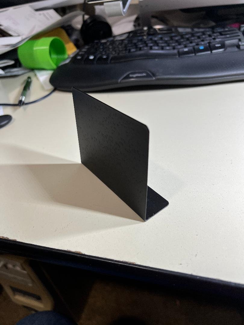

They will come with a metal place card piece like this:
Anyway the work is done and with days to spare.

Also had to get more of the place card stands. Questionable finish on some of them and only had a dozen to start with. So got two more packs which took care of the 7 more I needed and gave me all nice ones. Not sure what to do with the rest, could sand and repaint???
