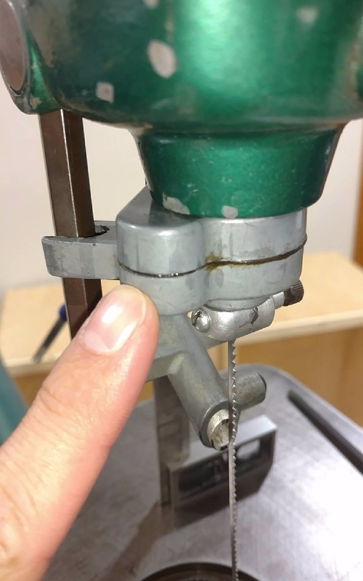

Sorry I'm late to the party. I'm thinking I should make a detailed write-up on this subject with pictures and performance measurement before and after. Yes, there are two tiny nylon balls that are inside the cast aluminium parts that are held together at the bottom of the 1" tube. They form a one way check valve during normal operation. The one I disassembled was completely fouled up and everywhere from the intake side through the assembly to the exhaust side was packed with dries out grease/oil and stuff..
After you find the metal pin near the cast pieces carefully use a punch to drive it out and slide out the assembly. The two pieces will be stuck together with the leather washer between them. The nylon balls WILL try and escape if you are not careful at this step. I ended up taking some time and flattening these mating surfaces and filling the chip outs and casting flaws before making a new gasket and reassembling everything after a very thorough cleaning.
I hope this picture makes it in. This is the assembly where the nylon balls are inside. You should see one of them clearly at the intake port.

Looking forward to the pictures. When I carefully separated the halves I couldn’t find any trace of balls or spring.

No springs - only back pressure and gravity.( I may have mispoke here!!!)
Also I now much think larger than a BB.(5/16"?)
