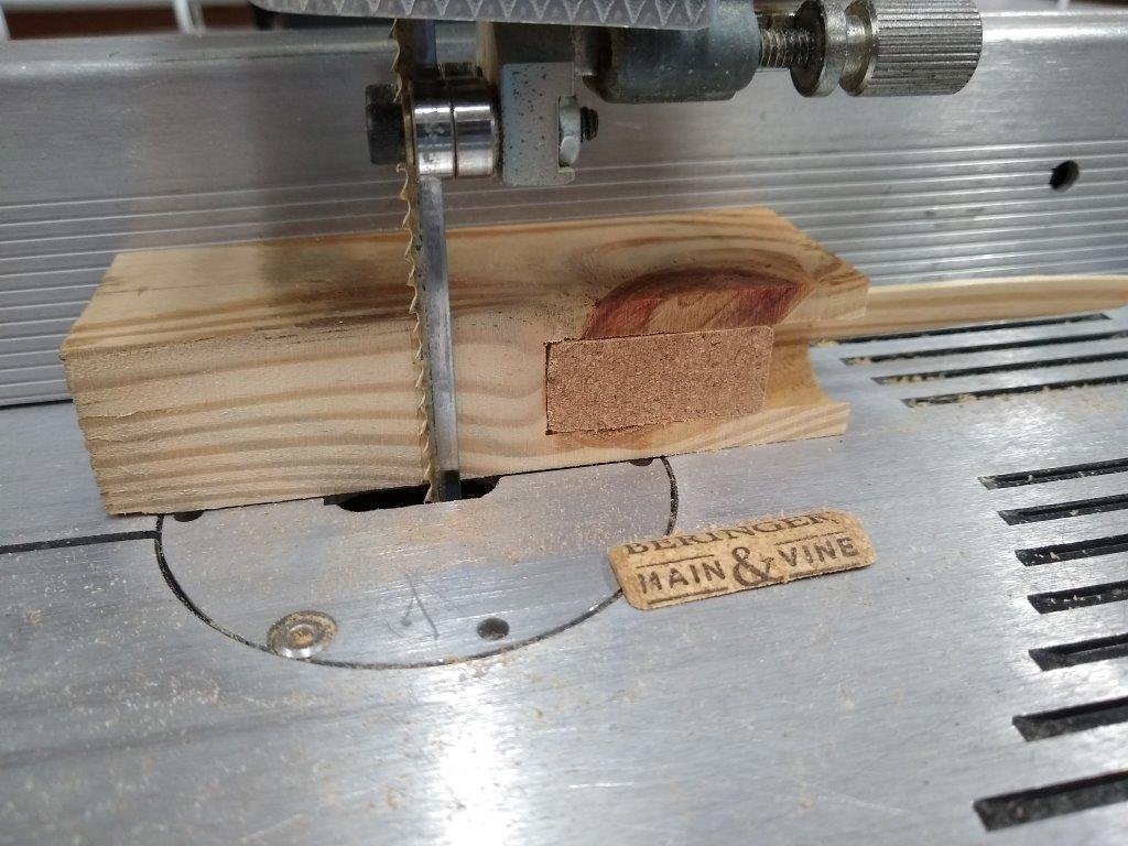

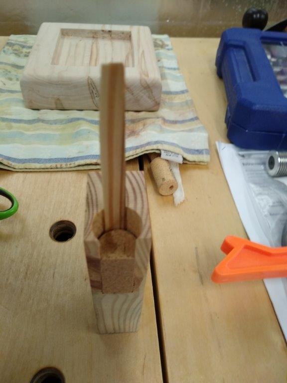

Here is the fixture- with an inserted stick-it pushes the cork flat against the hole created by a forstner bit-that was then slit open on one side with the bandsaw. The protruded cork could then be sliced off easily by guiding along the bandsaw fence.
Running this against the bandsaw fence allowed for flat slices to be removed from the corks without the cork spinning during the cut.
