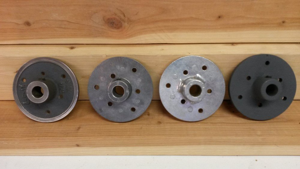

Both of your faceplates are likely Shopsmith ones. Over the years the Lathe Faceplates, both 3-3/4" and 6" have changed from cast iron to aluminum and back to cast iron. Below is a picture of the different 3-3/4" Lathe Face Plates. the one on the left is a cast Iron faceplate from the Model 10's. The two in the middle are aluminum. The one on the right is back to cast iron and is the current one.
_
3 3-4 inch lathe faceplates.jpg (76.87 KiB) Viewed 4398 times

Hey Chapmanrus,
That is so helpful. I assumed the aluminum one was one I bought off ebay and wasn't official Shopsmith.
Now - that brings me back to wondering why it's not locking down on the spindle anymore.
