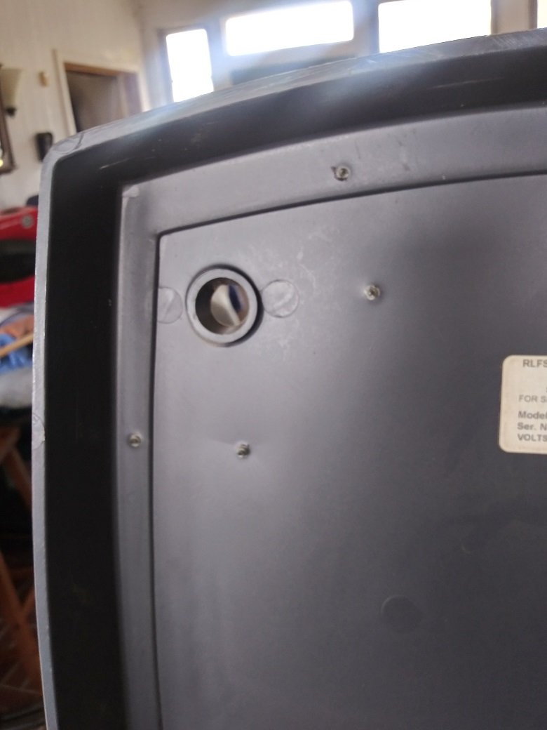

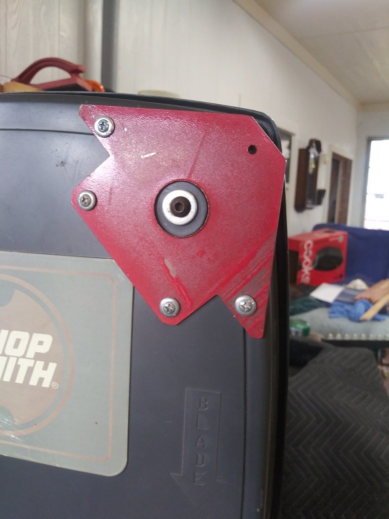

adrianpglover wrote: Thu Jan 06, 2022 7:52 am ... A piece of steel was secured to the upper right corner of the plastic cover, likely as an attachment point for a magnetic lamp...
I think I remember seeing this BS on CL when the guy was selling the M7. The thing in the corner of the cover looked like a magnetic 90 degree welding clamp. I kind of figured he had dropped it and cracked the cover. It didn't occur to me that it might be for a magnet. You should post a picture of this.
- David
Yep. That's the one. Looks like a red arrow pointing to the corner. Nothing at all wrong with the plastic itself though.

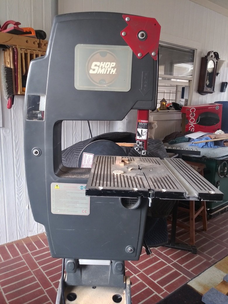

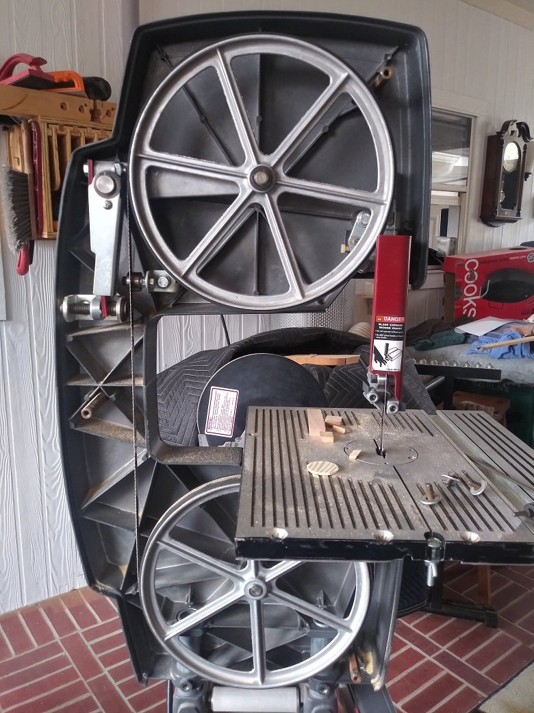

DLB wrote: Thu Jan 06, 2022 6:14 pm
- David
I just looked up the welding clamp that you mentioned and it does look like it's at least half of one. Here are some images of the bandsaw overall, the metal plate, and the inside of the cover where the plate is placed. I don't currently have a magnetic lamp to go here, but this would make it easy to add later. I did remove the auxiliary fence and plan to add it back on the rear side, but if it moves too much I may nix that idea and do something else instead. A prior owner had mounted the aux fence rail across the front by drilling holes through the table, mounting 1/2" angle iron, and then mounted the rail to the angle iron. However, to change blades you had to remove the fence rail.

Now that you mention it... IIRC in the CL ad there was evidence of both a Kreg fence rail and a SS fence rail. Which is unusual in itself. But I don't recall seeing either fence. I don't have a Kreg, but I think it mounts on the infeed end. The SS rail mounts on the outfeed end but the fence clamps on both, at least the version I have.
It looks like it is in otherwise great condition. It must have gotten separated from a bag o' parts somewhere along the line. The carriage bolt and wingnut that you remove for blade change is also a bit non-standard as far as I know, but probably functional. I preferred the knobs for holding the cover on but the screws are standard now. And a knob might interfere with the light mounting plate. ;)
