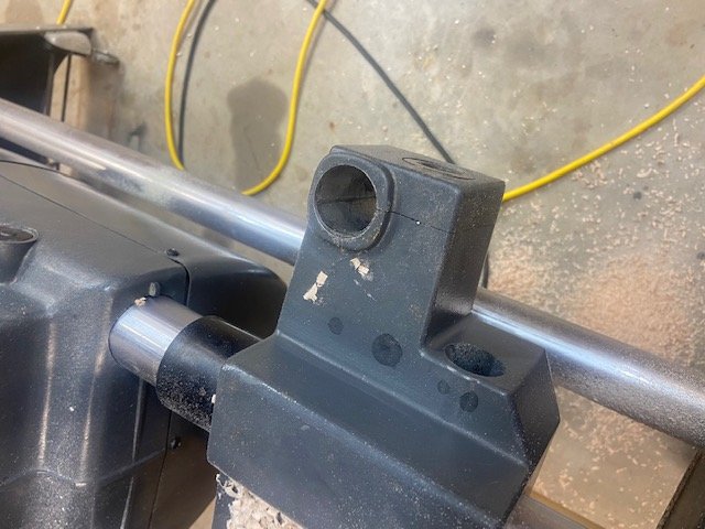

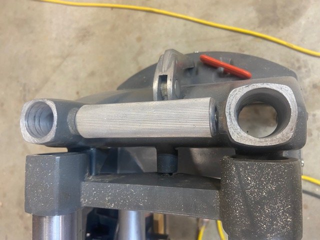

I have been working on cleaning/waxing/lubricating my 1998 Mk V. I think I've got the way tubes and all the table tubes good but I'm having trouble getting to the inside of the receiver on the headrest and carriage.
I'm reluctant to use something really abrasive and thus far I have been able to attach a piece of fine steel wool to a 1/4" spade bit on a cordless drill motor. The steel wool gets tangled in the spade bit and spins inside the cylinder but there is no real pressure to do any polishing. I haven't been successful in finding a drill attachment that will get in that space, provide a little outward pressure and a light abrasive.
I did try a small fine wire-wheel but it was a bit too wide in diameter to fit inside. I saw a YT video but I cannot find it now where someone used some sort of automotive tool for cleaning brake cylinders. I looked at that but it seemed pricey, possibly to wide and probably too abrasive.
I'm looking for suggestions, or is this whole idea overkill?
- IMG_6278.jpg (55.62 KiB) Viewed 7428 times
- IMG_6277.jpg (64.42 KiB) Viewed 7428 times

Don't know what you are after. I wrap a piece of very fine grit paper, 400 or higher, around a dowel and just give it a few go rounds. All that's needed is to clean it.

As good as your machine looks, I would do wax only first and see how it works. I would avoid abrasive unless needed. Some of the tubes are plated, so minimum abrasive to get the job done will give longest life. Getting inside some of the bores for wax on/off is tight, but worth it. Headrest way tube holes: only contact areas are near the ends, this should be easy with the headstock off the machine. Carriage and accessory table mount holes are a little harder, but if you wax the bores from both sides you should get good coverage. Hardest bore for me is the quill, even though it is a little bigger. It is just hard to reach the whole bearing surface.tfrayne wrote: Mon Jan 31, 2022 5:19 pm I have been working on cleaning/waxing/lubricating my 1998 Mk V. I think I've got the way tubes and all the table tubes good but I'm having trouble getting to the inside of the receiver on the headrest and carriage.

Actually, those look fairly clean, in that you can see bare metal. When mine get gunked up, they get a kind of "varnish" of polished wax and sawdust, but I don't see that on yours.
