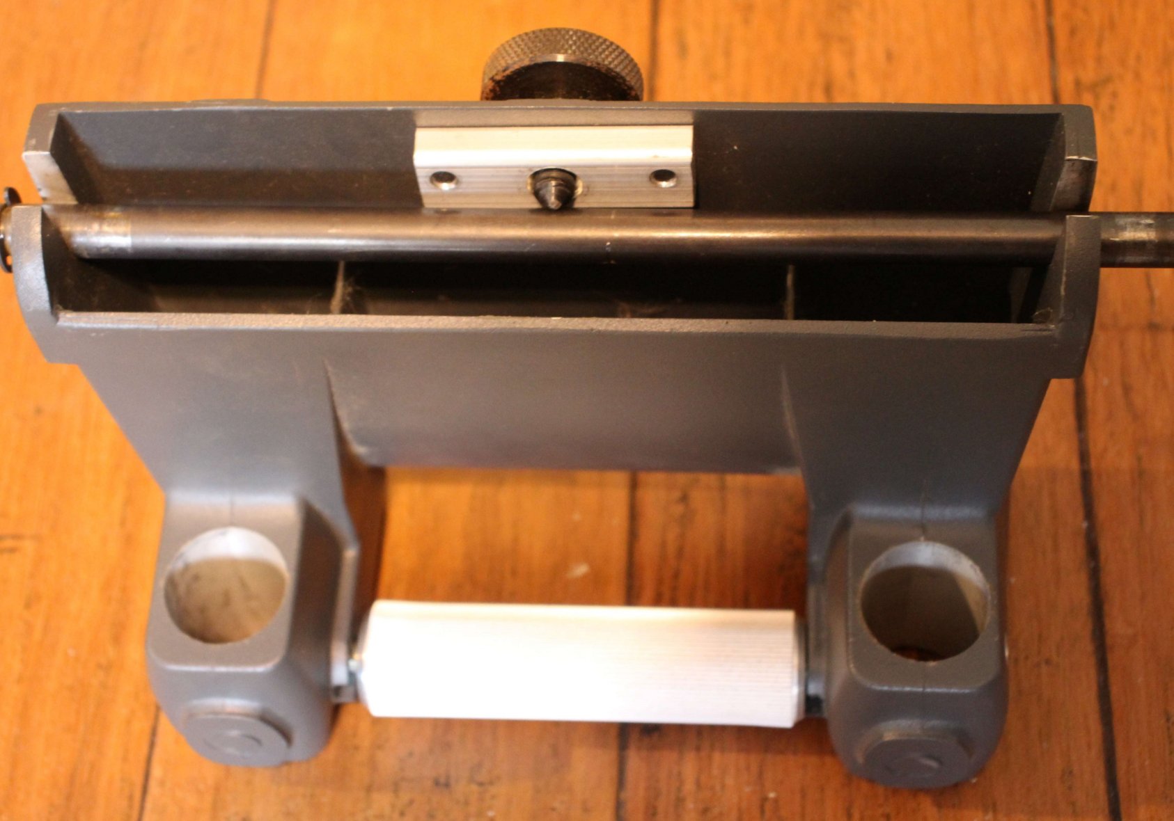

I did a bit of experimentation with no headstock involved so I could better control the outcome. I confirmed that I had not left the lock knob loose. Also that both the casting and hinge pin deflect as this is coming loose. Here is a pic of my DT Base Arm with a hinge pin for reference and shown upside down in the 'locked' position:
Things to note:
The aluminum bar that the lock screw threads into is unique to this configuration. In the picture I referenced in the other thread you can see that there are two visible machine screws, one of either side of the operating knob. There may be other features unique to this configuration, this one is visible externally.
Note that the end of the lock bolt is a cone or pointed shape and how it engages the hinge pin.
Referring to force directions as it is mounted: the angled interface here redirects the upward force of what I was doing into a left force acting on the casting and a right force acting on the hinge pin, in both cases deflecting them like compressing a spring. In the incident, the forces and deflections were sufficient for the lock bolt to pop over the hinge pin, freeing the base arm and everything attached to it.
- David
Things to note:

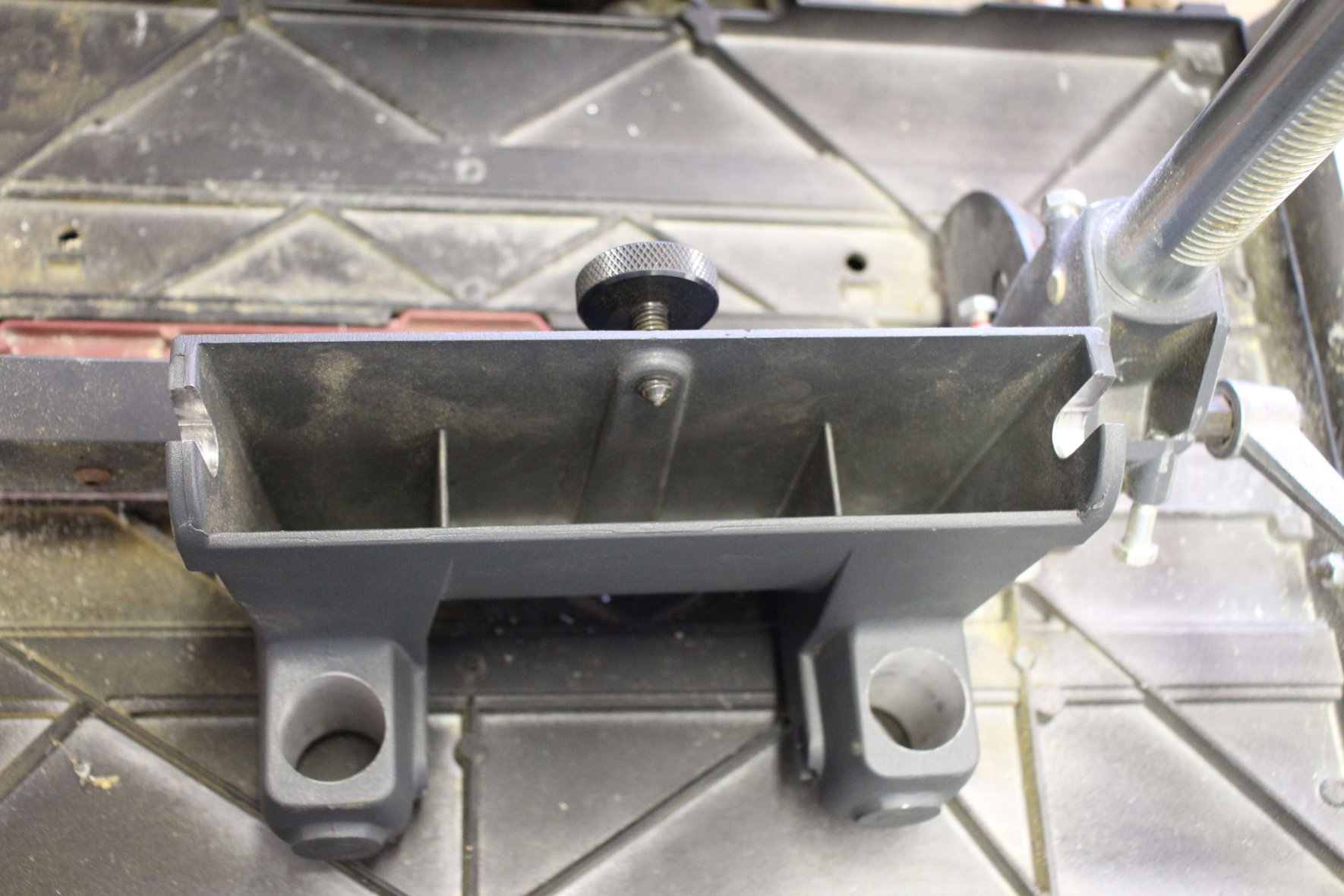

Mine is different but I don't see how therse changes could cause or prevent your incident. Casting is thicker around the bolt hole and lock bo;t may be different.

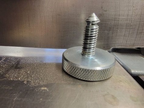

Thanks. It looks like the lock bolt is different only in material and/or coating. Mine is black oxide, yours appears to be stainless or plated. Both are double start thread and have that O-ring groove. Both have the cone/point implying similar engagement with the hinge pin. From your description it sounds like the casting is thicker for the threads, not for mechanical strength.(?) Mine is only around 1/8" thick on that wall, not enough for threads.dusty wrote: Wed Feb 16, 2022 4:13 pm 20220216_131434.jpgMine is different but I don't see how therse changes could cause or prevent your incident. Casting is thicker around the bolt hole and lock bo;t may be different.
My theory for now is that my version DT Base Arm is a factory reworked single tilt Base Arm, and that the more common version is made from a different casting. Reason for a reworked version is unknown, both older and newer DTs are different than mine. Both type locks would likely yield/release under force, but the amount of force needed might vary between them. And the force isn't typical, it is an upward force when the ways are horizontal so the only example that comes to mind is the operation I was doing, mounting a headstock with one end raised.
I have access to the other casting type, assuming there is only one. I'll have a look at that and report back. I think I can set up an experiment to compare strength of the casting wall, which directly relates to the amount of force that will cause the lock to release.

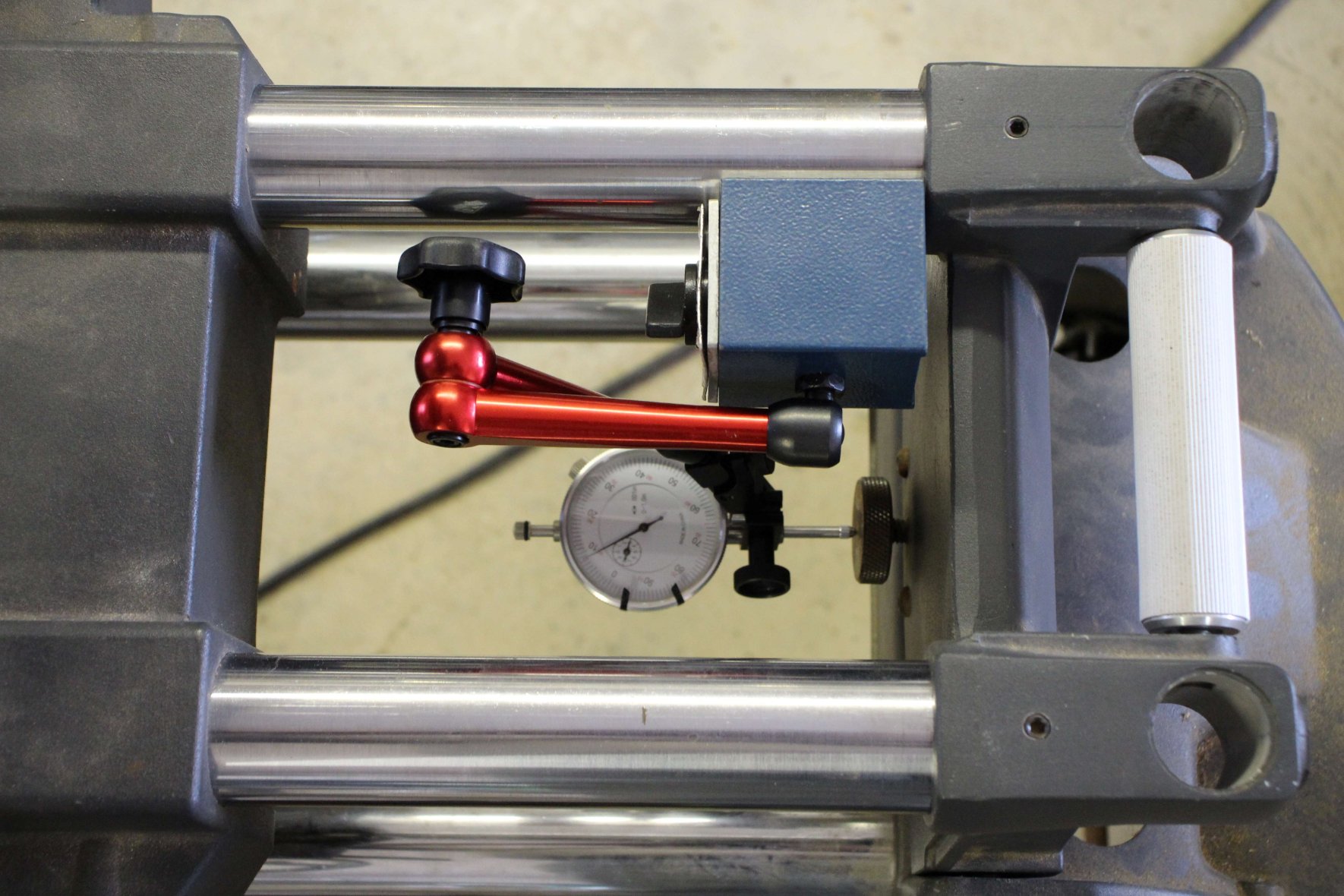

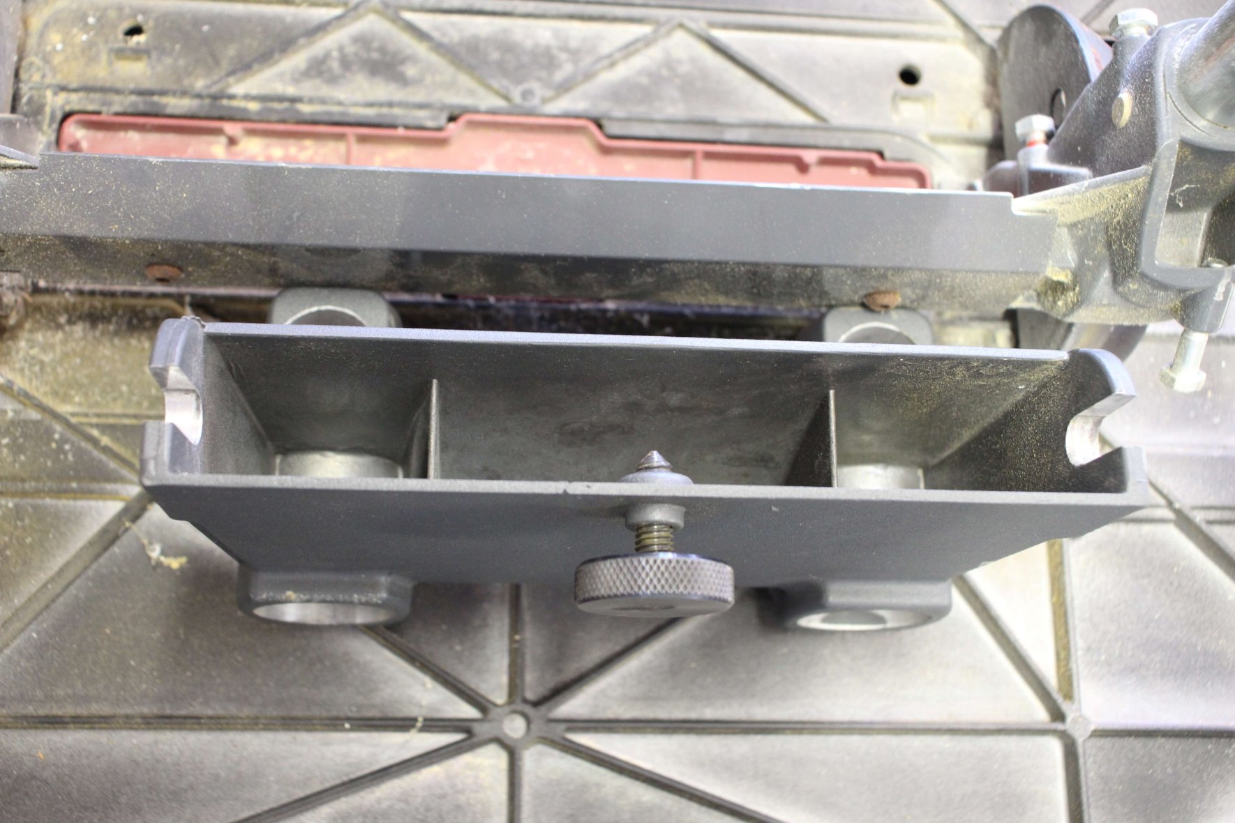

I set up to measure deflection of the castings as representative of the force acting to unlock the locking mechanism of two variants of DT Base Arm. The force involved deflects both the locking bolt (with casting) and the hinge pin, but it was impractical to measure hinge pin deflection. As shown, I measured locking bolt movement relative to the way tube:
I had the headstock about two inches from the left end and the carriage about 8" from the right, did not move either for the two test samples. My original DT Base Arm deflected 0.022" under this load. The other type Base Arm deflected 0.035" under the same load. It was difficult to get a good reading, but my estimate is 60 to 70 thou of deflection would disengage the lock and free the Base Arm and everything attached. Pictures attached of the second Base Arm I tested, and presume is representative of the majority:
Conclusion - If you compare the two types, original from earlier in the thread, you see that what re-enforcing there is on my original is horizontal while on the 'standard' version it is vertical. The DT Base Arms that I believe to be factory reworked single tilt Base Arms are more resistant to the force overcoming the lock than the cast version. Both versions are subject to the problem I described at the beginning of this thread.
- David
